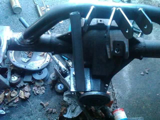

zapped a leg from the upper part of the claytons truss to the webbing on the side of the 8.8. 1.5x1.5x.25 box welded to a 3/8 plate secured with 3 7/16 bolts. don't think there'll be any rotating with this.
i would have liked to weld the tubes to the center section, but i don't have heat or a stick welder at my disposal. this will do.

welded the tubes to the center section.
por-15'd the whole thing
working on coating up the underside of the jeep now.

That support looks familiar.... good job.
