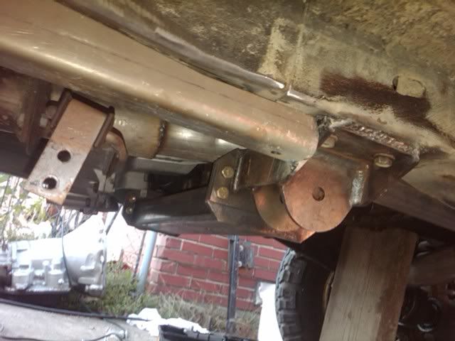

one side of the mounts is done, except for some clean up on the welds and paint.

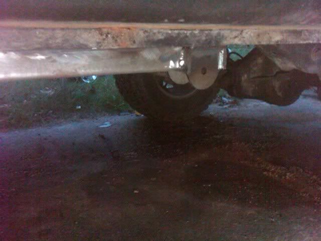

Did most of the pass side mounts. Got a couple more edges to weld in and the frame stiffener to stitch into it all.
Picking up a 231 this week for cheap. I want to get the tcase tucked higher than the 242 will go. Plus the sye's for the 31 are "better" in my opinion.
I think i'm going to go with high clearance lower control arm mounts in the front as well. Keep everything above the pumpkins.
This build is becoming a monster of a job. I'm just flying all over with it.
One other thing. I'll have to do something about my kor sliders, the clayton brackets interfere with their mounting points.

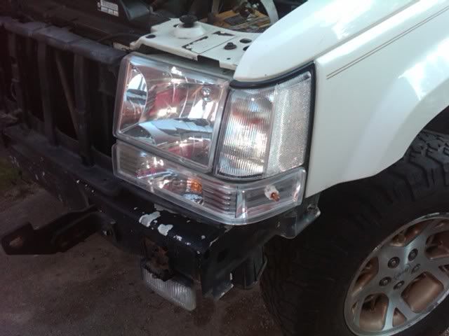

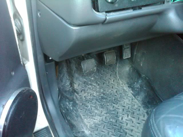

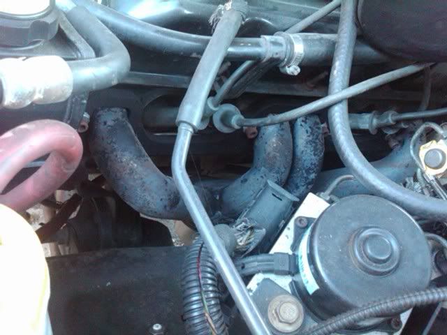

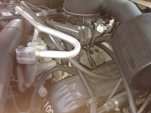

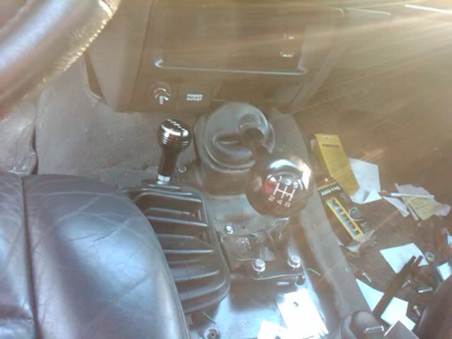

some pictures.
clear lights, they're bright as all get out with the silverstar ultras in them. the glare at light level is pretty harsh though,never realized it till i had them on pulling my other car into the driveway.
clearance of the dodge starter.
bottom of the headers.
y-pipe, i am not very satisfied with the build quality from the shop that was highly recommended to me.

the mess that is my interior, again.

I'd redo that Y pipe . . . doesn't look like it can flow that well with the downpipes meeting like that.
it can't. i can tell in the exhaust note how much turbulence it causes.
i have to redo the whole exhaust just about to work around the clayton's anyways.
