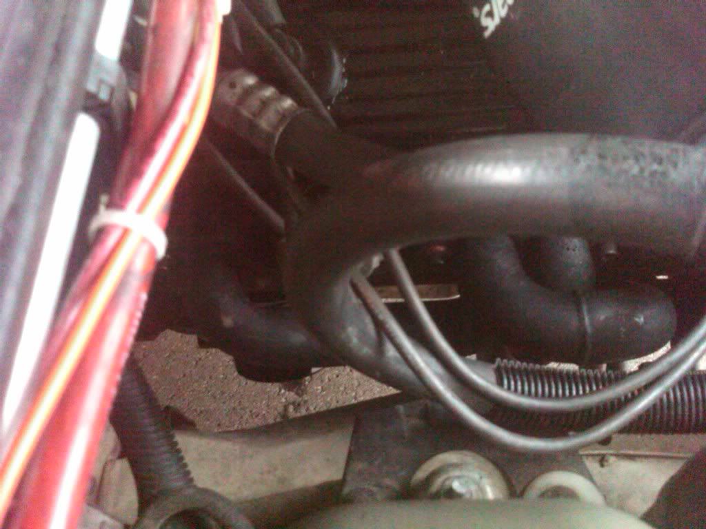

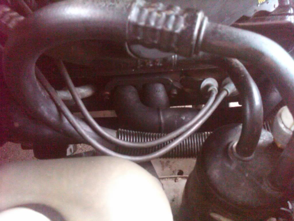

put the headers on today. hedman tight tubes fit very well, the y-pipe is going to be getting done tomorrow. should be an adventure for the shop to get it clearing everything under there.
the bolts hedman included are the wrong thread pitch for the heads for some reason, they appear to be metric.
from the top, driver's side
pass side

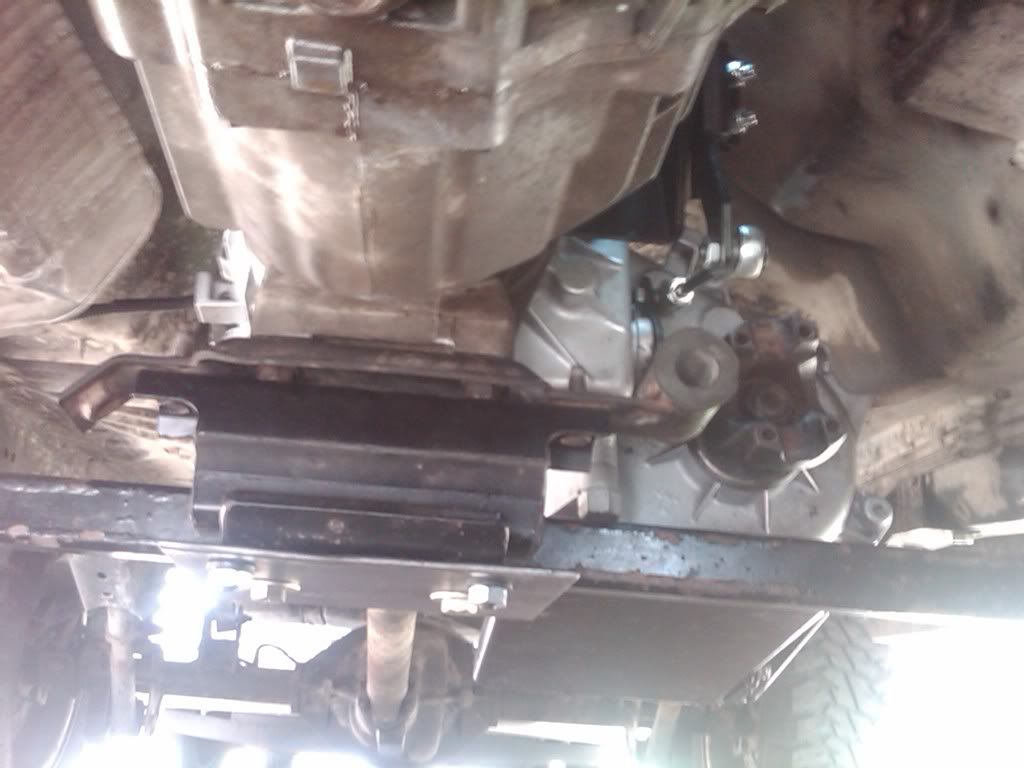

another shot of the trans mount.

the hedman headers have all the clearance in the world. it's the starter getting eaten by the driver's side upper control arm i'm worried about. saving for long arms after i get another back up car.
both headers slipped in from the top with little to no fussing, just had to take the oil filter off. now, you WILL need a different y-pipe using these headers, but for 280$ for the painted headers it's hard to beat.
