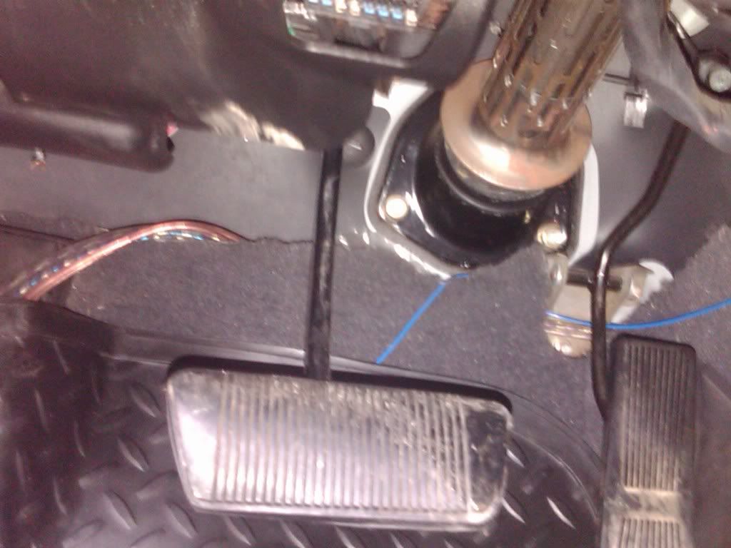

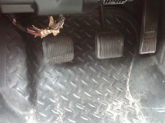

wow, there really aren't enough pedals in a zj. i mean, look at this.
this is more like it.

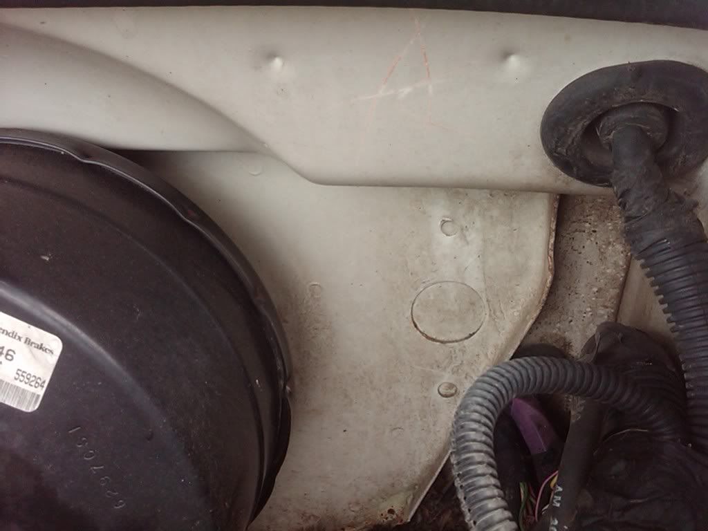

here's the knock outs you need to remove(drill through) in 96-98 zj's.
there's a bracket on the inside of the firewall that serves no purpose i can discern you'll have to remove. it's generously spot welded at the area you have to drill out so it's not too hard to get out. i needed a die grinder with cut off wheel to get it right. there's less wiring under the dash in an obdII zj than obdI, but there's a wire trunk in the way that will need a new route to get to the chime/security module and obd scanner port.

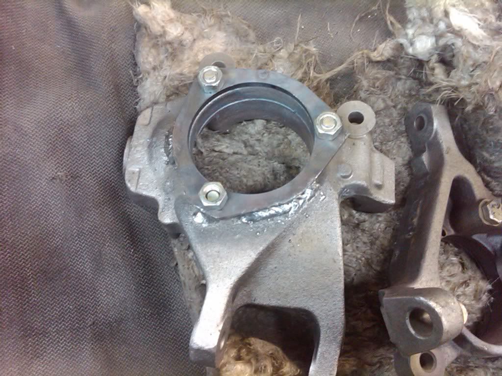

wj knuckles and spacers, sandblasted the knuckles clean.

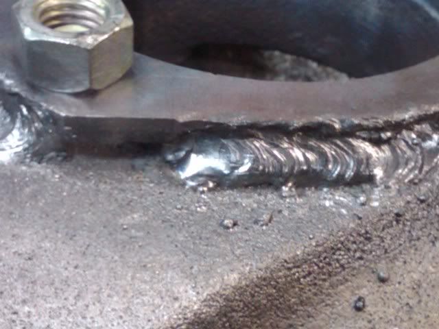

plates torqued to 75ftlbs, heated everything to 400*, zapped in place with what i thought was high nickel rod. turns our our die repair welder gave me hard face rod. oh well, welds have a rockwell of about 51 now. lmao.
not the prettiest, but solid.
let everything cool slowly in the blankets for 4hrs.

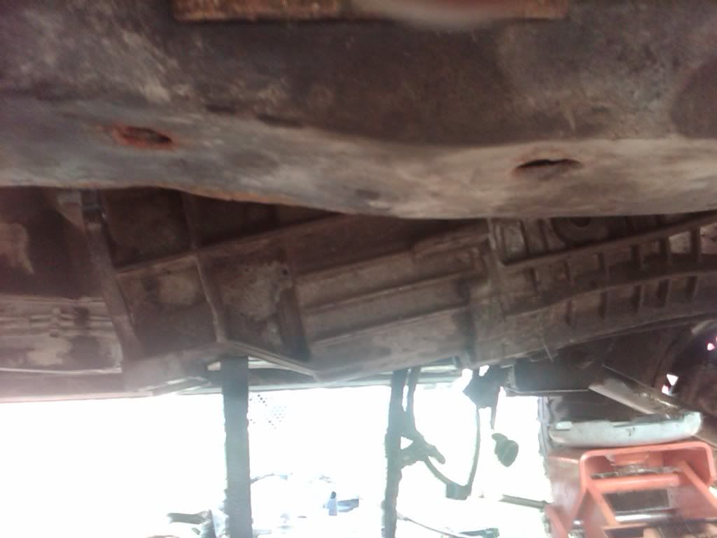

clearances are super tight for exhaust. thought i could use some dodge long tubes but 'tis not enough room. gonna need some block huggers that collect below the middle two exh ports, then a full custom y-pipe.

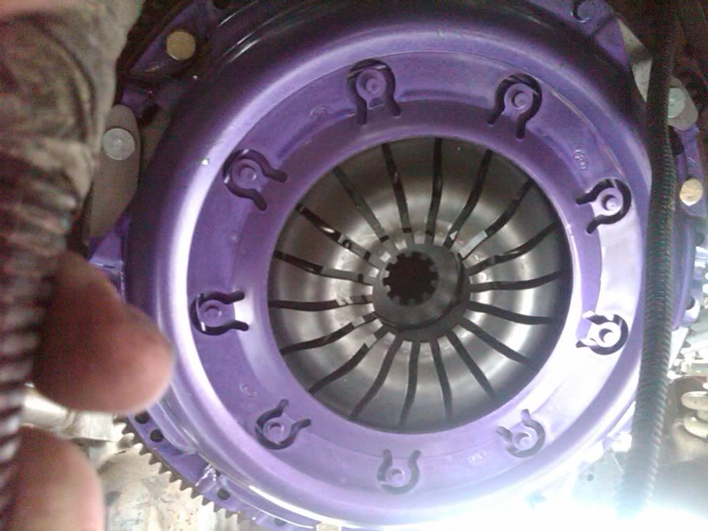

here's some photos, back of the crank with pilot bearing it. stock hole in the 318 was .980", had to drill it to 1.000". .020" is way too much for an interference fit. locked it in with some high strength metal locking compound to be sure(like loctite for press in items).
clutch in place. zoom kevlar(luk) clutch.
tranny bolted up and hangin a little low.

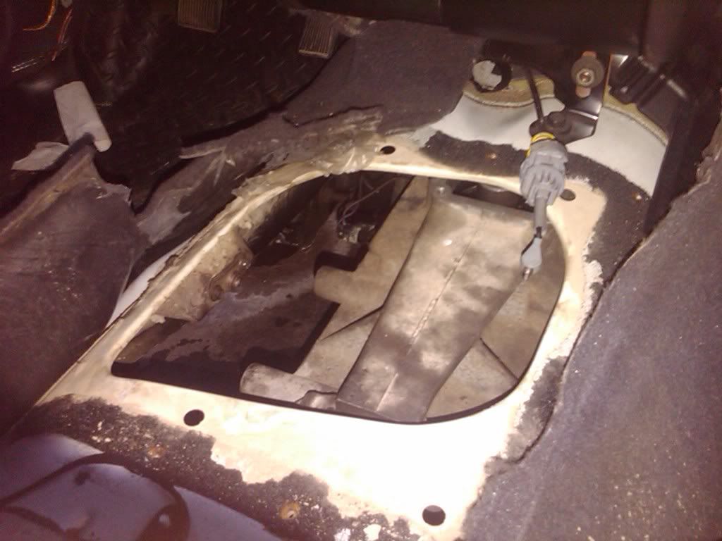

view from inside. going to need to section the tunnel a bit, may end up losing the ashtray and/or vic to fit a shifter. you can see the back tiniest bit of the mount for the shifter peeking through the tunnel hole.
on the bright side this gives me a nice area in the console to mount a cb and switch panel or anything else i'd like to have quick access to. maybe i'll just relocate the vic to there...

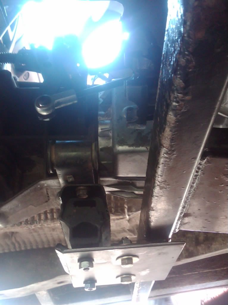

the dodge trans mount fits nearly exactly the same as the jeep mount. the studs are about .5" wider than the holes on the jeep mount so i had to notch kevin's crossmember. i doubt you could do this with the stock x-member.
i'll be making a .25" plate to sandwich the mount properly using all four stock holes so it's not sliding all over. the dodge mount only has two mounting studs.

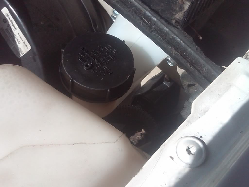

master cyl, the lines of the unit were formed with a i6/ax-15 combo in mind, bit of tweaking will be needed once the headers get put on so i don't have it burning up or rubbing on the steering column.

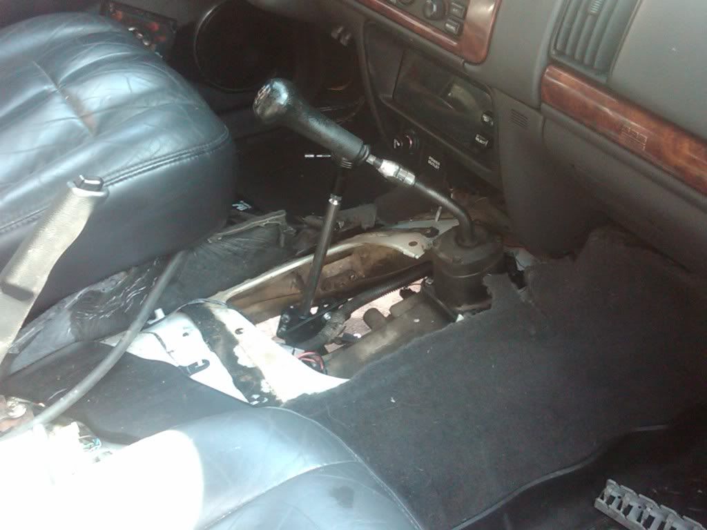

interior, the shifter is a temporary solution till i find something else i like to screw onto it. the ram shifter needed some love from a torch and pipe to bend it into a configuration that cleared the dash well. i also had to take out one of the washers in the tower that control how stiff the side to side motion is since it's a much shorter stick in the grand than the ram.
functional pedals finally, the brake pedal seems to have a higher ratio than the previous one, brake response seems stiffer and comes on quicker. the clutch pedal is mighty close to that plastic box on the left, i can forsee my duck feet hitting it from time to time till i get used to it.

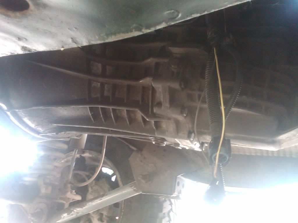

trans mount and novak shifter linkage. may need some more tweaking on the linkage, but appears to be good as it is. we'll see once i get more time with it. MUCH more direct feeling than the stock linkage.
the mount is 3/16 plate to sandwich the kor x-member mount. the ram mount is about 1/2" wider than the gc mount, i also had to flip the tranny side mount plate to situate it about 1/2" back too. the exhaust hangar is now on the wrong side(a little cut and weld should fix that).

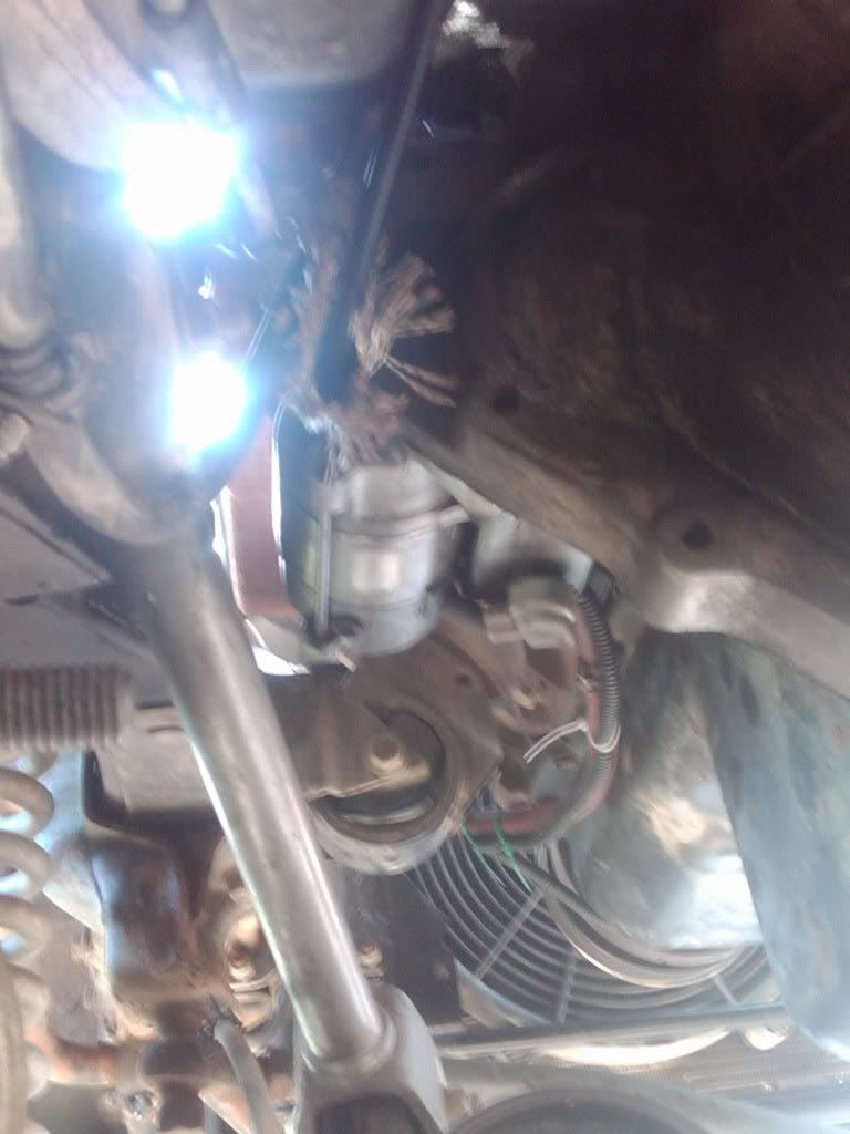

shot up into the starter. this thing hangs WAY out in the middle of nowhere compared to the jeep starter, it's got me a bit nervous about suspension up-travel, so i'm just gonna have to long arm it(if iro will make a custom x-member at a reasonable price).
wow, sorry about the focus on that last one, the black berry's camera is good, but if you can't hold it still...
