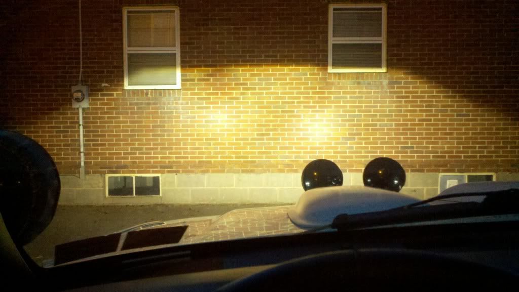

Some pattern shots.
The left light needs rotated counter clockwise a touch.

Awesome pattern, what didnt you like about the ones off ebay? These look higher quality.
