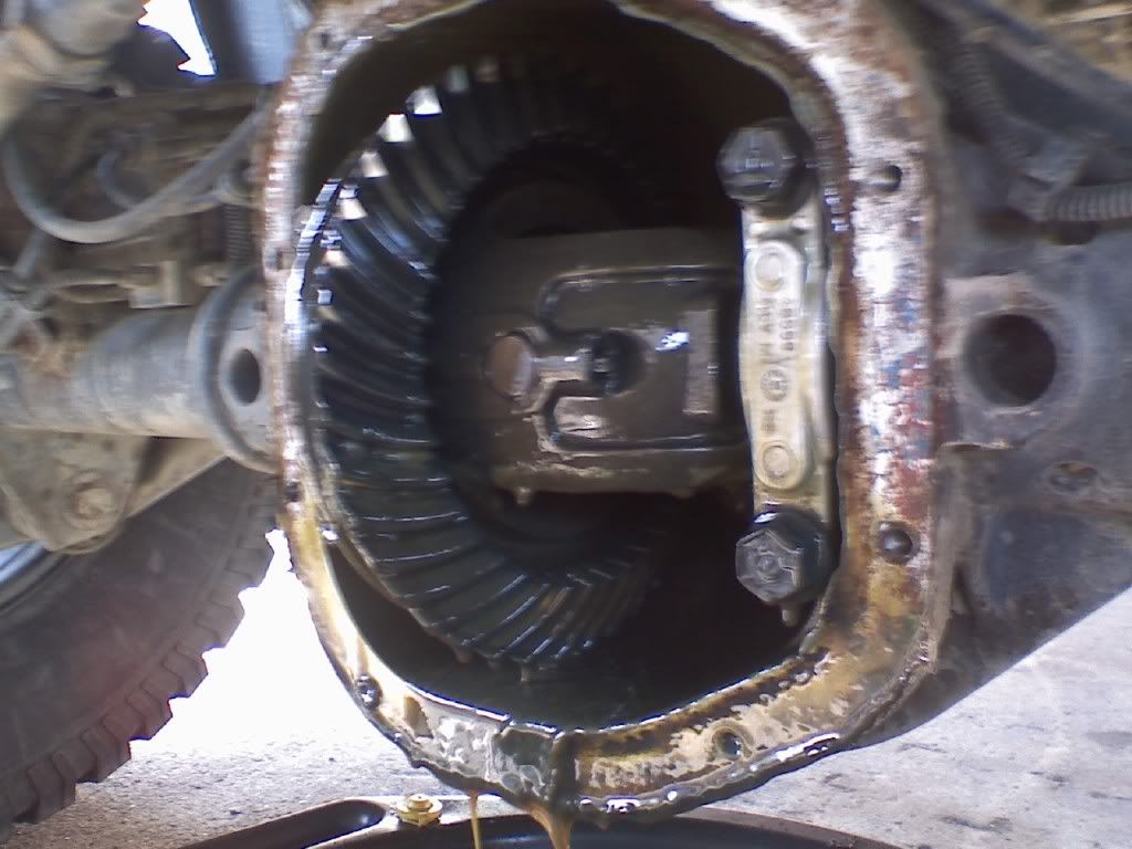

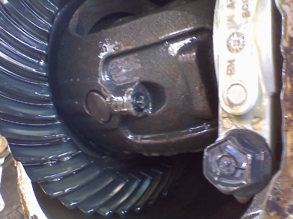

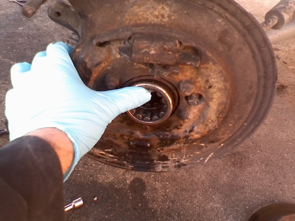

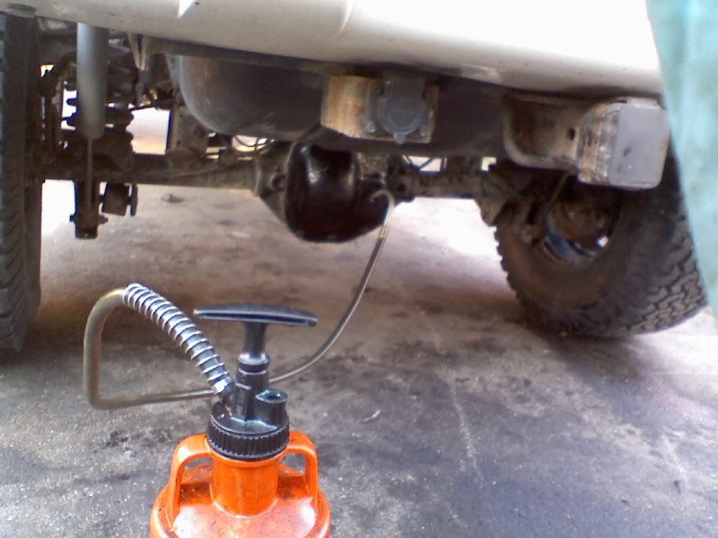

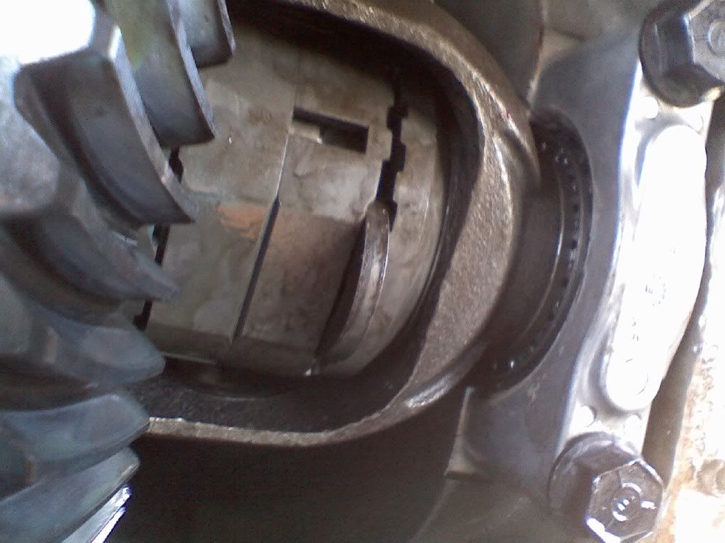

ok, after a test drive it took care of the majority of my bearing noise in the rear end, i think that my driver's side shaft is too scored as well, since that bearing is nearly new too.
here's some pics from the process. firstly...
the most important tool for the job.

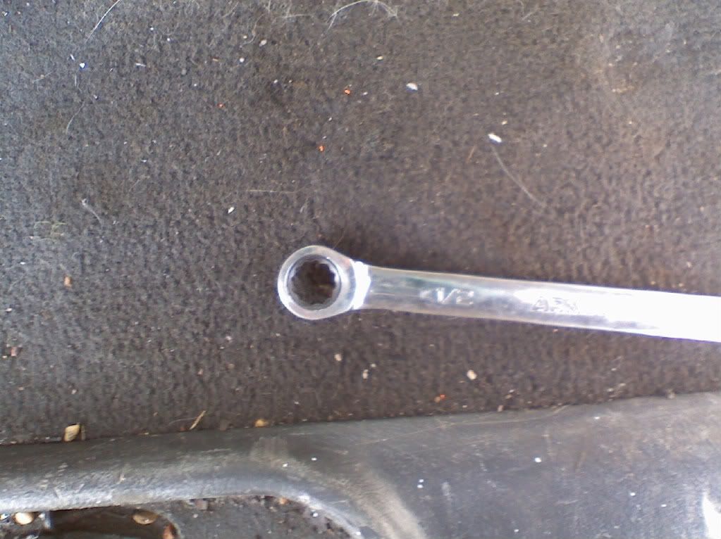

second best tool in the arsenal. if you've never used a ratcheting wrench, you're missing out.
don't forget to slather some of this on every nut and bolt you take out.
if you don't know where to start on this, well, i kinda feel bad for ya. crack the diff and drain it.

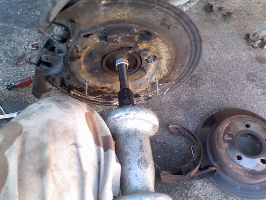

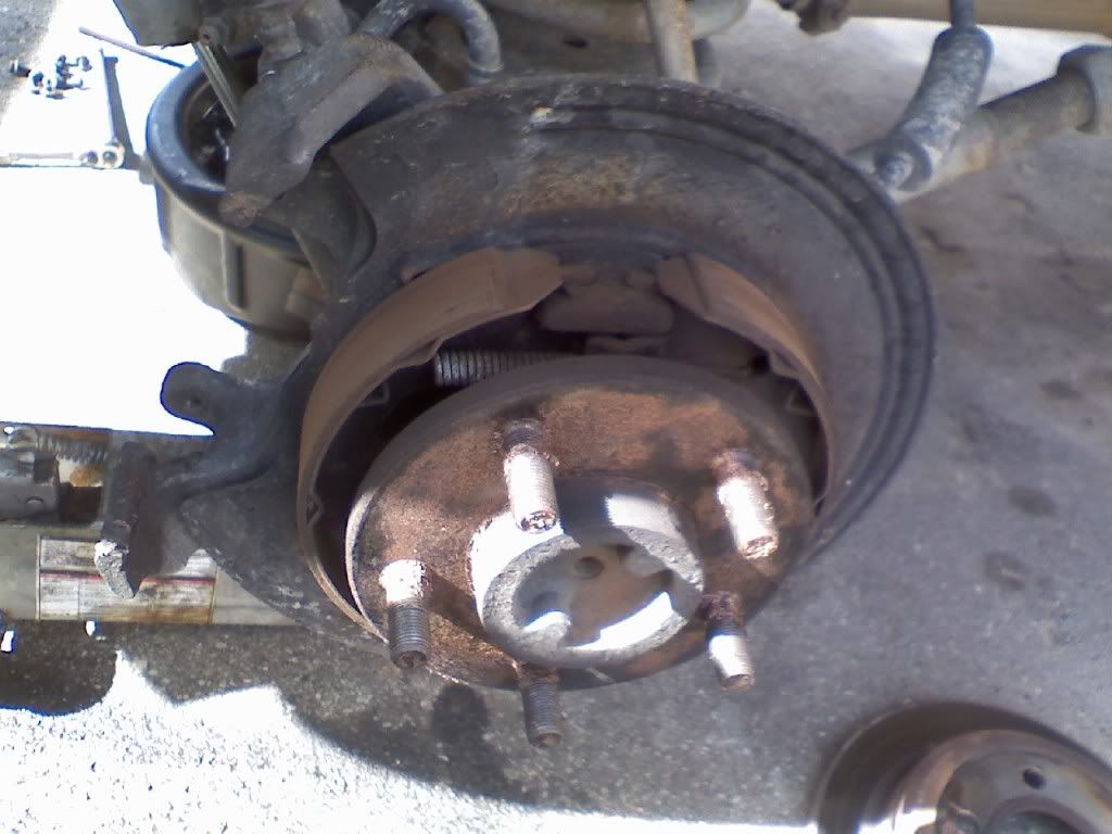

pull your tires and ebrake hardware on the side you want to pull(more room to work with) take the other tire off as well so you can spin everything easier.
pull your drive shaft so you can freely spin the diff as needed.
get the right tool for the job of pulling the cross shaft pin, e8 torx.
for this guy
now you can rotate the locker around(or pull the spider gears if you don't have an aussie( )
if you have an aussie, pull these springs.(never mind the milkshake)
now the c clip will either fall right out or it'll take you 2hrs to get it wiggled just right to come out. guess which way it went for me this time...
pull the shaft out, use a slide hammer to yank the bearing and seal at the same time.
tap the new bearing into place a little bit with a non marring hammer. then use the old bearing to pound it evenly the rest of the way in.
the same method works for the new seal using the old as a punch.
throw the new shaft in, pop the c-clip back into the slot, put the springs in, throw the cross shaft in. rtv the cover and put it back on, then fill with your choice of gear lube. i happen to use this wonderful contraption known as an oil safe to pump the oil into my diffs. saves a lot of messing around.
'97 zj 5.2, some stuff, some other suff, and some things that even work sometimes.

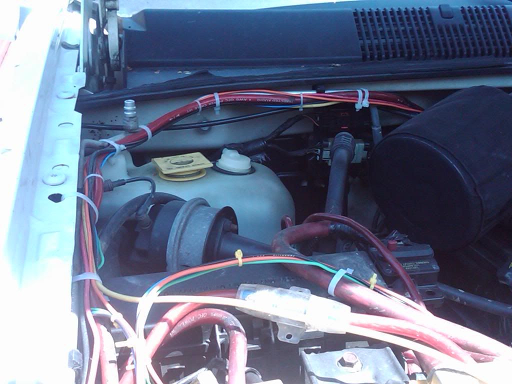

took the time yesterday to reroute my power cable for my stereo, along with relocating my ignition controller and light and fan relays to under the rear seat.
ran all wires under the carpet and to a hole i cut in the tranny tunnel. pulled the wires up the trans tunnel and back of the fire wall around the pass side head and secured to the wire looms already there. significantly cleaner than what i was running, plus i was going through corroded relays about every 2-3 months with them being under the hood.
everything is on push connect fittings so that i can reorganize everything under there when i get a box built up.
it was dark out while i was doing the work so no pics of the in progress this time, i'll get some pics of the wires routed in the daylight though.should have picked up more 14ga red and white(ran out) and 10ga orange so that i could keep the colors consistent with what they went to. as it is i had to sub in some blue and gree 14ga and black 10ga.
yellow 10ga running main power back to the relays, 12ga red running power to the lights, 10ga black power to the fan, 14ga orange, black, blue, and green for the ign controller. white and light green for the switches.
the hole in the trans tunnel is 7/8 to fit the 4ga power wire for my amps and all the other wires running through it. i will need to enlarge it if i do end up running 2/0 welding cable to the back for power like i want to.
the reason for the separate power cable for the relays and ign box is that if something overcurrents my amplifiers, i don't want to have it shut down my fan and engine as well.

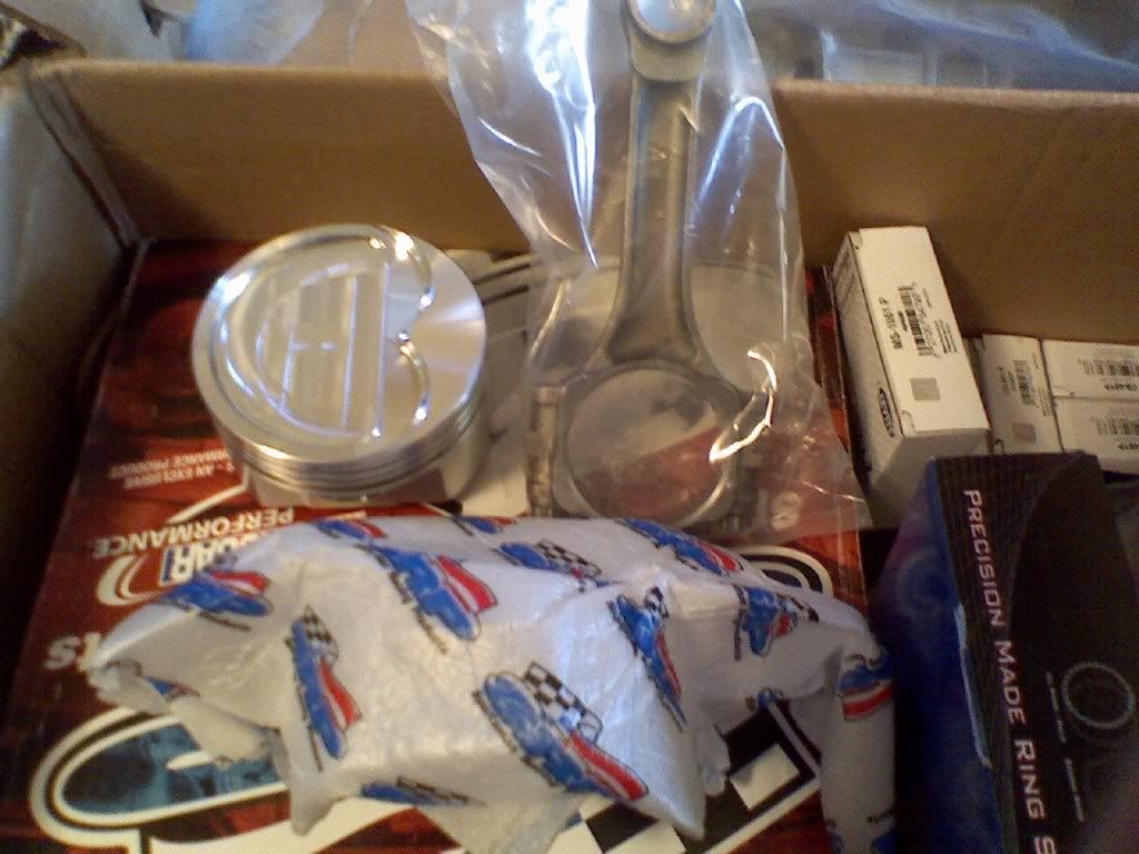

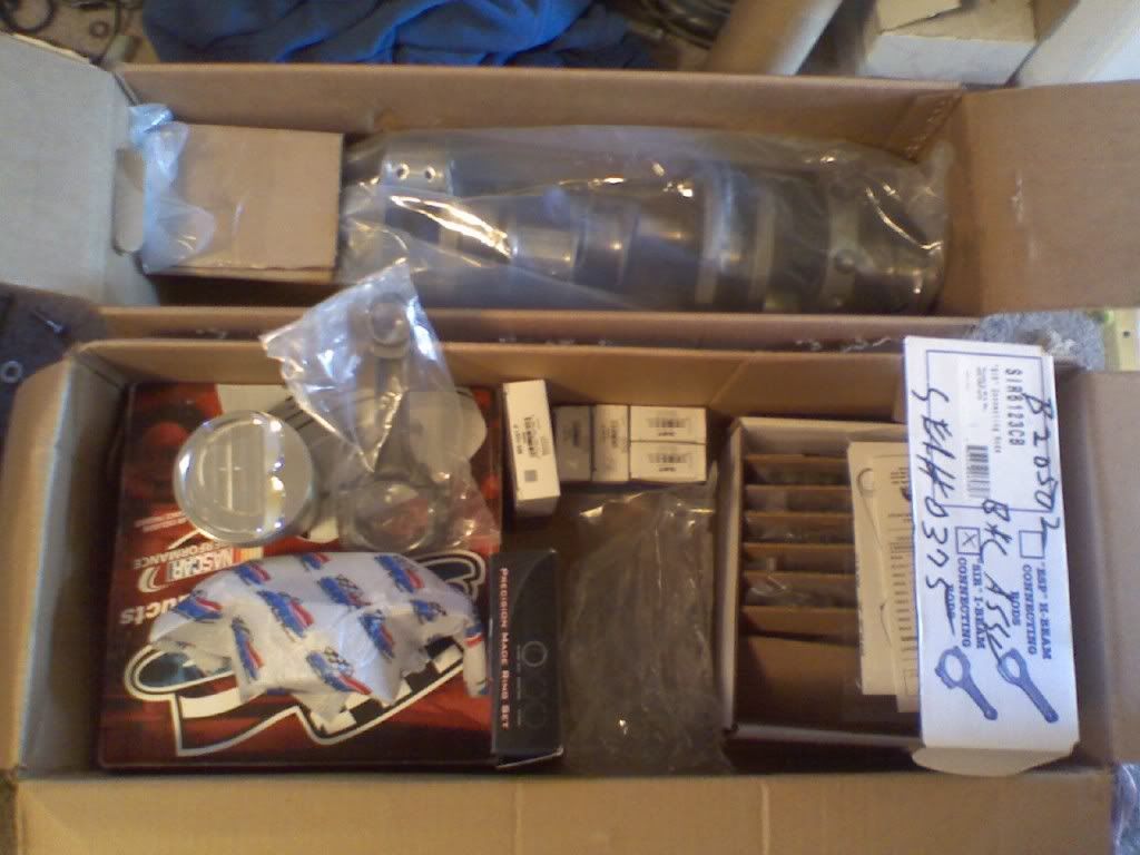

my wallet is now 1200 dollars lighter due to a 408 stroker kit being purchased.
still waiting on aps to get my shift and rebuild kits here. wayne certainly does know his stuff about the inside of a gearbox. he isn't the best at email or shipping quickly, though that's only my experience thus far.

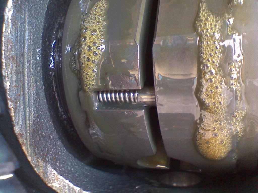

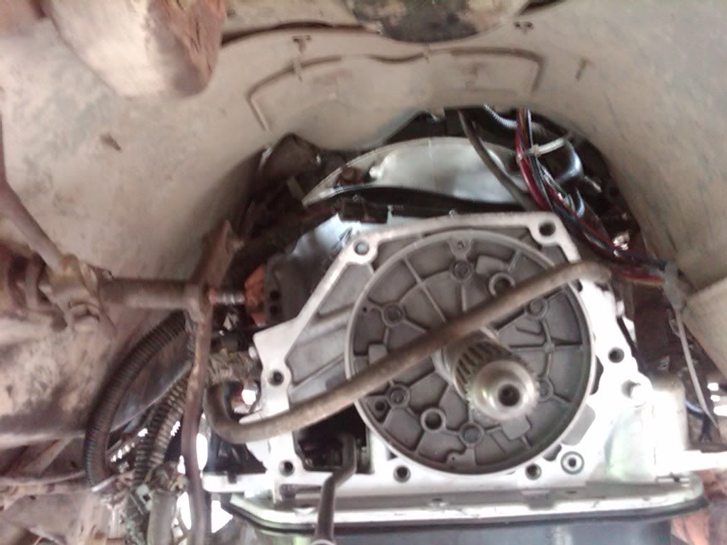

now on to the fun, some of the guts of a transmission.

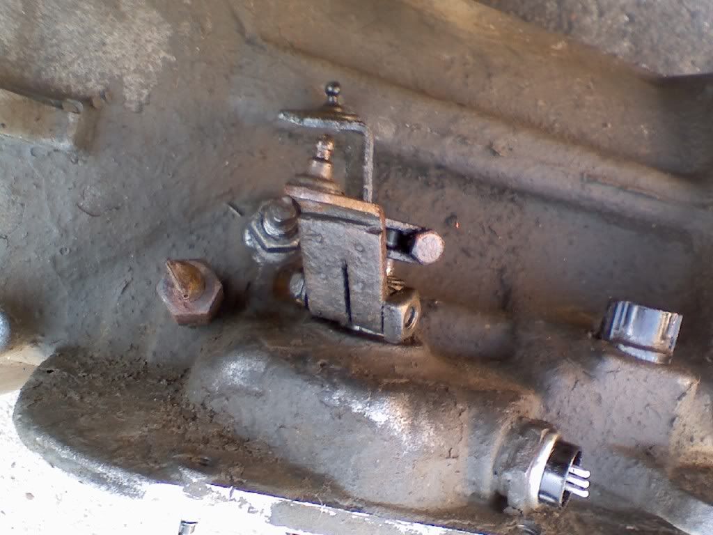

pulling it out is pretty straight forward, here's what needs done to pull the valve body though.
remove the shift and tv cables, they just pop off.
loosen the clamp bolts on the shift and tv levers and pull them off.
flip it over (if it's out) or climb under there and pull the 10 hex head bolts on the valve body. they are different lengths, long ones go on the accumulator, the rest are pretty self explanatory.
park rod e-clip.
valve body will wiggle the rest of the way out and now you've got your guts showing. very dirty guts if you're over 75k.
you need to unscrew the band adjusters at this point and take out the front band apply strut.

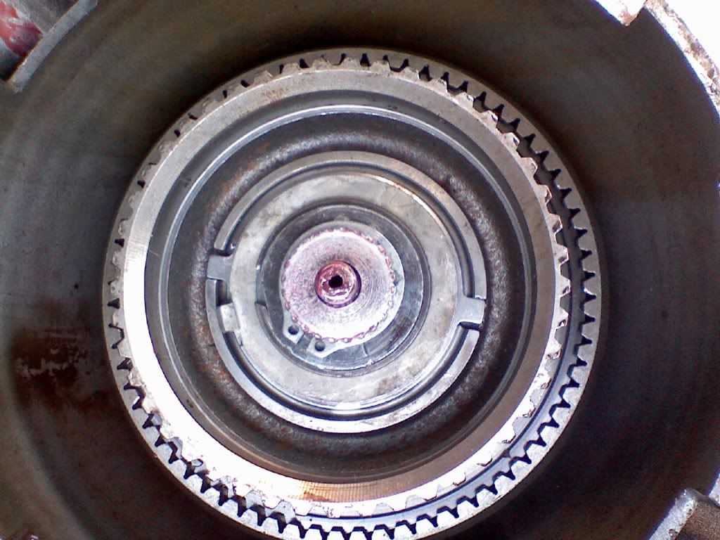

after this you start pulling things from the oil pump back, it's easy and pretty self explanatory. the pump comes out with a slide hammer, you can get a puller tool for it or just yank from one side at a time till it pops out(alternate sides when you get a bit of movement.)
here's what you'll see after the pump is out, just grab the input shaft and pull up, the front half of your transmission's fun parts will just come right out for you.(front planetary and clutches)
next you just take off the retaining ring on the intermediate shaft and the rear planetary and clutches will come out.
this is just to show you generally what all is in there, you shouldn't attempt this without an fsm handy.

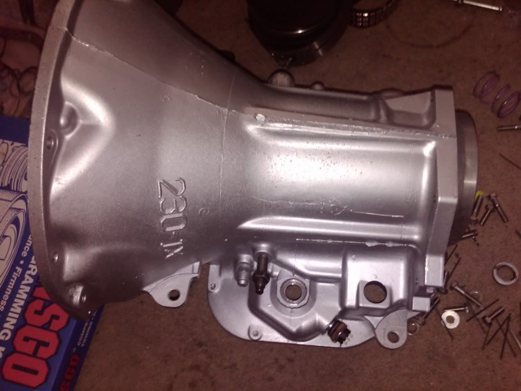

cleaned and painted housing.
down the front. no guts yet.
all seals replaced
overdrive unit with intermediate shaft. aligning the od planetary splines sucks.
front half back in the jeep, it was MUCH lighter and easier to maneuver this way.
will add some final pics when i get under there again to adjust the valve body a bit more.
here's my underhood wiring i was talking about earlier. runs into the trans tunnel and up the firewall to the batt area, power for amp and relays send/return for ignition box and power to the kc slim lights and fan.
