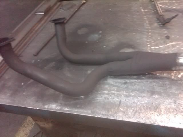

Ended up using 90's instead of j's. Curing the ceramic sint on the y-pipe now. Pictures coming soon.

forgot the weld in bung, i'll get that tonight. wish i had more time and warmer weather.

Exhaust, both street and wheeling versions, are all but done. Need to figure out the best hangar placements. Pics forthcoming in the daylight.
Did a side exit for inspection and road legality and I can run just a turndown at any point after the y-pipe merge as I feel like. The cat and glasspack have collector flanges at both ends for ease of removal. 2.125" Id tube from the headers to the merge, 3"id the rest of the way back. Used the flowmaster y merge found on summit racing.
Now, back to aligning the rear axle. Such a pita that is.

some pictures. don't mind some of the crappy welds. fluxcore and aluminized pipe don't always mix.
also, don't mind the jack holding the slider up, haven't properly fitted it yet.
what will be my new driveshaft after re-tubing. aluminum from a ford ranger edge(you'll crap a squirrel if you knew what i paid for it). tube is dinged up but the slip, flange adapters, and yoke ends are perfect.
now some exhaust.
side exit. needs a turndown or something a little cuter.
low hanging, dips under the frame stiffeners right before the body side clayton's brackets.
glasspack end.
y-pipe merger. could have done better on the welding, the industrial mig i was using just put too much voltage into things though. there was some hammer clearancing required after the final assembly due to some heat warpage too unfortunately.
next up is start up to burn off the oils and what not from the pipe, then coating with some ceramic paint to rust proof it all for me.
on quite an interesting side note, i found that jegs shipped me a stainless turndown instead of an aluminized one. that made for about 20mins of frustration with the mig machine before i pulled my head out of my butt and grabbed the lincoln 309 rod and fixed it right. lol.

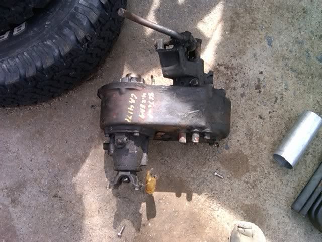

i wonder what this is?
'97 zj 5.2, some stuff, some other suff, and some things that even work sometimes.
ratmonkey is offline
post #149 of 731 Old 04-02-2010, 02:12 PM
squashman702
1994 ZJ
Location: Allston
Posts: 4,419
Oooooh I know it's the 4x4 thingy!
