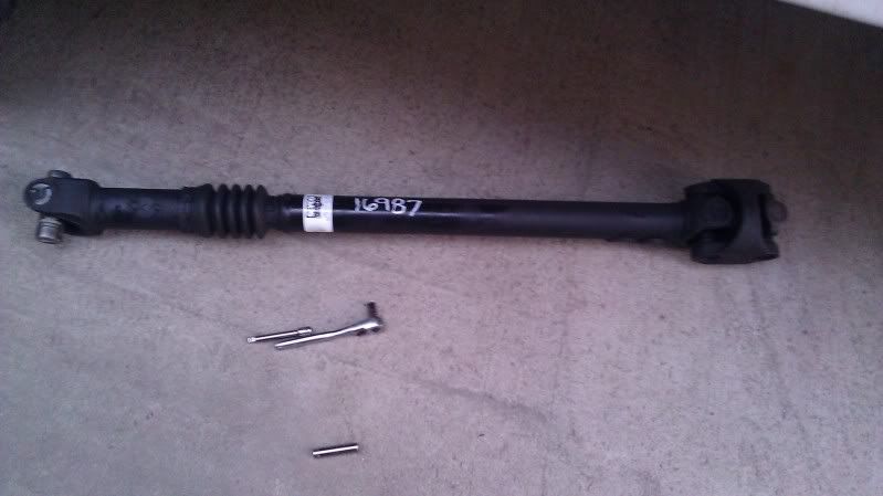

Well, It looks like the joints were wearing fast because the CV section of my cardan joint was toast. I had the driveline rebuilt this morning, and WOW what a difference. The WJ has NEVER felt so good at highway speed since I've owned it. At 70, it felt very smooth. I also dropped it into 4lo, and the clunking/grinding is gone!!!
I guess I should see if 4WP has some par pin eliminators in stock tomorrow, I would like to eliminate that one last annoying sound up front.
Here is the driveline just before it went in. For a minute, I thought there was a problem. The joints fit so tightly into the yoke, that they were not going in between the ears on the yoke. I had to snug the bolts up slightly to get them to pop into place. I am very happy with the smooth ride.

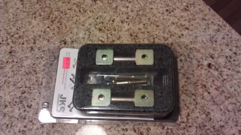

I picked up bar pin eliminators today, hopefully they will go in tonight.

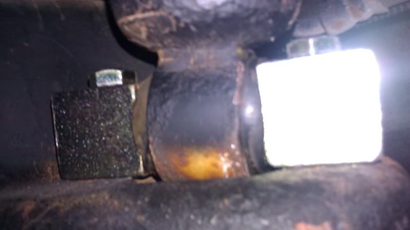

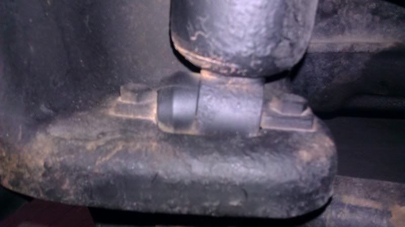

I really needed bar pin eliminators as the shock bushings were not staying in place, it was actually getting pretty annoying. When this happens (pretty common on the WJ's and ZJ's, the shock contacts the axle mount and rattles. I am glad this sound is now gone.
I am glad there is a 4wp close to me, I have been there twice in the last week.
Here is what both sides looked like:
Fixed:
