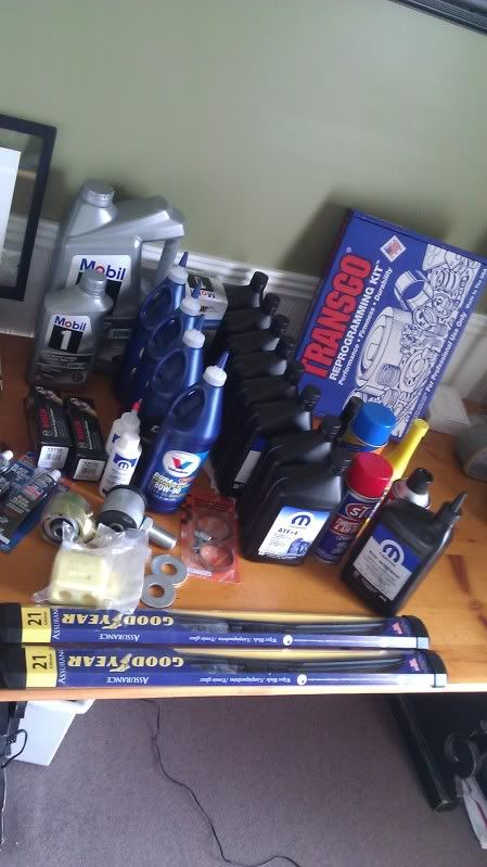

Parts started coming in this week, and today was the day:
Seafoam earlier this week, Oil and Filter, Front and Rear Diff fluid change with LSD additive, New O2's front and rear, New drivers side bump stop, New windshield wipers, removed stock windshield wiper fluid reservior, replaced fog light bulb...Still waiting for the transmission filters and fuel filter to arrive. I will install a TransGo shift kit, new fluid and filters next week before Easter Jeep Safari.

What are those joints for?!

I have one more front lower control arm to rebuild. I have been replacing the RK joints with Johnny Joints and an RK poly on the body side. I will most likely wait until after Easter Jeep Safari for that, but need to do it before GSW.

The look massive. I'm not sure why.
