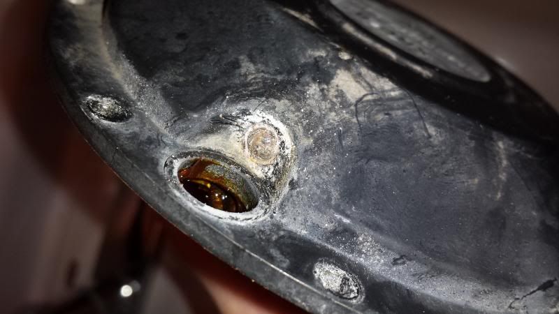

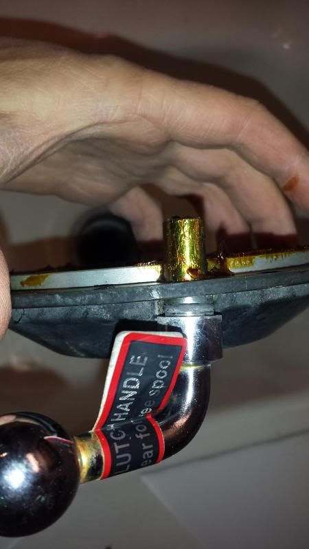

My winch (Smittybuilt, less than a year old) was frozen in the engaged mode. According to 4wp, they have seen this a few times. They hooked me up with a new outer cover, selector lever, and install kit.
There is a spring that rests into a bore in the outer cover, with a steel ball on top of it. The selector compresses the spring, and rests on the ball. The selector has two cavities in it that the steel ball rests into, thus keeping the spring loaded selector in the engaged or freel spool modes. This bore filled with water, corroded, and the spring/ball would not move.
When I installed the new cover/spring/ball/lever, I filled the bore with grease to prevent future corrosion. I also added a cover to prevent further issues.

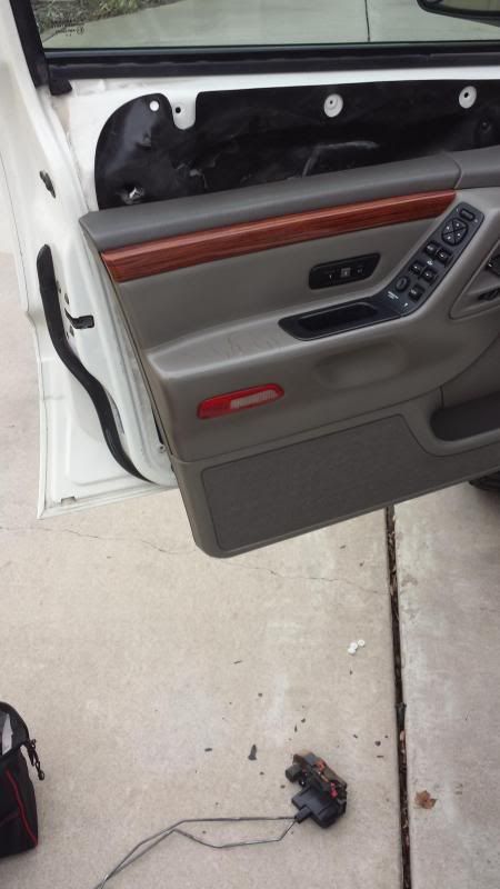

The lock mechanism started making noise around Christmas, and I purchased a unit from Pick N Pull that same week. It finally gave up the ghost today, so I pulled the door panel and replaced it.

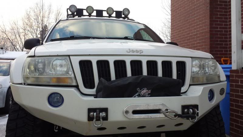

How did you get that smitty cover on? I couldnt figure mine out.. haha
MoonyJohn is offline
post #787 of 796 Old 02-18-2014, 01:10 AM Thread Starter
85IrocZ-28
Location: Davis County Utah
Posts: 3,934
It was kind of a pain with the bumper tolerances so close, I trimmed quite a bit more in order to give me some working room. I just crisscrossed the cord beneath the winch, and then into some of the loops on the cover. Then I pulled it tight and it pulled the cover down over the winch. Good Luck.

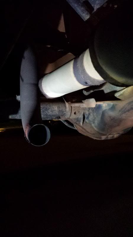

All those wheeling trips have had their toll on the exhaust system. I have had to weld the inlet back onto the muffler two times, and now this happened:
I was just going to put a turn down on it and call it good, but I just decided to run over to a local exhaust shop and have a magnaflow installed. I also had them cut the hanger and raise the rear of the pipe about 3 inches. It matches the lines of the Protofab much better now.
