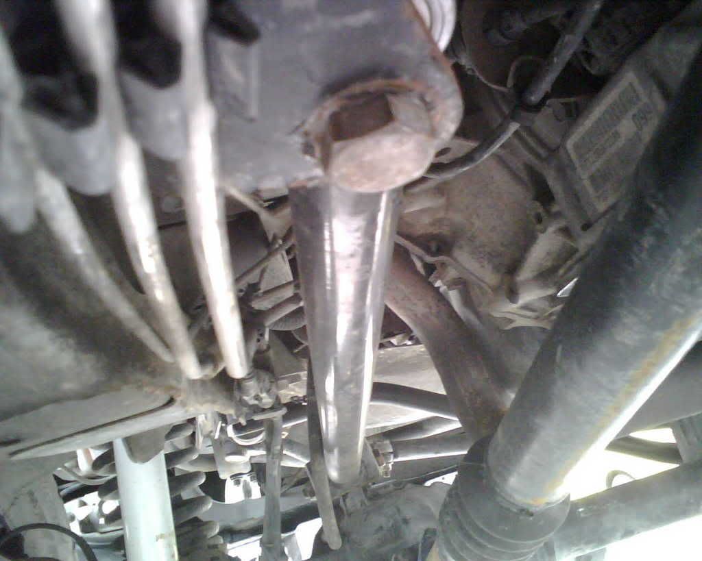

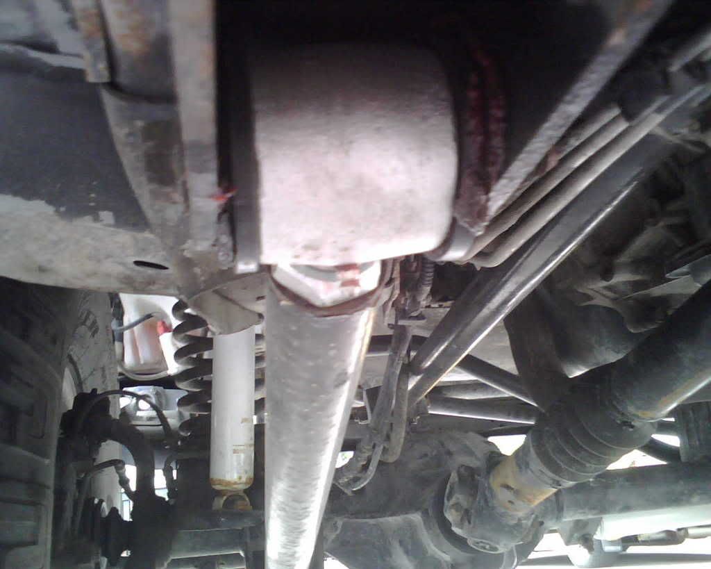

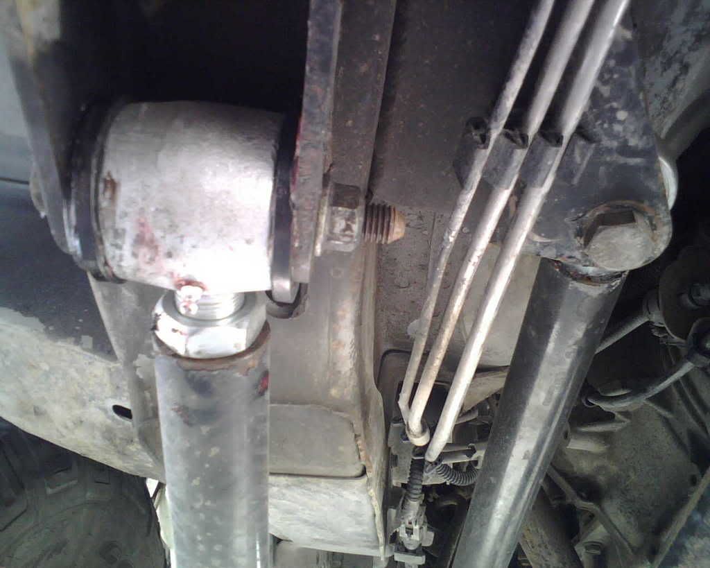

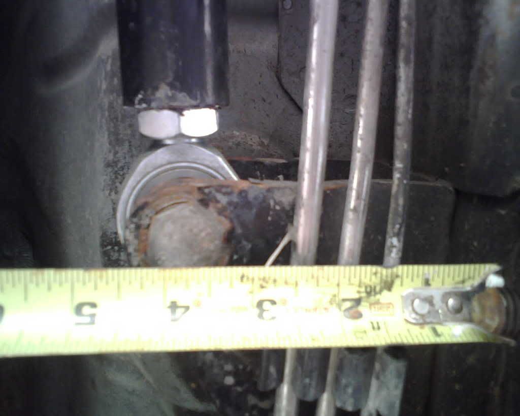

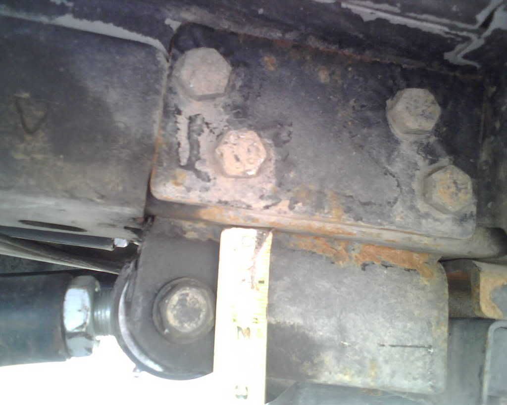

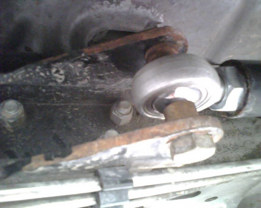

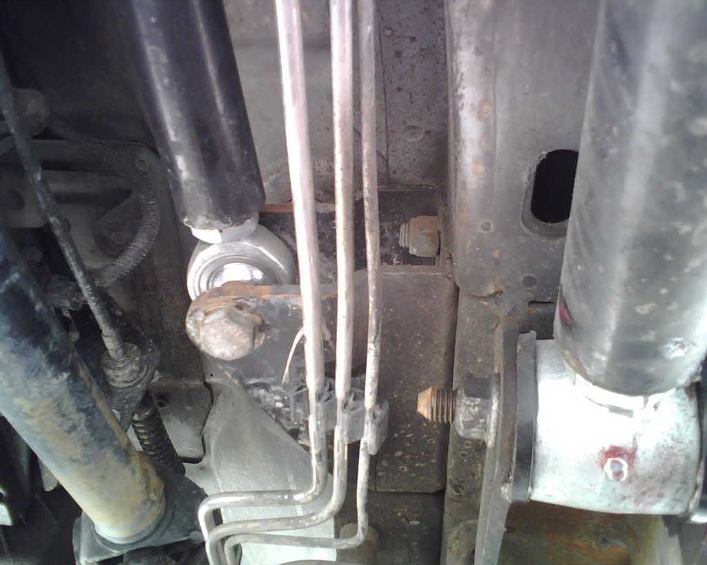

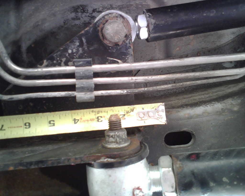

Do you have any pictures of the frame side 3 link bracket? I'm going to build my own long arm and wanted to see what RK came up with.

Drivers Upper:
Drivers Lower:
Drivers Upper and Lower. The upper plate is bolted through the unibody to the plate on the inside of the unibody, where the upper arm bolts to. The lower section looks like it has abreak it in (there is a a cutaway) but it actually extends back and include the peice that spaces the crossmember down 3/4".

Thanks for all the pictures. That's perfect. I'll have to spend some more time under my rig scratching my head I think. How much bump stopping do you have? For some reason when I was doing my preliminary looksie it looked like getting good uptravel would be difficult.
