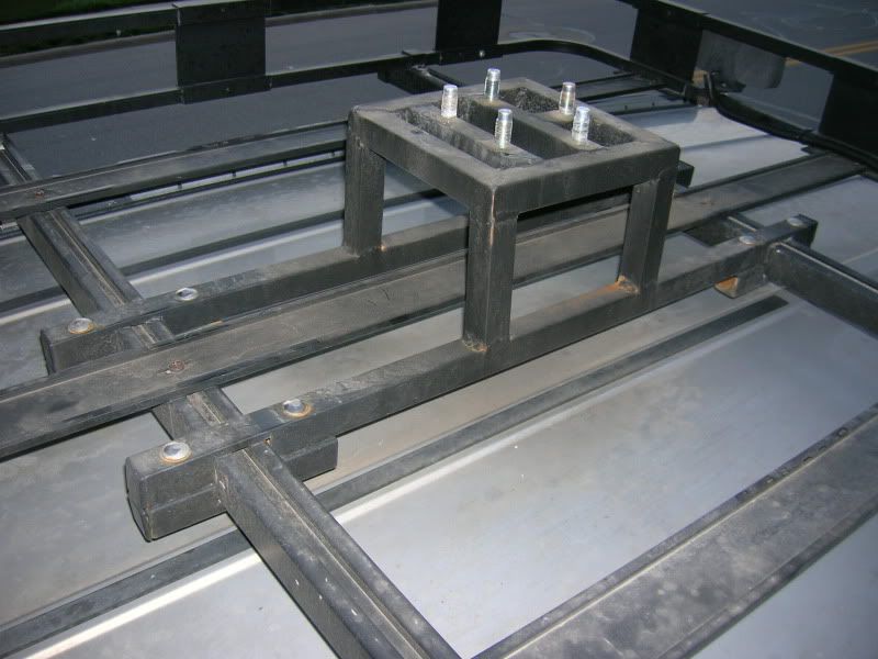

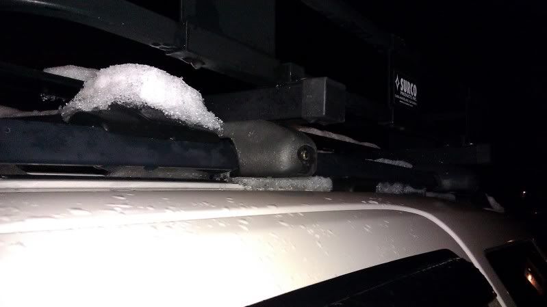

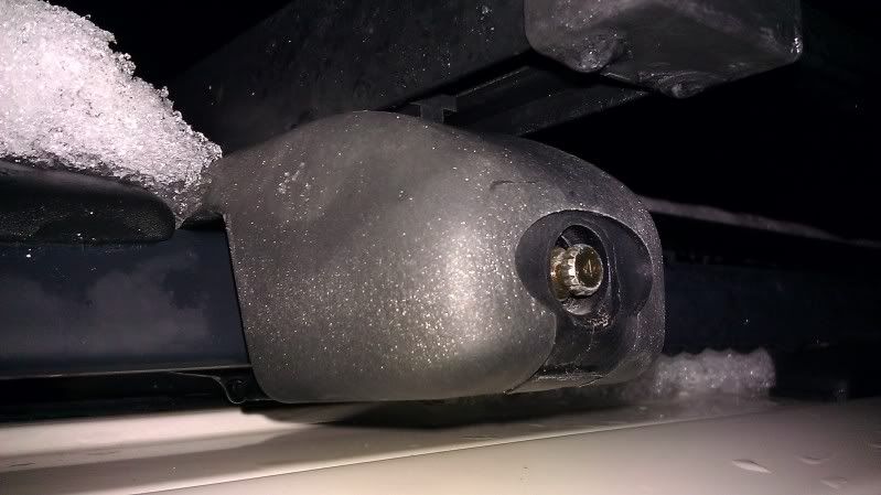

Hey Iroc, how did you mount that surco roof rack up on your WJ?
lifted5.9 is offline
post #62 of 796 Old 01-25-2011, 12:18 PM Thread Starter
85IrocZ-28
Location: Davis County Utah
Posts: 3,934
It came with mounting brackets that clamp the factory rails. I'll try and get a pic of them tonight for you.
I just left the factory cross bars on. I removed them from my ZJ when I ran this same rack, but I just found that they can slide underneath the rack like they aren't even there.

lifted5.9 -
Here are the pics I snapped with my cell tonight:
I like the Surco racks. I even made a tire carrier for the one on my ZJ. The 32's weren't bad, but there is no way I want to move a 35 down and back up on the WJ, so I will look for another option.

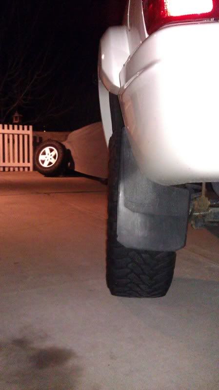

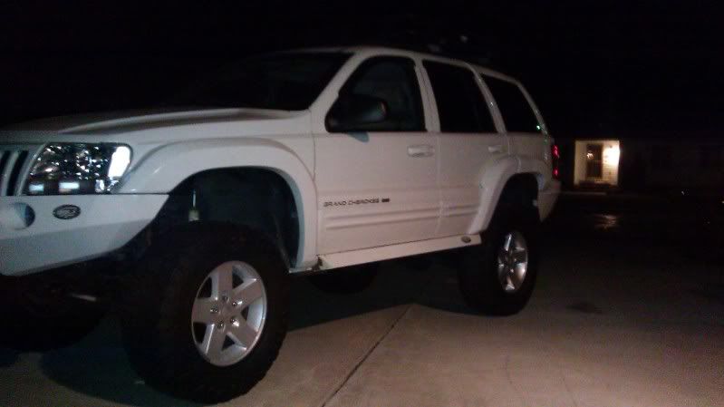

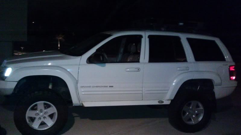

I put the JK wheels on for a test fit today. Pics suck, it was night and the cell phone flash isn't that great.
I really like the look, but need some new tires. These Toyo's are getting pretty low on tread.
As you can see, the offset is terrible on these wheels. I love the look, but I am going to need some wheel spacers to run them.

how's the offset on the jk wheels? are you still gonna have to run spacers?
Build In Progress...
It's a Jeep, it's not supposed to work right all the time.
Live in Florida? Check out Florida4x4.org!!!
mrJ is offline
post #72 of 796 Old 03-03-2011, 09:23 AM Thread Starter
85IrocZ-28
Posts: 3,934
The last two pics show how inboard the tires are...the offset is terrible. Spacers are needed for sure. I am so close on the rear, that I think it would rub the spring, shock, and especially the body if I were to articulate at all.
I love the look, but spacers will be required.

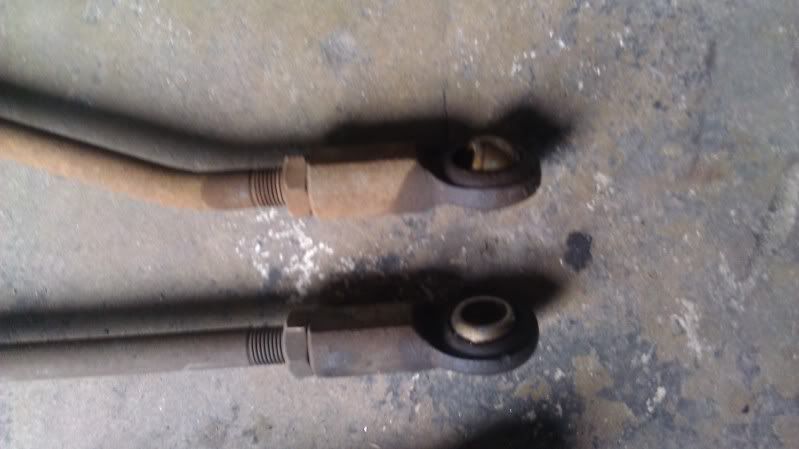

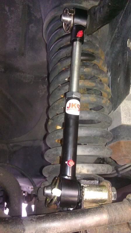

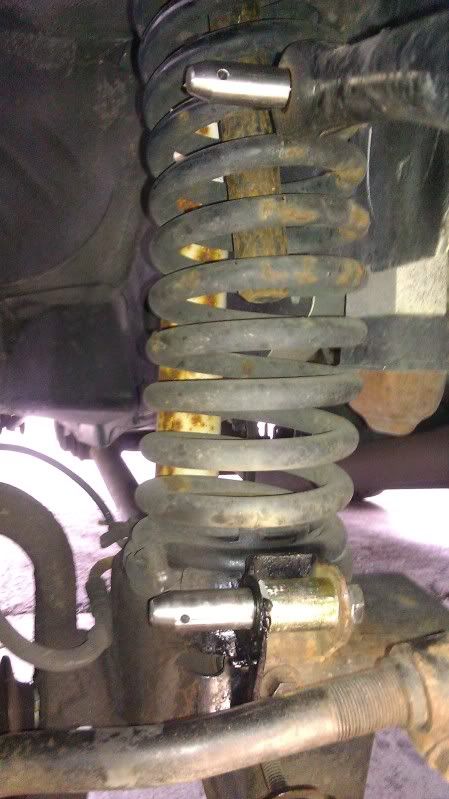

I pulled my old fixed endlinks off and installed my JKS Quicker Disconnects. It wasn't just a bolt in job though, both sides had tears/holes in the lower U where the endlinks mount to the front of the coil buckets. I spend time adding metal, straightening mounts, and welding.

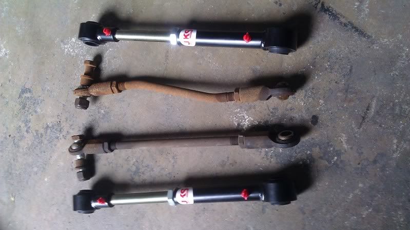

Also, does anything look wrong in this pic? I didn't even notice this until now (installed by PO). The fixed end links didn't match up, one was straight and the other is bent. The bends are a factory bend...What's up with this garbage, terrible:
The joints were really getting annoying over the smallest of bumps on the road. This pic shows how much slack they have in them, I am glad they are gone. See how the one joint ball is twisted clear around? There was a ton of slack.
Welded, fixed, pins installed.
DONE:

You'll like the quicker disco's. Make sure your bumpstops are long enough!
