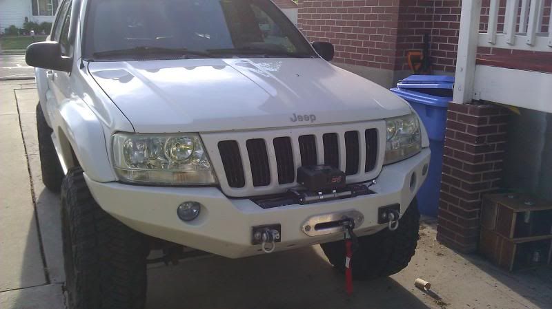

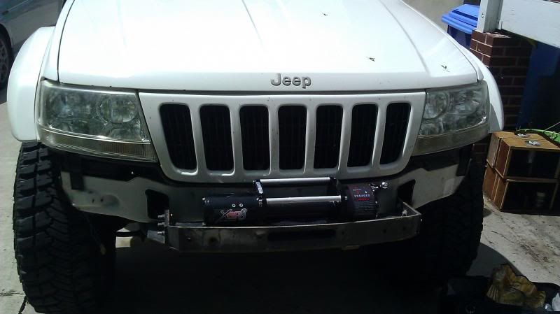

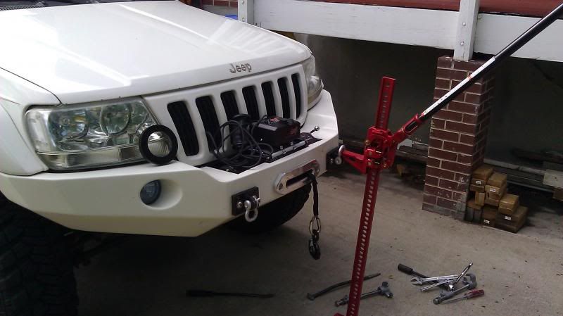

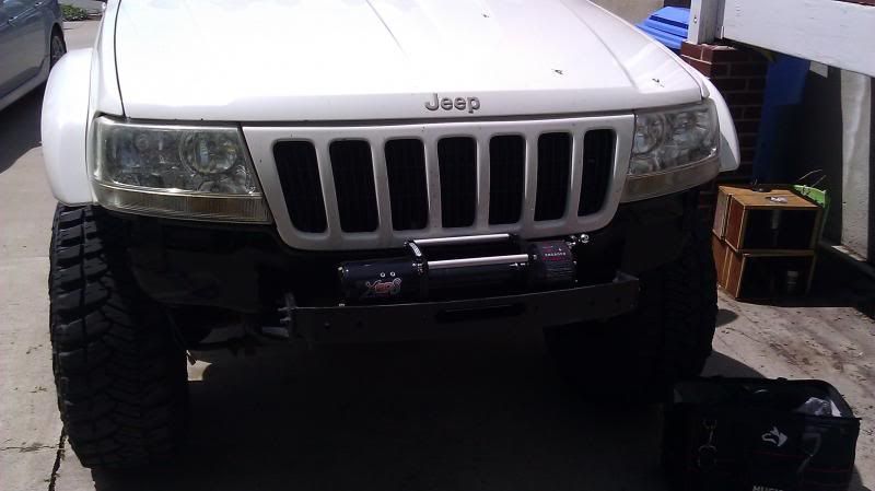

I installed the winch today, it actually went really smooth.
During the first test fit, I noticed that there was too much white visible, and I needed to black out some of the lower panels that have been hidden behind the bumper. A small portion may be seen with the winch cutout. The winch fit well, bolted right up to the Iceland Offroad winch plate:
Luckily I had a rattle can of black, so I quickly sprayed a bit on the front of the jeep before I continued.
The cables were labeled very well, and were easy to install:
There is an area just below the passenger headlight where you can run the wires from the winch up to the battery, perfect path:
There is a bit of extra wire. I just wound it up, tied it together, and left it on the side of the winch tray next to the winch. I will be hidden and out of site:

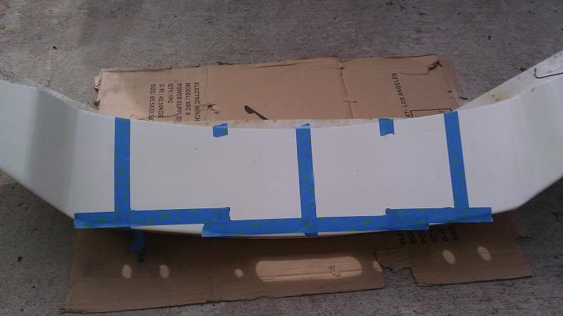

First I made a template with some cardboard, then found the center of the bumper, placed the template in place, and laid some tape down for lines, and cut the fiberglass (while wearing a breathing mask and long sleeves of course. I measured many times to make sure that I was cutting it correctly (measure from the mounting surface of the winch plate, add the thickness of the bumper, the measure from the front outer bumper shell:
After I sliced it, I installed the bumper and wound the line in.
I need to wind the line out, and tighten it under load before I use it. But everything is on and it fits, I am very happy with the winch. Next time we run Metal Masher, I will take a shot at widowmaker.
