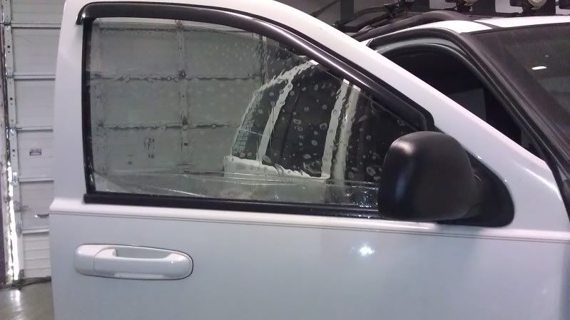

It has been years since I tore the tint off of my front windows. The PO had installed tint that was too dark. It was time to add some mild tint again:
It is now on and looks good.

Looks like you've got some bubbles to work out there! Haha I did tint on my XJ when I had it and it was no perfect job but it came out quite well for a DIY outside install. To get the best looking tint its gotta be done in a clean room or a clean corner as some shops have. The edges are what got me. Ill probably end up paying somebody to do it in the future if I need tint work haha.

Yeah, that was mid process. They look great now, this pic shows everything wet before the bubbles were squeegeed (sp?) out
I was going to do it myself, but it was only $60 to have a pro do it. It took less than 20 minutes, they did a good job. They heat shrink'd it to the curvature of the window before they pulled the backing off and installed it. Lifetime warranty for that price, I decided not to even try it myself.

Ahh I didn't know somebody else was doing it. Honestly, at that price I would have done the same exact thing working out the bubbles and cleaning the edges perfectly so you don't get trapped dirt is harder than it sounds.

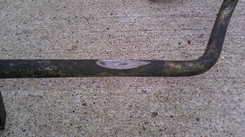

Fixed the brake fluid leak...
It looks like when I replaced the calipers in freezing weather this January (while laying on the ice) I didn't get the line far away from the CV...
