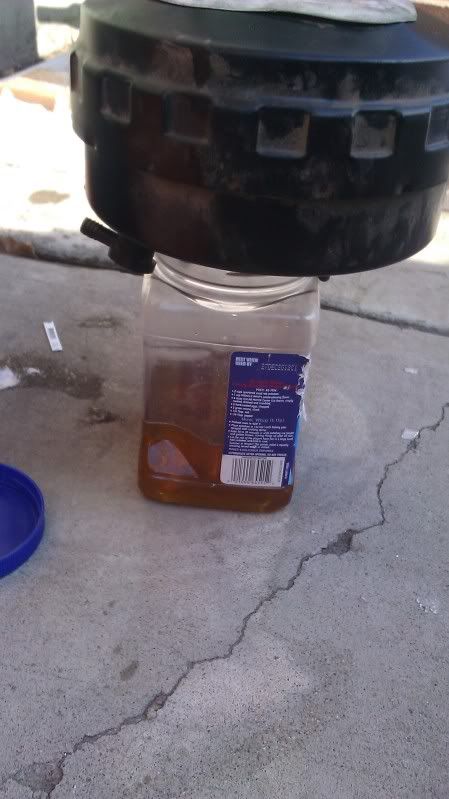

All I can say is WOW, the MC really did need to be replaced. When I removed it, I could see a lake of brake fluid in the booster.
I was amazed at how much fluid actually came out of the booster:
I bled the MC and got everything back together. The Booster was only a year old. But with all that fluid sitting in it, I decided to replace it also. The fluid looked pretty dark, I assume that it has been eating away at everything in the booster. Rather than rinse it out and risk it...a reman unit is now in place.
Now if I can just get the air out of the ABS unit, the brakes will be 100% again.
