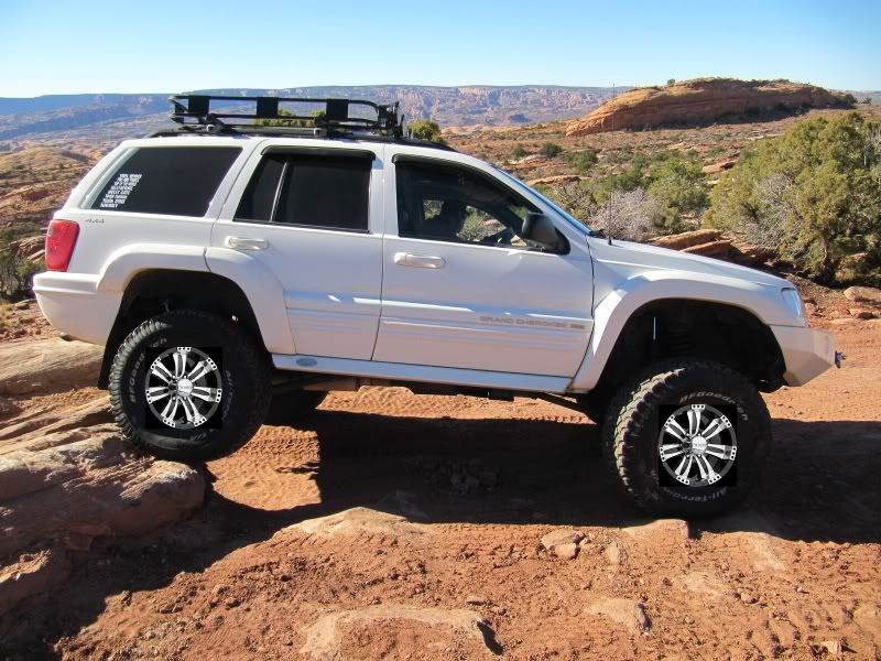

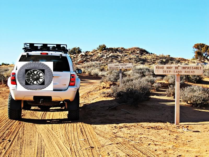

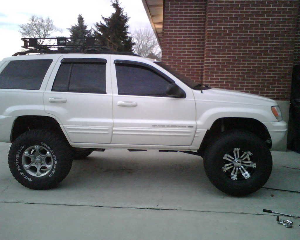

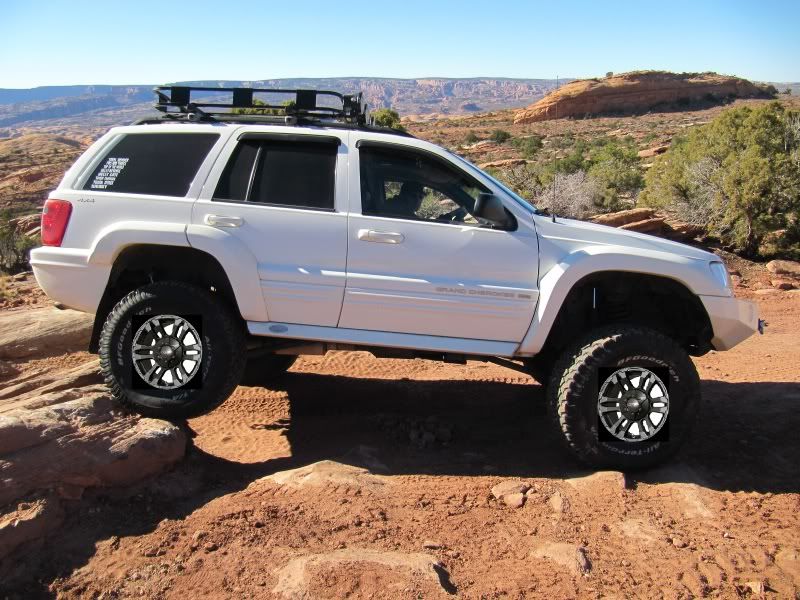

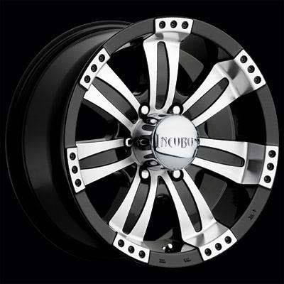

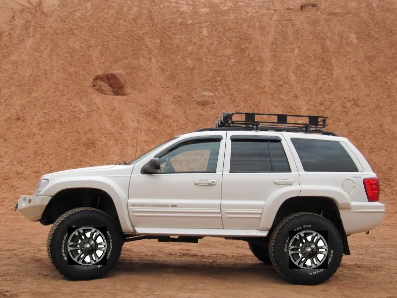

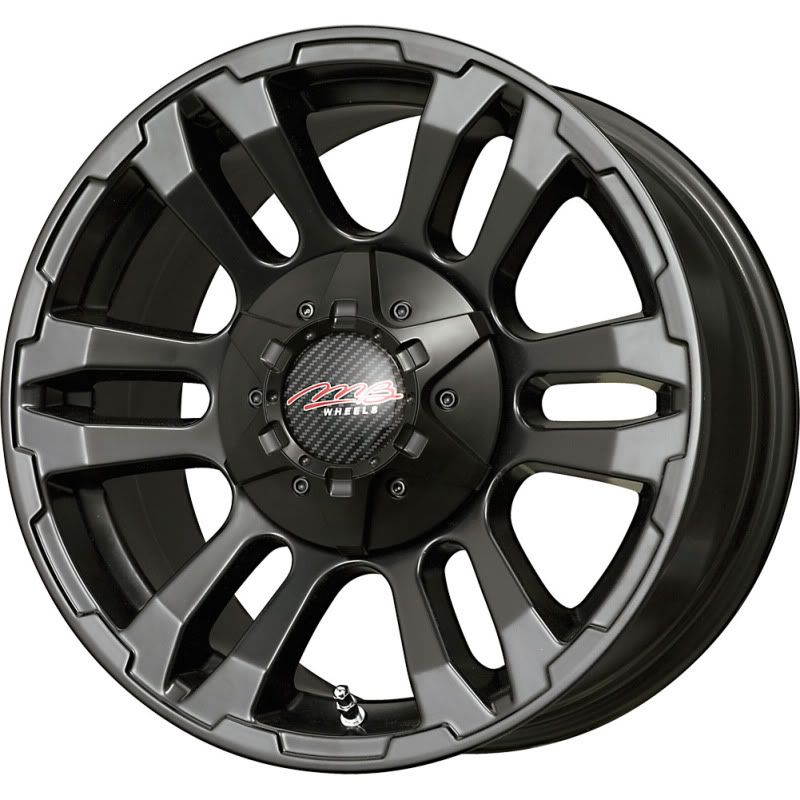

I haven't been able to find a matching wheel for my Jeep. As I would like to get a rear tire carrier bumper, I want matching wheels.
My current spare is an Incubus Poltergeist. So I am debating on buying four more of those, or just buying 5 new wheels. Here are the two I am interested in, along with a very quick image edit...which wheel do you like more?
Incubus:
Here is my spare mounted...
MB:
*Project Yeti* 99 JGC Limited 4.7 w/6.5" Rockkrawler LA & IRO A-arm, Goodyear MTR 35's on MB TKO's, 4.56 Yukon's, Iceland Offroad Bumper/Flares/Sliders, Protofab Rear Carrier, SuperChips, Uniden/Firestick, Flowmaster, Smittybilt 8k Synthetic Line Winch.
My Jeep is Organic - Undercoated in 100% all natural Utah Dirt --- Utah Jeep Crew #49 ~Will
2012 JeepForum GCOTY ---
85IrocZ-28 is offline
post #373 of 796 Old 02-26-2012, 12:47 AM
alwaysHI
2003 WJ
Location: Hilo
Posts: 2,418
MB!!!!!!!!
but thats just me. haha
Bronson = 21 yrs. old
BUILT, NOT BOUGHT - WORKED HARD FOR, NOT KISSED MOMMY/DADDYS A** FOR!
Build Thread -
SOLD
alwaysHI is offline
post #374 of 796 Old 02-26-2012, 06:52 AM
mrJ
2002 KJ Liberty
Posts: 3,875
Mb
Build In Progress...
It's a Jeep, it's not supposed to work right all the time.
Live in Florida? Check out Florida4x4.org!!!
mrJ is offline
post #375 of 796 Old 02-26-2012, 06:58 AM
GraKee99
Rapist Wit
GraKee99's Avatar
Location: Basalt, Colorado
Posts: 9,443
MB. First ones just have to much going on. Want to buy my spyderlocks?
Brian
WJ, WK, CJ5
GraKee99 is offline
