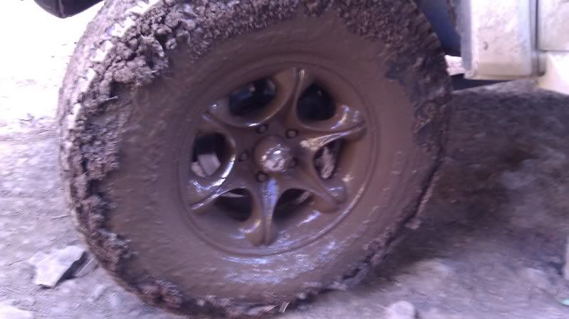

...and...AT's are awesome in the snow and on the slickrock, but they don't like mud. They turn into big smooth balloons with no traction:
I was hitting the body on the side of the hill, and didn't feel like I would make it through. So I had to back out and go around...

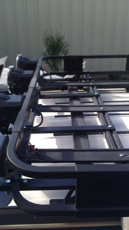

So I fabbed up my own light "tabs" today. They aren't really tabs, more like bars. I have u bolts that work with my roof rack that I ordered from Surco, but I didn't want to use their light tabs. They didn't look strong enough, these HID lights are hefty and I don't want them bouncing around when I am offroad.
I was looking for steel, but everything I could find locally was either overkill for strength/weight. All the aluminum stuff I could find was flat stock, not c-channel. I wanted a c of some type to keep the bar rigid. I will post pics of it installed when I get a chance to do that. My new light bars will mount to the roof rack cross bars. then extend out past the front of the rack. They will bolt to the outer edge of the rack, so they will be very strong and should not allow the lights to bounce at all.
After searching for the right metal, my bro suggested railing steel (yes, for the interior of a house). He even had some lying around. It worked perfect.
I notched the bottom of the back side where it rests on the roof rack cross bar, drilled holes for the roof rack outer u-bolt, and a hole for the roof rack light. Then I strung them through some old cable wire to prime and paint them. They are now ready to install.

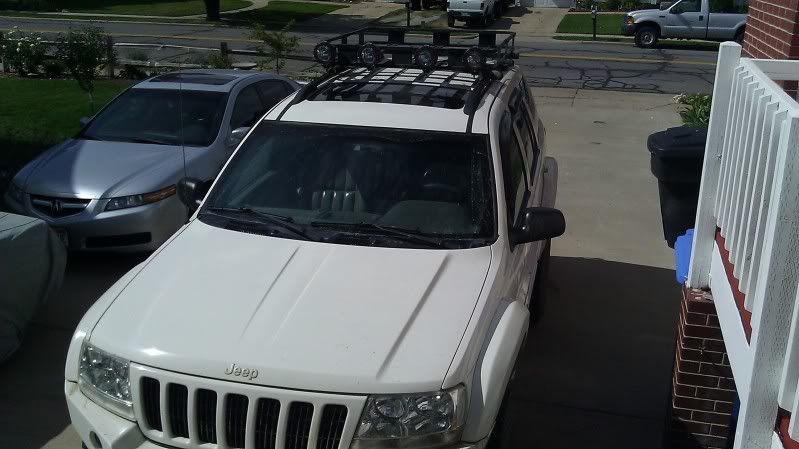

The light bars have been installed, and the lights are now on. Now I just need to run the wires and install the switch.
This pic shows them as they are bolted down to the main cross bar, and extending forward to the front of the rack:
This pic shows the top hat bracket that goes over the rack and holds the light bar up.

Looks pretty nice,are u getting any vibrations driving down the road?
rfjeeper is offline
post #236 of 796 Old 10-02-2011, 07:05 PM Thread Starter
85IrocZ-28
Location: Davis County Utah
Posts: 3,934
In reference to the lights up there, or something else?
I haven't had it on the freeway yet, but it should be fine. With those brackets, they are solid now. I drove over the curb and through some potholes to see how it did, they didn't budge.

Yeah i mean with the lights and brackets,just wondering how solid it was up there and if u were getting any kind of vibrations from it,i like the lights you chose,they dont seem to sit over top of basket like some others do but looks like you are gonna get a lot of light shining in cabin unless you keep sunroof closed.You might have to make some kind of shield mount under your lights if it becomes a problem.
rfjeeper is offline
post #238 of 796 Old 10-02-2011, 07:44 PM Thread Starter
85IrocZ-28
Posts: 3,934
I didn't want them to flop around at all, so that is why I made the extended bars to support them. I imagine it would be like looking at the sun with the sunroof open. When we are night wheeling, it will just stay closed so that doesn't become an issue.

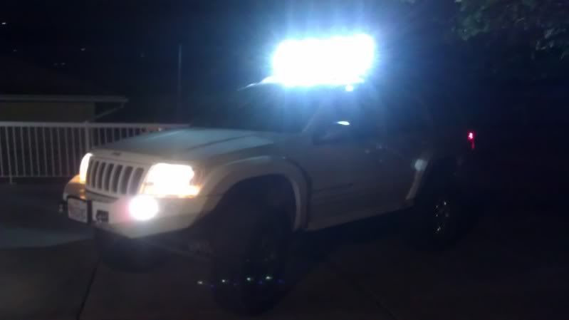

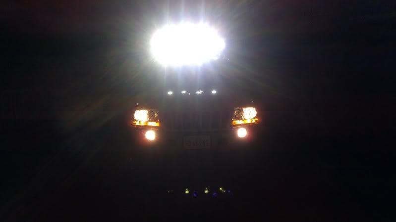

The HID's mounted on the roof rack are officially wired up and working! I was expecting them to be bright, but I had no idea how insane they would look. Four lights is probably overkill, they are blinding.
I bought the lights from CrawlerReady, Tyler is great to buy from.

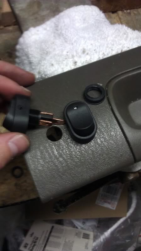

I mounted the switches on the panel above the steering column and below the gauges. It is a great panel to use for switches because there is a ton of empty space behind the panel.
I like how it turned out. The switches are accessible, but not obnoxious.
They make the headlights look like they are parking lamps. I am really impressed with HID lights.
