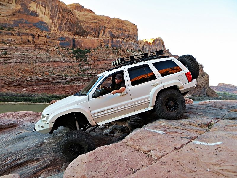

Here we go again...The ZJ was a blast, but it was time for a change.
Project Yeti earned her name as a monster in the snow, and because of her color.
CURRENT INFO
- 1999 JGC Limited 4.7 Quadradrive
- 6.5" Rockkrawler Long Arm Kit (three link front)
- IRO rear upper A-arm
- 315x75x16 Goodyear MTR's
- 16x8 MB TKO's
- 4.56 Yukon Gears
- Iceland OffRoad Front Bumper w/winch cradle
- Front Mini D-rings
- Rear 3/4 D-ring shackle
- Iceland Fender Flares
- Iceland 3/16 Steel Rock Sliders
- Akebono Caliper's with HAWKS pads
- K&N drop in filter (Now removed, and the TB is staying cleaner)
- Magnaflow (I think is a Magnapax, 4 inch round...I have run a Flowmaster Delta Flow 44, and Flowmaster 70, both not as good with the 4.7)
- Surco Roof Rack (the first few pics show the garbage rack it came with)
- VentShade window covers
- JKS Quicker Disconnects (my favorite addition to date)
- JKS Bar Pin Eliminators
- Transgo Reprogramming Kit
- Superchips Programmer
- KOR Transfer Case Skid
- HID fog lights on the roof rack
- LED rock lights strips
- Protofab Rear tire carrier bumper
- Re-located washer bottle
- Uniden 520XL CB
- Firestick 36" antenna
- LED tail lights
- Smittybilt 8K synthetic line winch
- 12 O'clock Labs SpeedoDRD module

The trimming didn't last too long, I decided it was time to purchase some stuff from Iceland OffRoad. Here is a link to the full install:
http://www.jeepforum.com/forum/f310/...ll-wj-1072703/
I had to cut the factory ones off with a big chunk of the bumper to prevent the tires from rubbing.
Here are some of the highlights:
It is just primed for now, but I will paint it to match later.
The front flares are now on.
The rear flares are complete.
