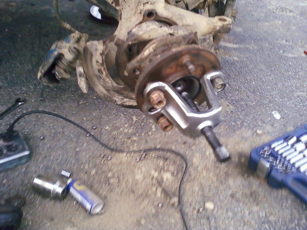

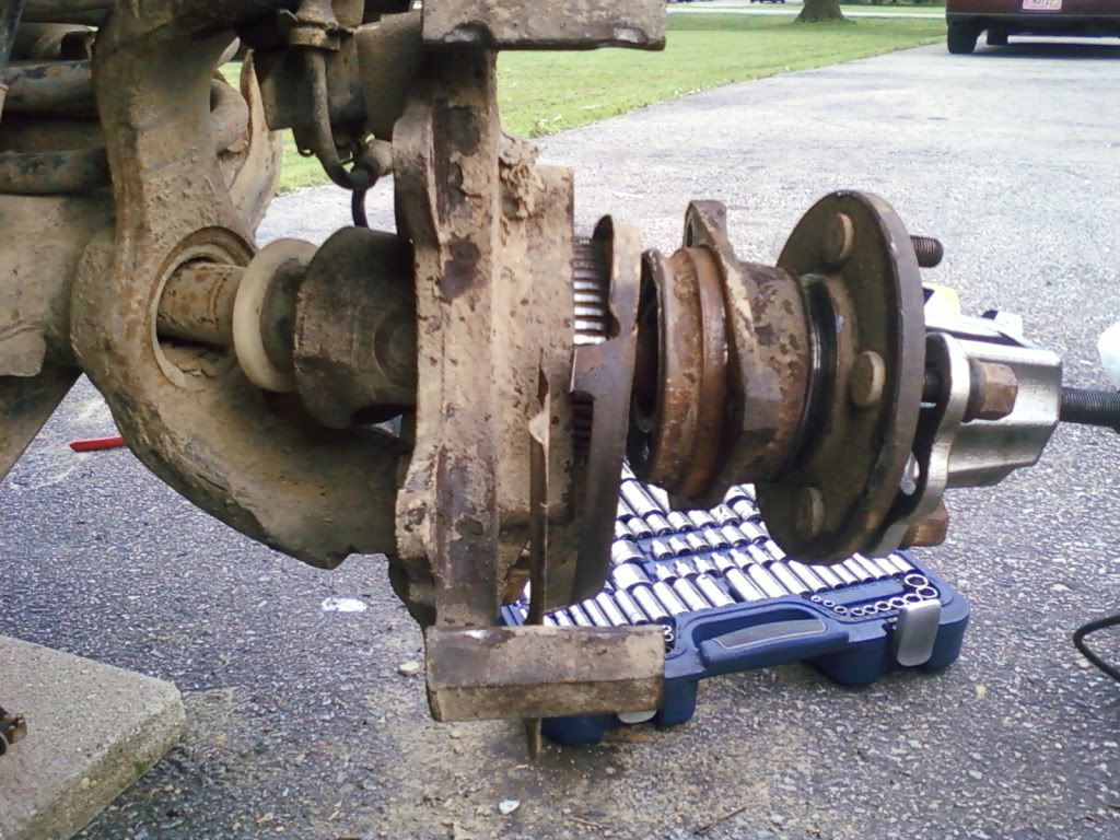

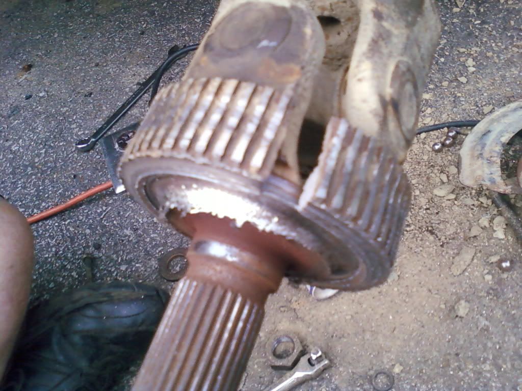

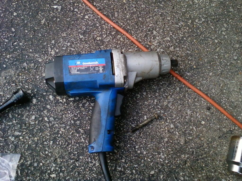

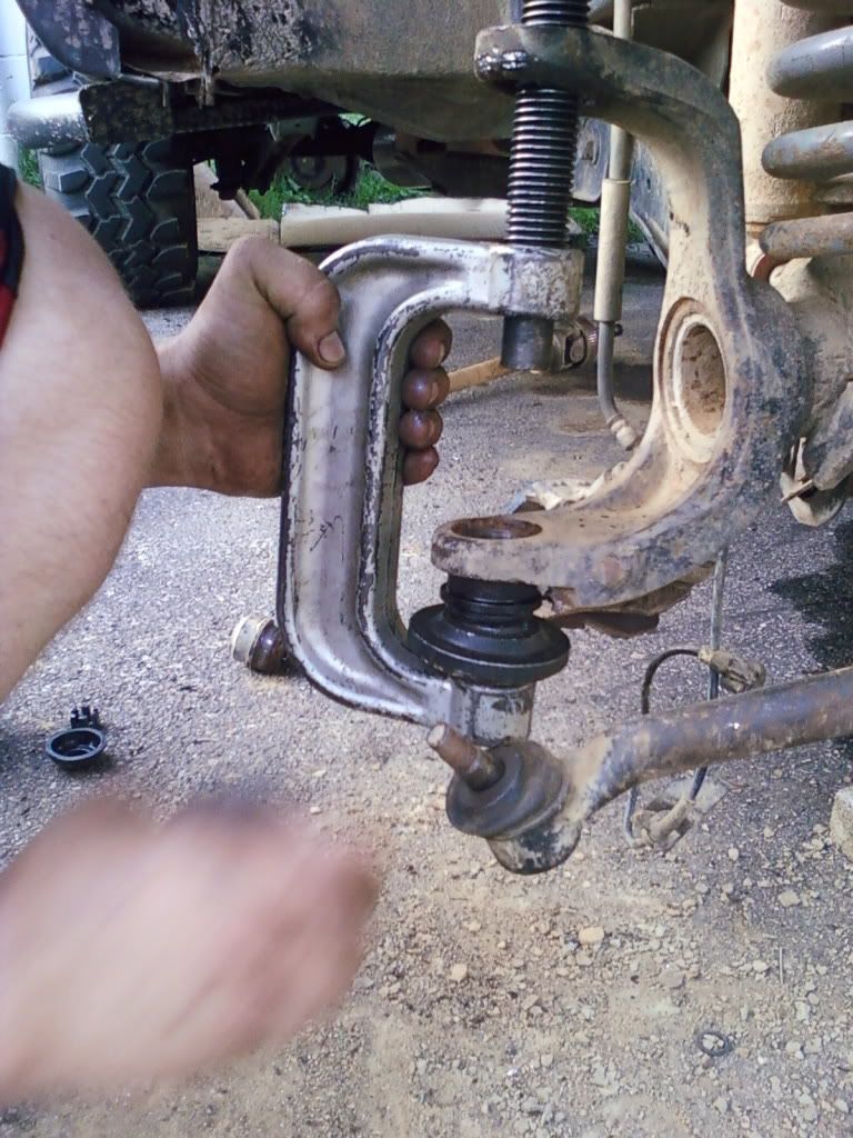

ok so today i started tearing down my front end to replace the hubs and uppper/lower balls joints. i borrowed this bad boy to break my axle nuts loose with.
so then the fun began. the passenger side hub is the worst i've ever seen, it took about 10 mins with this electric impact on a puller and numerous times of beating it with a hammer just to get it to finally break free. when it finally did this is what it looked like.
yep i think it's broke
so tomorrow i'm gonna pull apart the driver side and pull my diff cover and pray for no damage lol

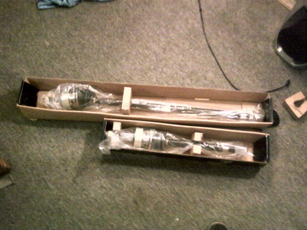

I had issues with CV shaft replacements before. The only place I could find one where the boot didn't want to rub against the hub assembly was from NAPA. Just a small FYI.
April '11 GCOTM
COLORADO JEEP CLUB #133
Irish_Assassin is offline
post #23 of 89 Old 06-01-2011, 11:19 PM Thread Starter
ZJ_flexxxer
1994 ZJ
Location: Louisville,Ky
Posts: 458
thanks for the input, i'll be sure and check these before i put them in. i got this set from oreilly's, not sure if you tried there or not

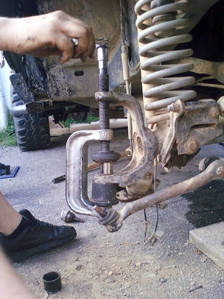

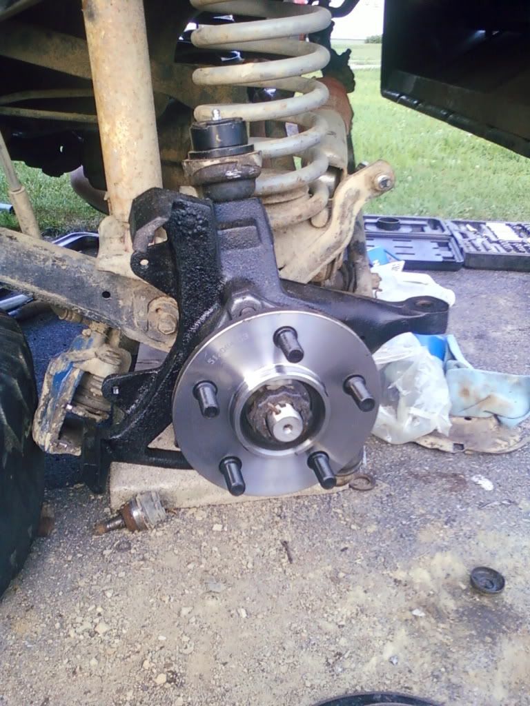

so i'm doing quite an update here, put on alot of new parts over the past week. due to some internet issues i wasn't able to update for the past couple days.

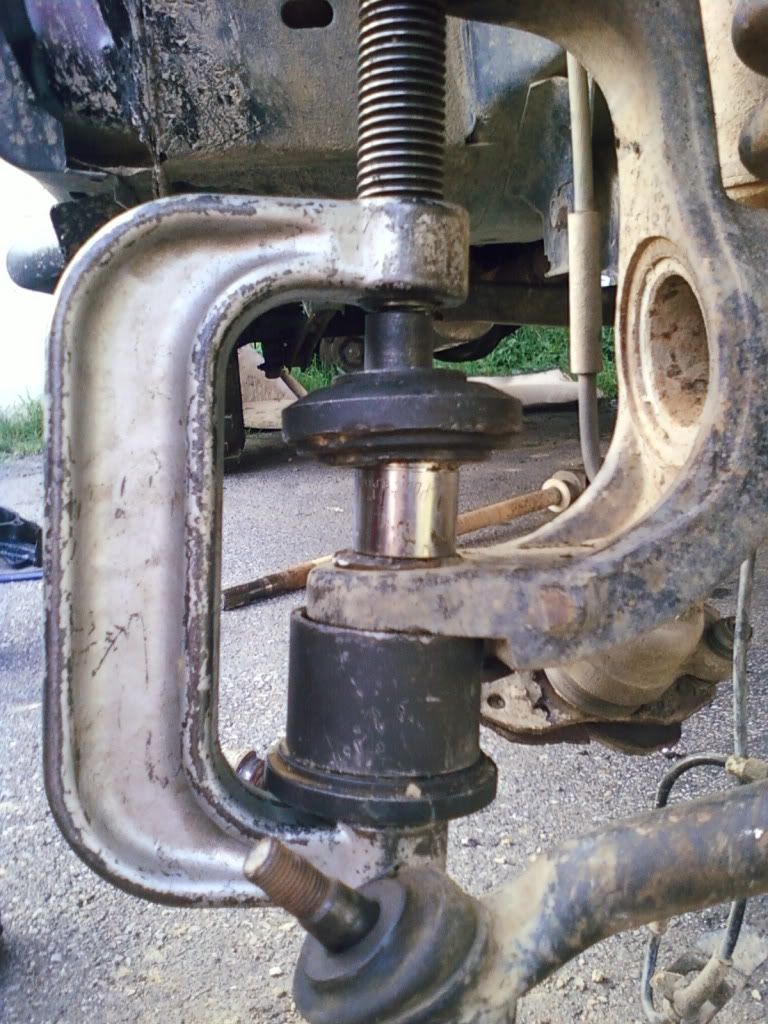

i'll pick up where i left off. i pulled the drivers side hub and then both spindles. then it was time to change the ball joints, at first it seemed as if it was going to be a hell of a job since the impact wouldn't even budge my old ones not to mention i wasn't 100% sure which way they came out. but after a little research and grabbing a 1/2" rachet and a cheater bar i finally managed to shove those rotten bastards out of there. the more i did the easier they seemed to get though. i did wind up having to use some sockets rather than the pieces that came in the puller/compressor kit, and this also goes much easier if you remove the top ball joint first because you can then use the top hole to run the tool threw.
and of course the new ones go back in just the opposite of the way the old ones came out
so here it is most of the way back together, new hubs are nice and shiny lol and i decided to go ahead clean up my knuckles and paint them black while they were out

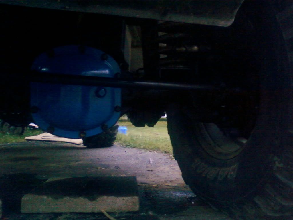

also went ahead and cleaned up and painted my diff cover while i had it off, 3 coats of krylon fusion and 3 coats of clear.

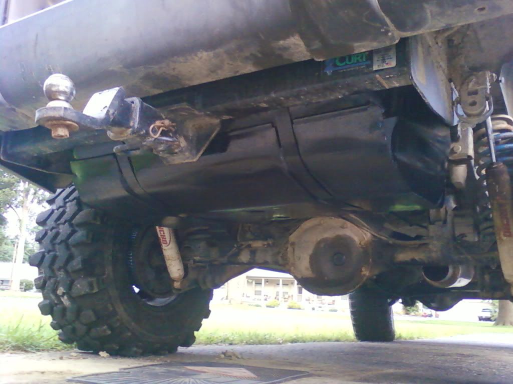

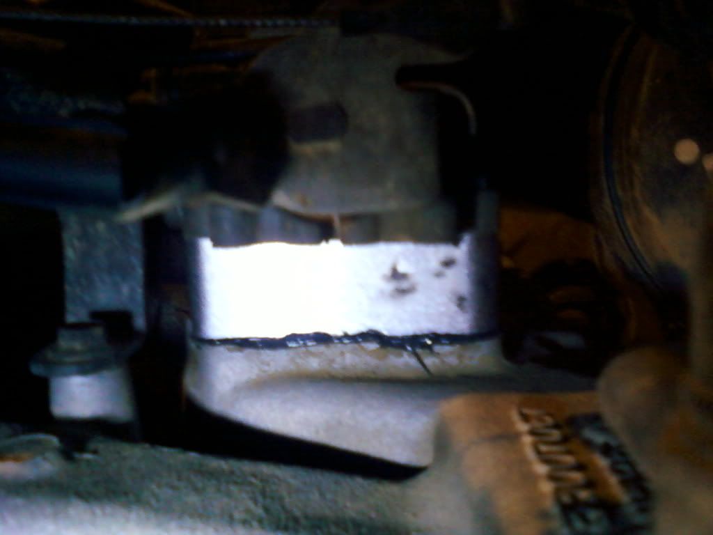

did a little modifying and made this gas tank skid work and got it mounted up today. i will say it's a ***** trying to get the tank and this skid off the ground high enough to get a jack under it all by yourself. i thought i was never gonna get this SOB back up in there and bolted up, but finally after alot of sweating and cursing here she is
yes i know my d35 is leaking a little bit, i didn't help much by spilling some all over it the other day while trying to top it off

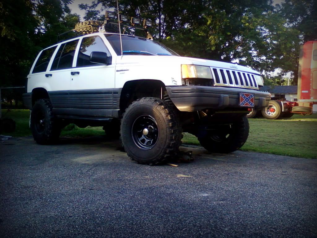

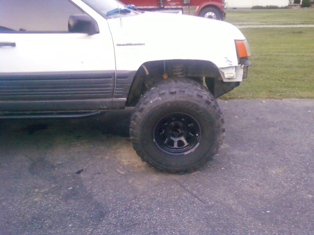

put my front bumper back on and i swapped wheels and tires

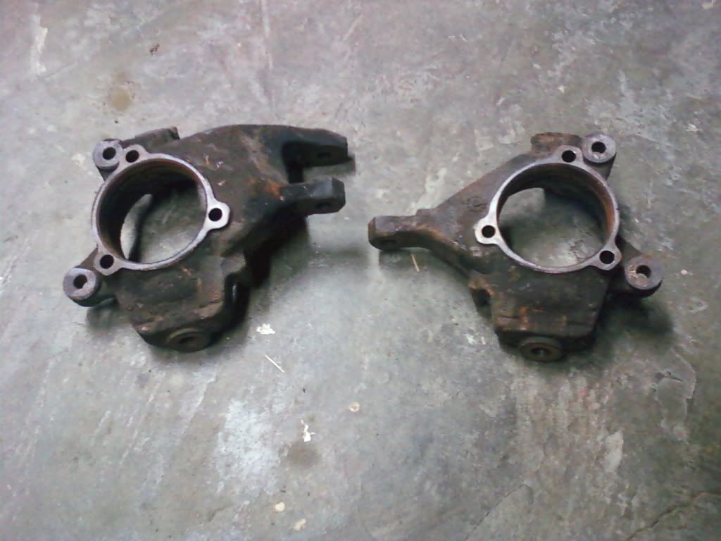

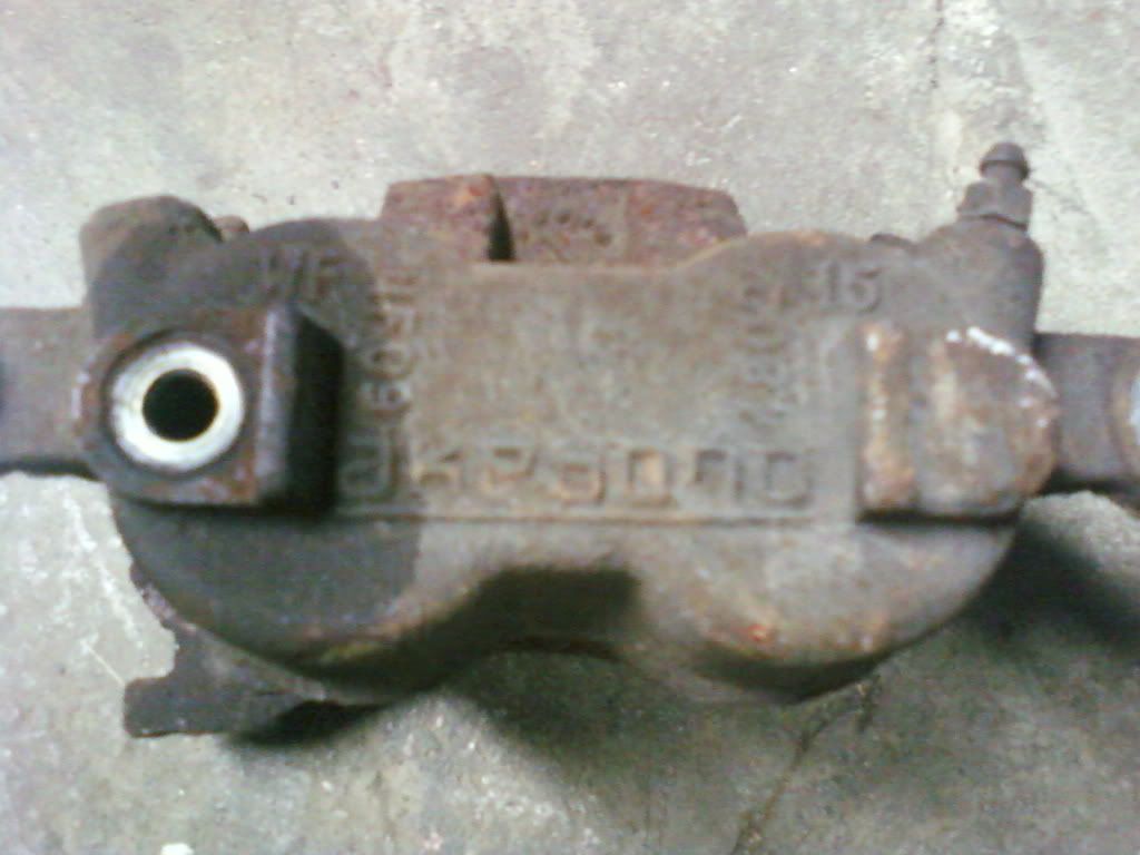

and today i snatched up some parts for the wj knuckle swap. here's the knuckles and i even got the akebono brake calipers winning!

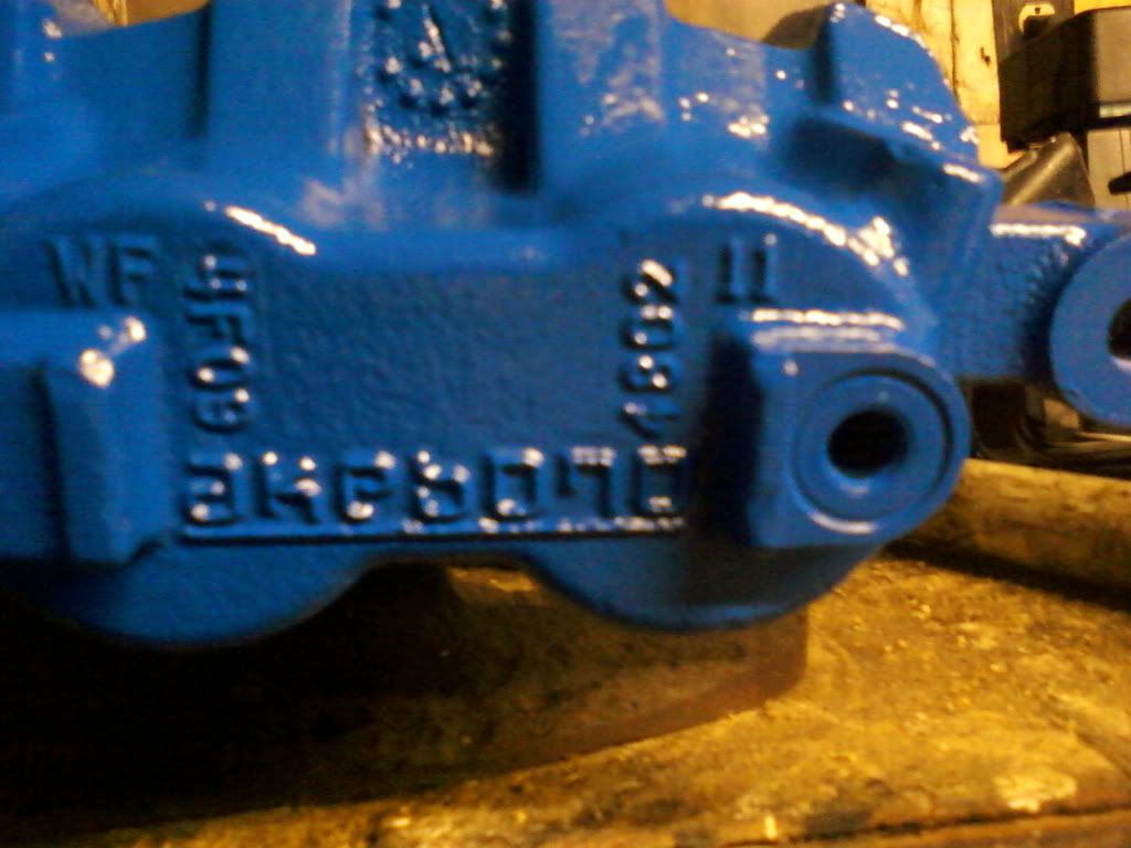

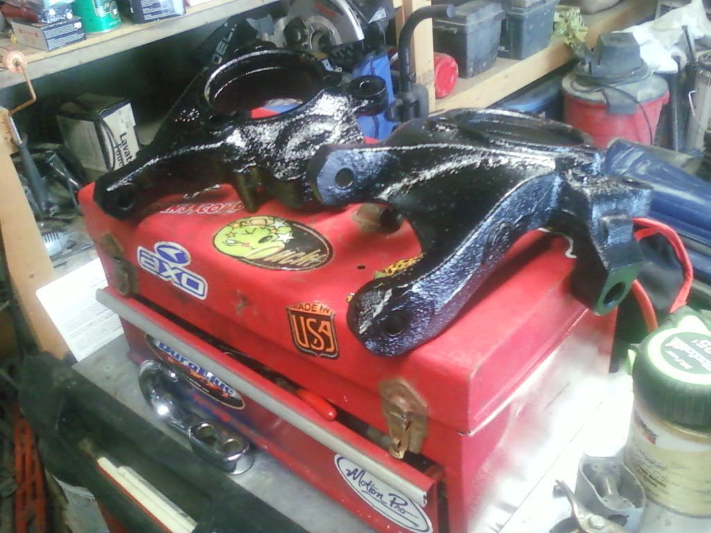

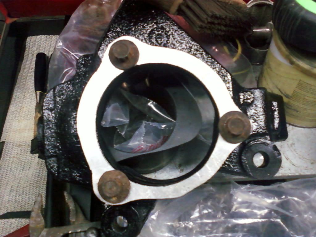

got the wj spindles wire wheeled and painted. also got the brakes wire wheeled and painted but it started to sprinkle rain outside so i'll finish up the last coat on those tomorrow.
also i went to work and made my own knuckle flange spacers. i took one look at the jks website and told myself there was no way i was paying $20 each for them. i used an old peice of 1/4" metal i had lying around and with my jigsaw,drill, and about 45 mins i saved $40.
just test fitting here, i'm aware that they have to be welded to the knuckle

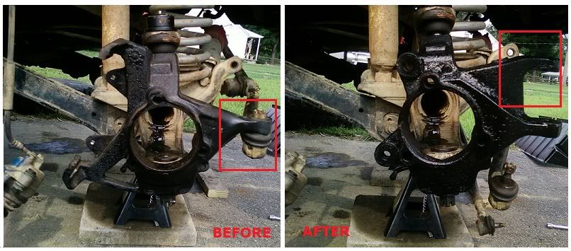

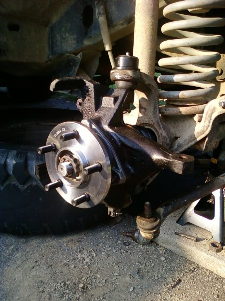

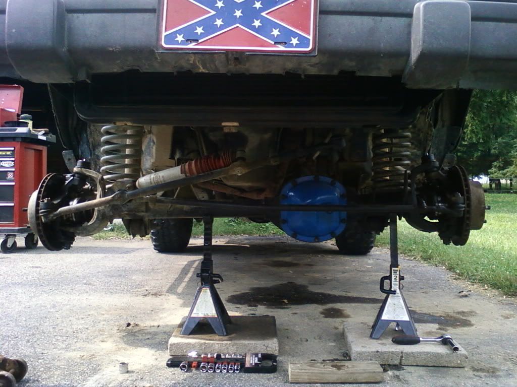

i started the teardown for the wj knuckles yesterday. snapped a quick pic of my front end to get a before and after shot. if your wondering why my jackstand are on stepping stones it's to keep them from sinking on the hot asphalt. i had one start sinking and almost fall one day not to mention leave about a 3" hole in the blacktop.
so here's an idea of the difference in the wj knuckles and the tab for the drag link. an easy 3 inches or more of clearance is gained. i'm not going to use the lower tab for the tie rod, i'm going to use the IRO heavy duty tie rod over to the drag link and i'm using the tapered sleeves to go over the knuckle on the tie rod and possibly the drag link if it's not too much work.

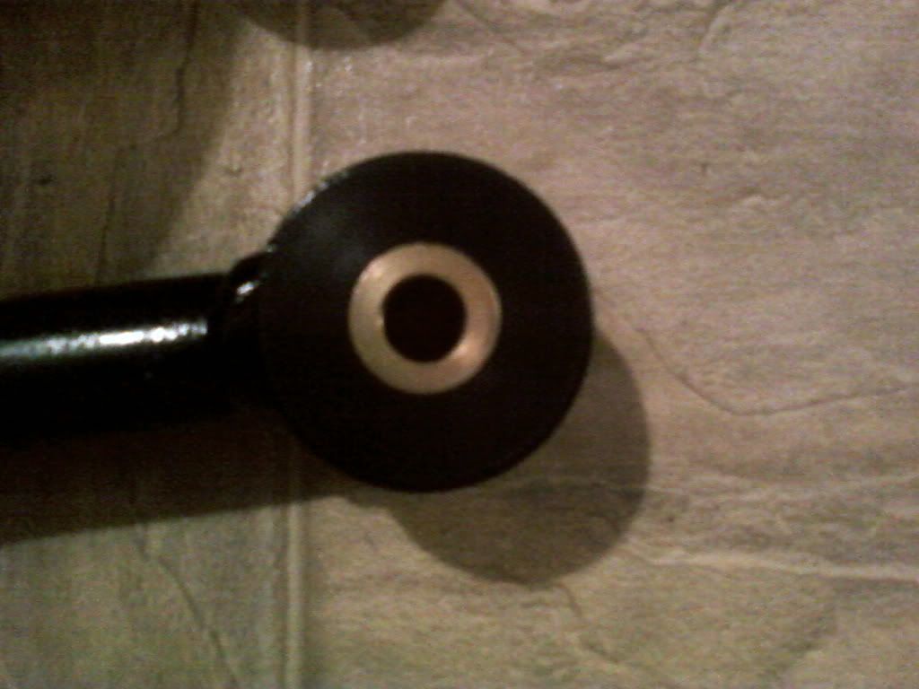

also have to give props to IRO for helping me out with these bushings. i had bought these adjustable tracking arms used without knowing the brand so it was a little hard for me to know what size bushings i needed. sent my OD and ID measurements to the guys at IRO and they confirmed that their bushings would work. big thanks for the help

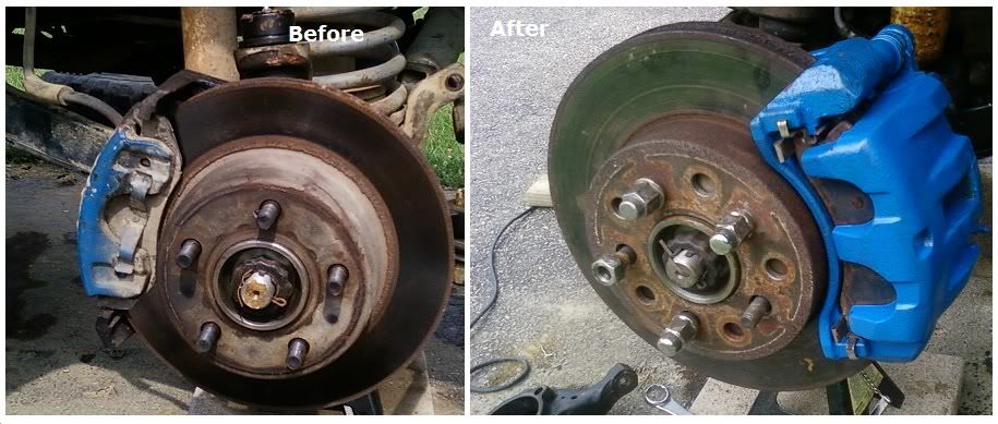

here's the stock brakes vs wj rotors and akebono calipers
my stock setup vs wj knuckles/IRO tie rod/over the knuckle. i wanted to put my drag link on the higher tab of the wj knuckles but evidently the wj drag link must be a bit shorter because i couldn't get it in alignment with my drag link on the higher tab. still a better setup none the less.
