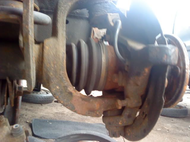

Here is a picture of what happens..

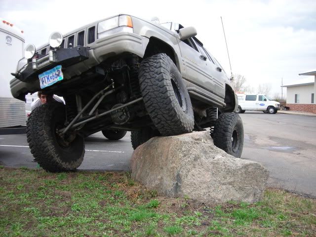

all of those pictures are with 35s right? where are the 37s?

Correct. 37's did not come until recently, I am trying to keep the build in order. According to this thread I do not have LA's yet, I will take pictures tonight of everything.

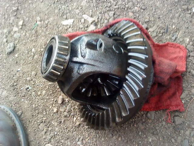

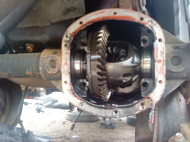

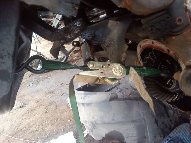

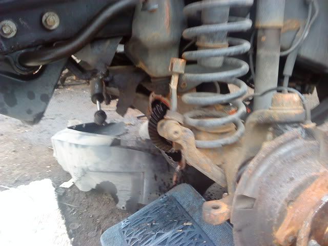

So I just got back from the junkyard, I needed to find a 3.73 and up Dana 30 carrier. There inventory only listed on ZJ on the lot, so I went straight to that. The axle tag was not present on the front or rear differentials, so I could not tell the gear ratio. So me being as smart as I was, I called the local Park Jeep dealer and had them run the vin. Sure enough, it was 3.73 ratio.
After I dealt with the SOB wheel bearing bolts, and got the bearing caps out, I had to pull the whole carrier out. As seen in the picture before, I used the housing spreader to pull it out. Once again, me being as smart as I am I remembered to pack a ratchet strap in hopes I could use it to my advantage.
One hook in the spiders, and the other on the front sway-bar. Worked like a charm!

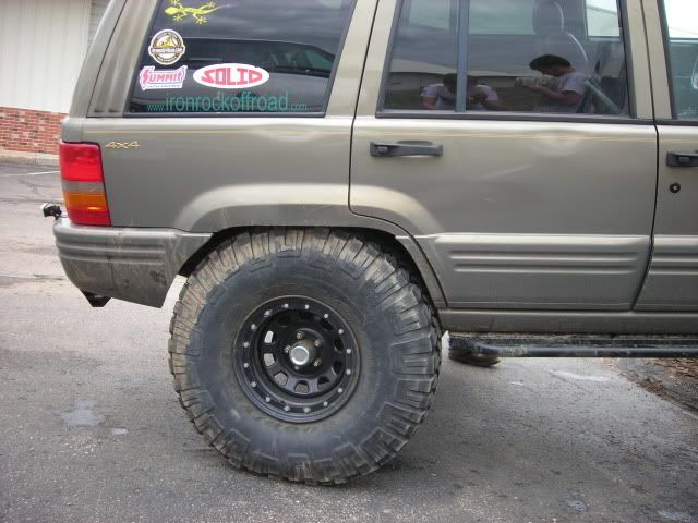

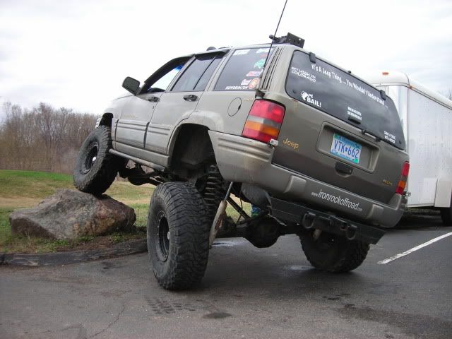

I did not do any more work on the axle tonight, but I did snap some pictures of the Jeep....Front swaybar still connected, I did not feel like disco'ing it so I just pulled up it quick for some pictures.
37's tucked son
Coolant and washer fluid draining out from sitting at the extreme angle of the harsh MN rock mountains.
