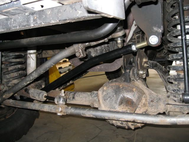

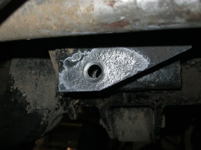

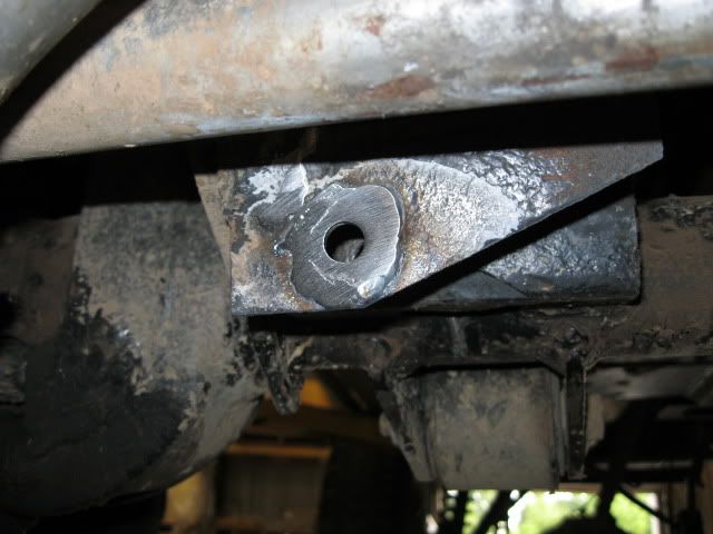

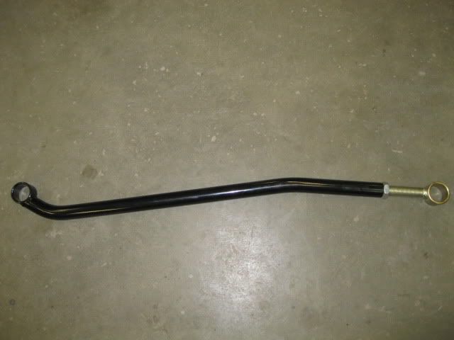

Well, I just did some recent work to the Jeep between last night and just now... Just got back in from the garage.
Last night I decided to convert my IRO HD Track bar, to a true double shear. What I had before was the HD track bar orig with tie rod end on it, and converted it to a double shear track bar with the M22 threaded end. I ran that for about a year, and now decided I would replace the track bar and all bushings. I dont like the way the Jeep rides on the highway, squirely.
Another problem I noticed, was slop was in the bottom bolt hole aswell. It was starting to oval out. So I wire wheeled it, welded a washer on it, ground it flush, and proceeded!

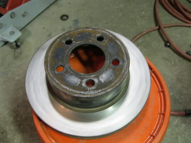

So I noticed my rotor had some scoring, and brakes seemed funny the last day or two. So I decided I would tare it apart tonight... check it out.

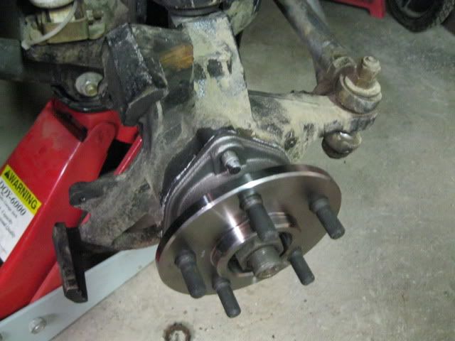

For now I just retorqued the nut, and I will see if it still drives alright, might need a new wheel bearing.
You were probably not too many miles away from losing that wheel.
Yeah I think you may need a new wheel bearing. That one is definitely a goner.

Re-torquing the axle nut isn't going to help you at all. You really really really need to put in a new unit bearing. I can't believe that thing would even drive down the road remotely straight! LOL When you put in a new one you will be blown away at how much better it drives.

retorqued it, and it looked and drove like absolutely nothing happened. No extra noise or anything, perfect. A day later I checked it again for safe measure, sure enough it came a little loose again.
Yesterday I was pulling into the parking lot and it started making HORRID noises. Hahah, then it stopped for a couple hours. Now, its horrible again. Jeep is parked until I get a new one! I think its still under warranty.

Well, you guessed it. Its under warranty. Decided to resurface the rotor too since it got grooves in it from the wheel bearing.
