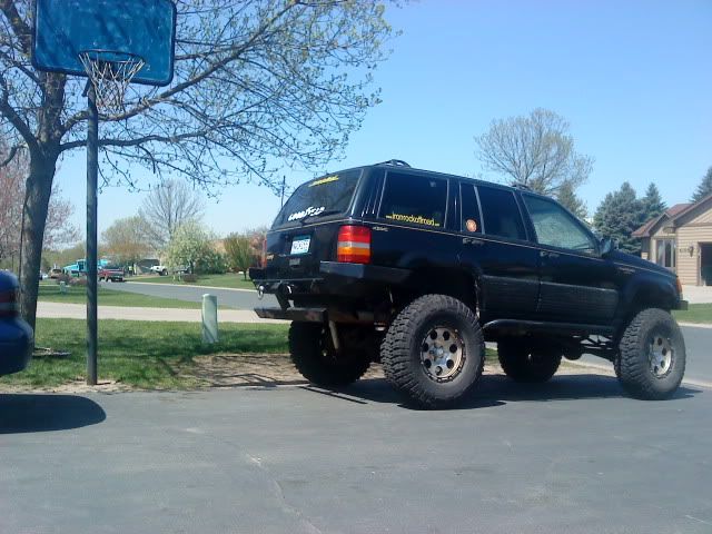

I just got home, and here is how she sits.
