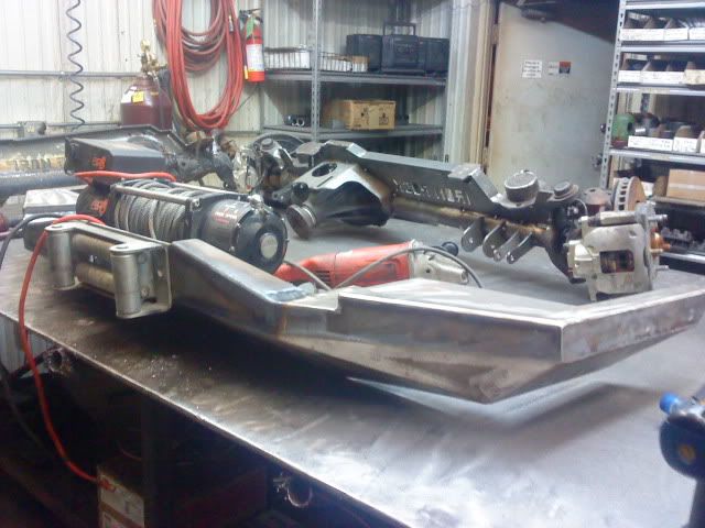

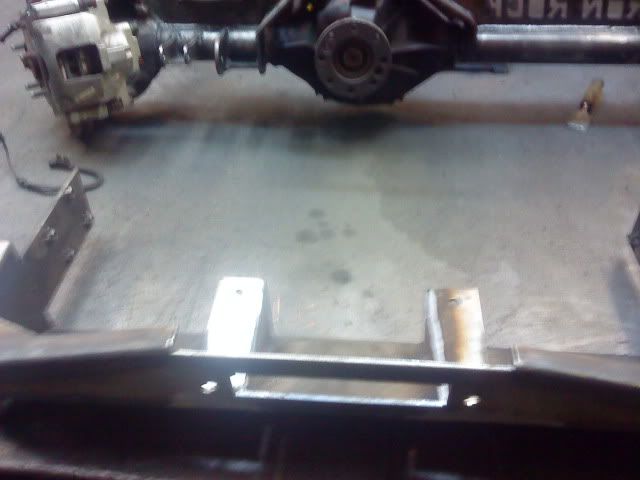

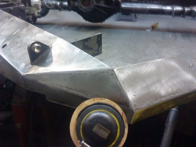

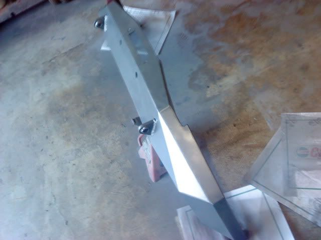

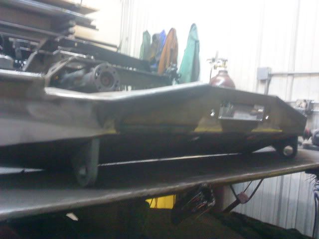

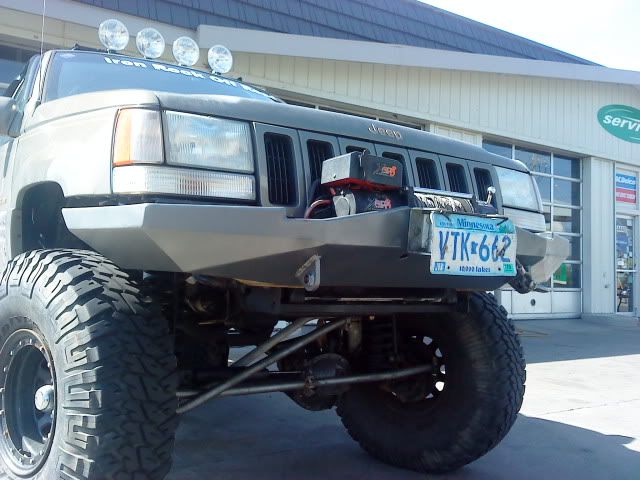

Okay guys, bumper is done and mounted. Here come the rest of the pictures. I just recently started trying a thing called "working out" and that has made my nights after work too late to go home and update this.
I did end up making a few changes to the design, by cutting up certain laser pieces. Some of you that made this bumper without a winch on it would not need to. I cut holes in the bottom plate, otherwise it is literally impossible to bolt the winch down, the bolt goes in from the bottom. Also, the winch would not sit far enough forward on the mounts because part of the front fairlead fascia was in the way.
Once again, cell phone pictures at work... Sorry guys. I will get some better ones once my cam is working again.
oooo JK Axle and sweet bumper

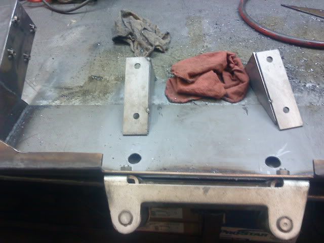

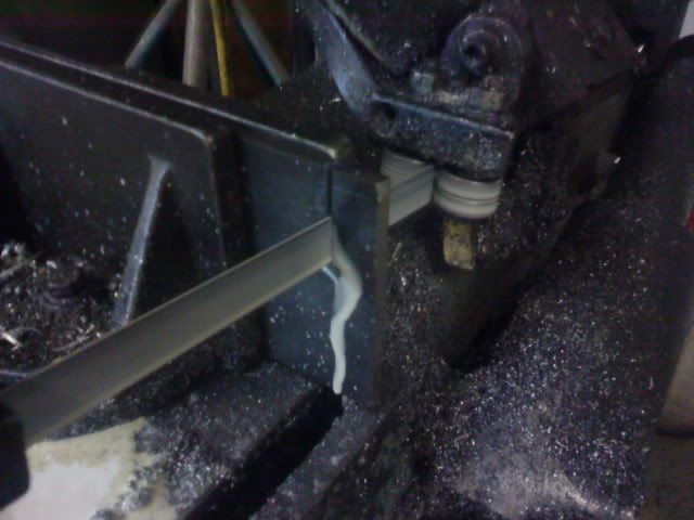

Cutting some little extra support tabs for the winch plate.... Also not in the design.

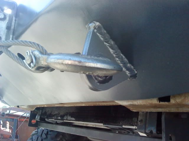

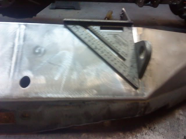

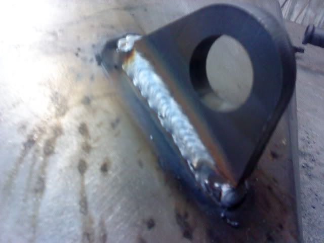

I wanted to put D-Ring Tabs on the bumper, because I cant necessarily access my KOR Radiator support that well anymore. I will be selling that too if anyone is interested.
These D-Ring Tabs are just a prototype right now, we do not have all the parts made. Its a half inch thick tab, and then you weld in a little tube that holds the D-ring to a tighter fit. We did not have the tube, so I had to machine it.
all tacked up.

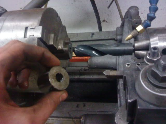

And now for the spacer, I started with a piece of 1.25" steel, that already had a pilot hole of 3/8". I then drilled out on the lathe to accomodate the D-Ring.
All made, faced off, and welded on.
After that, I prepped the part, and sanded the crap outta it with the DA sander.

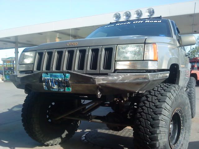

Since I could not fit the bumper in my Jeep, luckily it was nice out so I could drive my jeep home with the bumper on and not have it get hit with rain and rust out.
Finished picture coming in a second.... Ill go take one.

For now, my liscence plate will sit there, I am not quite sure where I will put it, maybe I will just get one of those bolt on fairlead mounts.
I put this on over the weekend, and you can tell its sitting a little low. I plan on using the forklift at Iron Rock to lift it up. I will loosen the bolts, lift the bumper up so its nice and tight, then tighten up the bolts.
Now before GSW I just have to get gears in the HP30, and 8.8. Also my Aussie in the rear 8.8....
