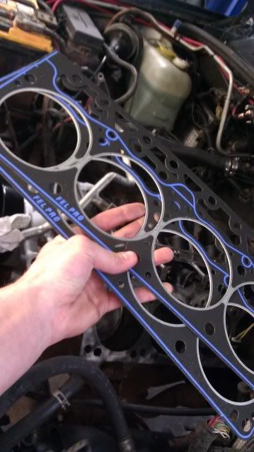

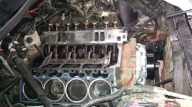

I pulled some plugs today and did some tests, diagnosed the headgaskets are bad. I cant say the timing was too bad, being I was going to tear half the motor apart this week anyway, I am going to have to do heads and gaskets now too... as well as fix the fan.
I think I will go with remanufactured heads, or just remanufacture mine. This would involve remilling the surface, and a valve job. Along with a visual inspection on the heads all around.
Make sure the heads aren't cracked while you've got them off. Magnum heads are known for this.
They were haha I already counted on seeing a crack between the valves.

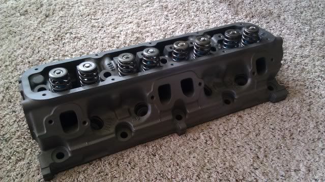

The heads have arrived

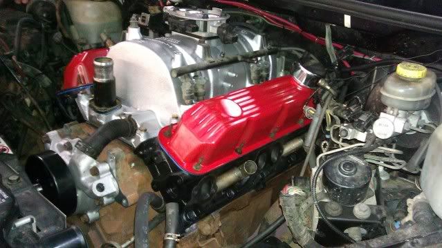

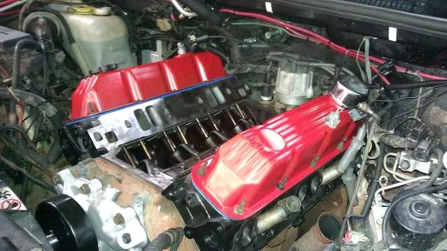

The heads, complete intake, water pump and valve covers are all on and tight. I was working on getting the headers on yesterday, along with the Y-Pipe but I am having trouble getting the headers on. I picked up some short studs to try and ease with installation. Also, I have yet to get the passenger side header even mounted in place, first I kept hitting the oil filter, now the stock UCA mount, I dont see how these would fit a stock ZJ unless you installed them with the heads off?

Are those the Iron Ram heads?
blackjack12982 is online now
post #97 of 417 Old 04-20-2011, 09:25 AM Thread Starter
redhatman
redhatman's Avatar
Location: Minnesota
Posts: 2,388
I wish.
Just reman stockers.. resurface, 3 angle valve grind, valve check, pressure tested, blah blah

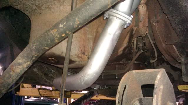

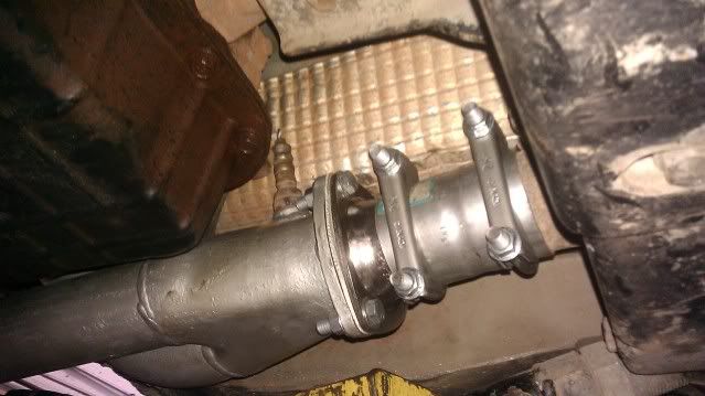

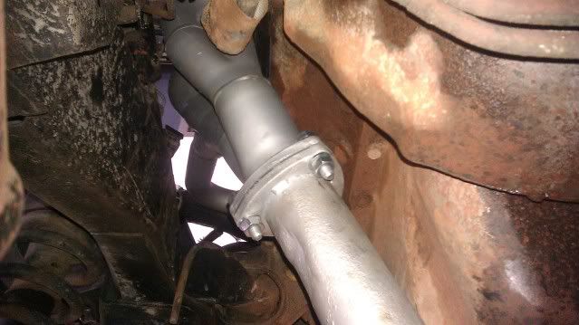

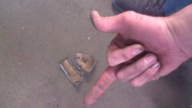

I got the headers on today.... what a *****. I ended up taking out the spark plug shields from the head, the oil filter, coolant reservoir bracket, and CUT OFF THE STOCK UCA mount. Now surely there has to be a better way to get it in, like say for a Jeep that actually needs those mounts? IDK but either way both headers are mounted and tight.
I am going to look into locking fasteners, I hear that header bolts always come loose. These headers look nice and all, but jiminy crickets there is hardly any room to work, and I dont know how you are supposed to actually torque the nuts. Half are tightened with what I felt was right, with a standard wrench.
I ended up using 3 1.25" long, 5/16" studs. Dorman #735-202 per side. Jeep should hopefully be running tomorrow! Just gotta put the rest of the accessories on, and also fab up the rest of the exhaust.
Note. I thought 5.9's had a factory 3" pipe? I guess not, mine is 2.5".

The 5.9s did come stock with a 3'' tailpipe, but just after the muffler, the rest is only 2.5" i think.
and i bought stage 8 locking header bolts, and gave up putting them together since its so tight in there, but i haven't had any issues with them backing off on either jeeps, i think it might just be an issue with the cheap headers and the thin flanges, because i know my friend with a chev and headers are always loose and leaking.

ahh, 3" tailpipe.... Yeah I was thinking about the headerbolts and was like how the hell am I going to get that contraption on here if I can hardly even get a damn wrench to the impossible nut on the 1/2 inches of stud sticking out....
in other news. JEEP.IS.ALIVE.

The clearance on everything is basically non existant.. the headers were very tricky to put in, and thanks to the Y pipe I now have a new oil pan heater, as well as my 02 hitting my tranny case. I am trying to seal up all of the flanges that are leaking still.

Looking good. (I know it's a pain) but what if you were to drop it again, and wrap it, also maybe just move the 02 bung alittle? Whenever i do exhaust I use "muffler weld" in all the flanges just to give it alil better seal. I also use band clamps instead of those c-clamps.
