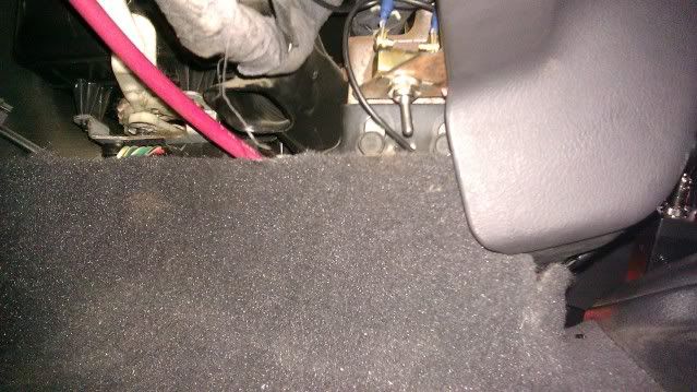

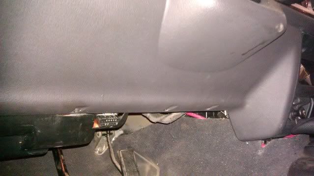

Well, I ran a new "solenoid s+ control wire".... This way I can leave the compressor switch on, and turn it on and off from the drivers seat. Here is where I put it, hid all the wires

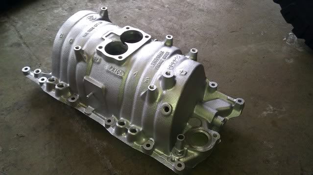

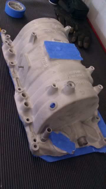

Onto the manifold.. Here is the paint I picked up for my intake mani and exhaust. Oh yeah, forgot to mention I have a set of Mike Leech Headers on the way :P
Taped off the mani

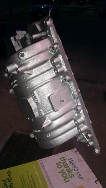

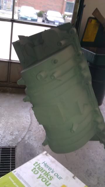

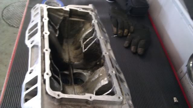

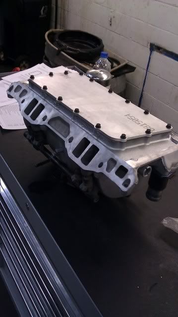

"Kegger Mod" Done to the Intake manifold. Intake runners cut and smoothed out. Supposed to provide better flow at higher RPMS.
Primer laid down
Silver applied..
Dried, and tape removed 14 hours later. Cleaned up all gasket surfaces again.

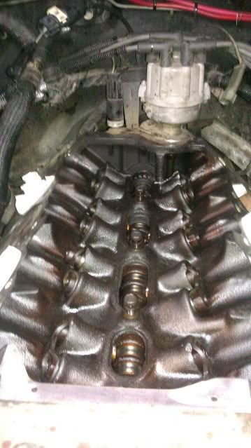

I pulled some plugs today and did some tests, diagnosed the headgaskets are bad. I cant say the timing was too bad, being I was going to tear half the motor apart this week anyway, I am going to have to do heads and gaskets now too... as well as fix the fan.
I think I will go with remanufactured heads, or just remanufacture mine. This would involve remilling the surface, and a valve job. Along with a visual inspection on the heads all around.

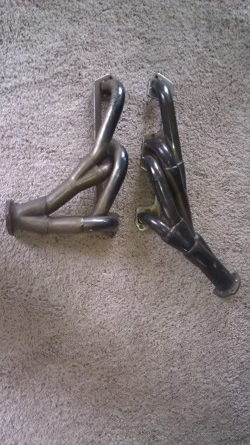

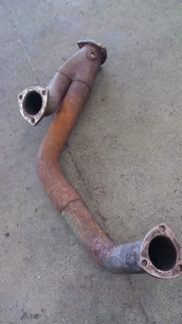

I took the advice and got some headers!
Y pipe all poopy rusty
Here is the intake mani that I modified, sandblasted, painted and swapped all of my parts over too. Also now has the Aluminum Plenum pan, so it wont leak anymore
The jeep is all ready to go back together, just waiting on the new heads to arrive. I ordered stock remanufactured heads. Meaning remachined, full 3 way valve job, new seals, yada yada yada. Decided not to do a new cam due to the price of a cam + springs + pushrods + tune... too much money for a college student right now.
