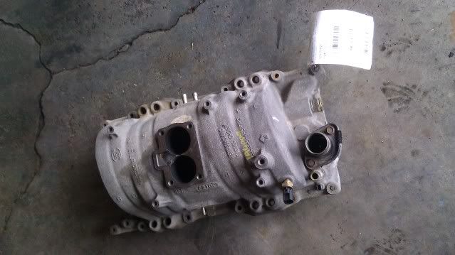

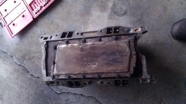

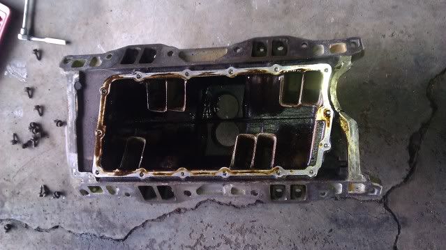

Intake manifold off of a 2001 Dodge Ram w/5.9

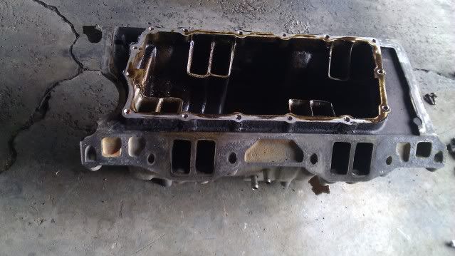

Gross, oil and water!
With this intake manifold I plan on doing the "ported keggar mod" which involves cutting parts of the runners off on the inside, luckily since this is off a later model truck the center runner is already gone. I took out all of the sensors and thermostat/housing, and just dropped it off at the sandblaster. Once its all done there, I will begin my work. I am going to cut out the certain parts of the runners, and smooth out all of the edges on the inside and ports.
I also ordered a plenum fix kit, which is essentially a new lower intake plenum pan, but made of aluminum. If you have a 5.2 or 5.9 and your plenum is not leaking, somebody elses leaked twice. The stock setup is a steel pan, bolted to an aluminum intake. With the heating and cooling, this gasket fails night and day. This causes oil consumption (I am consuming 1.5qt/1k miles) and pinging. One way to tell if you have a leak, take off the air hat and look down the throttle body. If you see oil, its leaking. The fix is to get the aluminum plenum pan, which will expand and contract at the same rate.
Along with this plenum pan and ported manifold, I ordered a 50mm throttle body. Its a true 50mm all the way through. In addition, I am going to throw on the throttle body spacer I have sitting here and probably order an airhat spacer too.
I guess you could say I am making over the intake part of my engine. haha

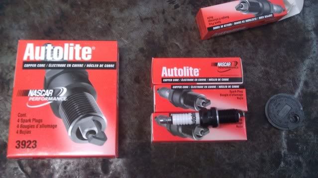

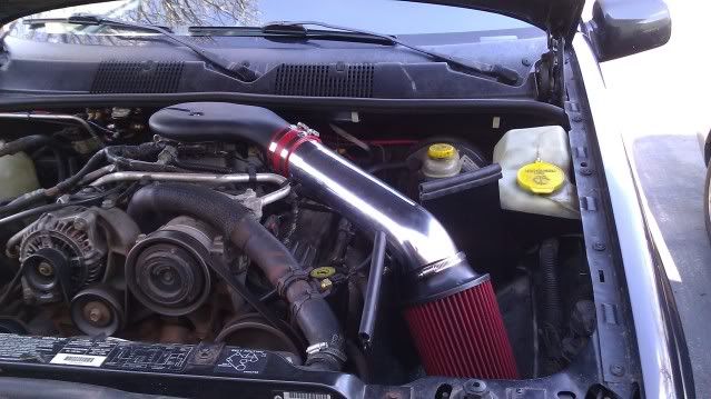

Update on the niner... Replaced the plugs I had in it with some Autolite 3923's, everyone swears by them. They are a copper plug, and one step colder than the stock plug. Less longevity but better spark.

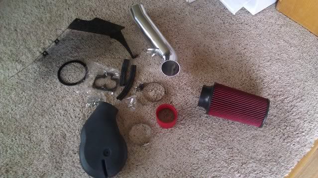

I also put in a whole new intake system... Found this kit online, so if you are interested in buying my old setup it is for sale for $30 shipped

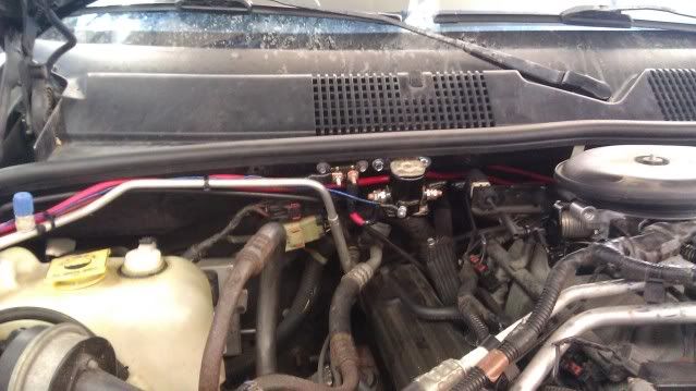

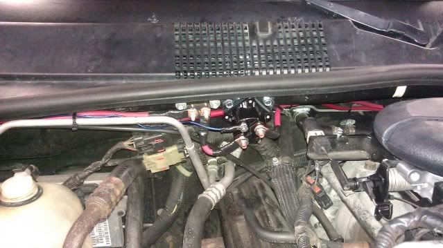

Well, as far as the Iron Rock On Board air system goes, as you know I got it mounted a while back, now its time to wire it. In their kit they include nearly everything you need to wire it up.
I ran 24 ft of 6 gauge wire to the back of the Jeep, completely hidden except under the hood. The wiring is as follows Battery+ -> 40A Fuse breaker -> Solenoid -> Compressor. I have the solenoid wired to ig +
-Pat

post #73 of 417 Old 04-08-2011, 02:43 PM Thread Starter
redhatman
redhatman's Avatar
Location: Minnesota
Posts: 2,388
Well for some reason I keep burning up the Solenoid. It lasts a few months, and then burns out again. There are two things I think could be causing it. Either A, the solenoid cannot withstand the initial startup amperage of the compressor, or B, having it wired to IG + would make it get tired from holding on forever while I drive around. I think it was B. However, since I had to replace it again yesterday I decided to use a 1998 Ford Exploder 4.0 Starter Solenoid. Costs me $14 at Autozone, 2 year warranty.
Best part is it bolts up to the holes I already drilled in the firewall for the previous one!
This is the fuse I had it hooked into for IG+ feed at the S terminal. I am going to hook it back up to here, but with a switch inline so in order to turn on the solenoid ig+ needs to be active, along with the switch -> ON.
