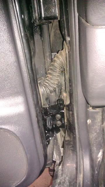

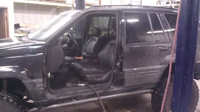

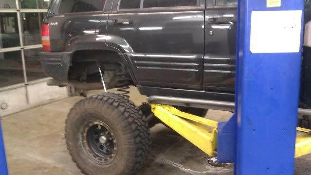

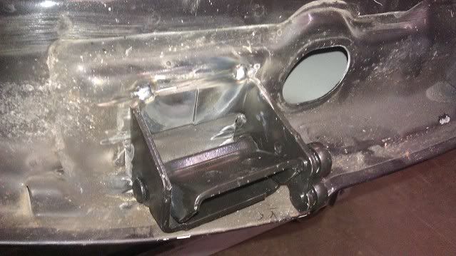

A picture of some of the suspension droop when on a hoist.
New wheel bearing AGAIN in the front passenger position.. The Timken "Good" one went out twice in 13 months. Yes, my axle is straight. Yes, it is gussetted in the tubes and the C's are straight. And yes, I torqued it to spec... they just dont last long with offset wheels i guess?

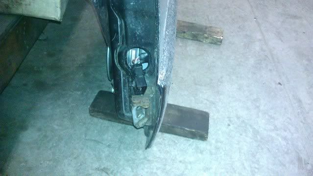

Door off for repair
-Pat

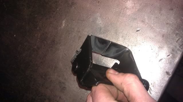

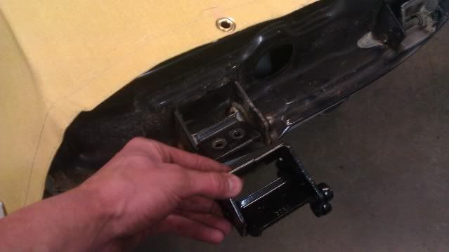

Just a regular day cruisin, shades on, doors off, music up.. 65 degrees....in the shop. Dammit february!

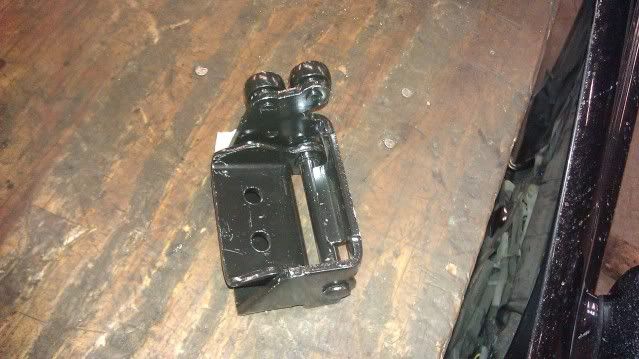

Bad hinge (lower one)
New hinge, needs to be welded on
-Pat

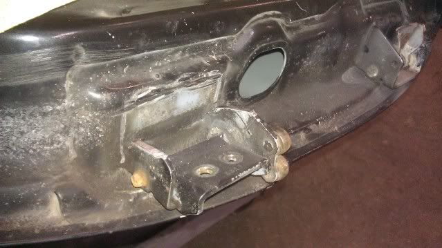

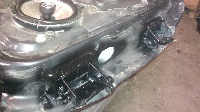

This is how I opted to do it, its hard to get a cutting wheel in there and get the whole hinge off in one cut, so I did it in a few cuts.
Old bracket off!
It is important to sand off the paint that comes on the new bracket where you will be welding to. I used a wire wheel on an angle grinder for this.
-Pat

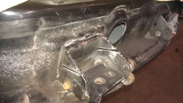

Tack the new bracket on, I like to refrain from grinding all of the old bracket off, because it helps a ton if you can still see where the old bracket was.
Test fit it, and if all works well, WELD IT UP WELDER!!!
....then primer and paint it. I was not too worried about paint matching because it goes virtually unseen anyway.
