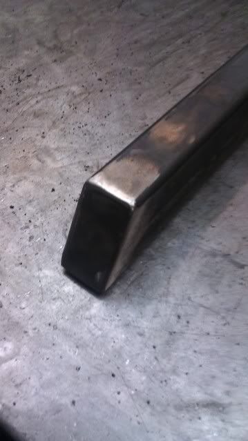

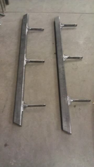

Time to build some rock sliders!

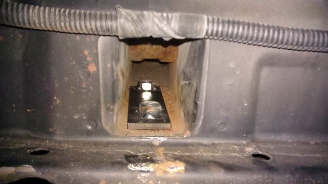

I started with the Main tubes....cut
Time to drill and tap some holes for mounting to the pinch
-Pat

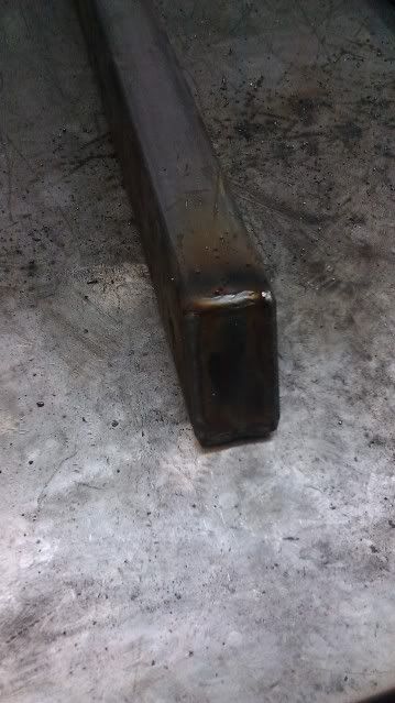

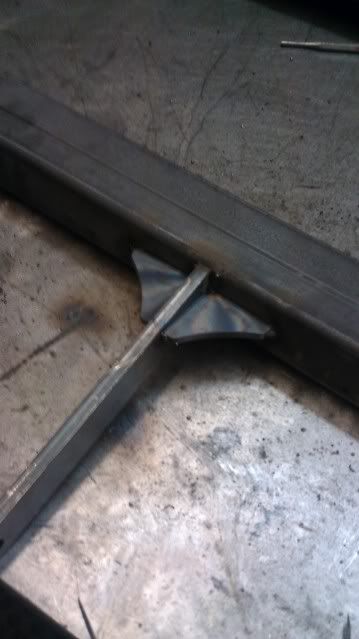

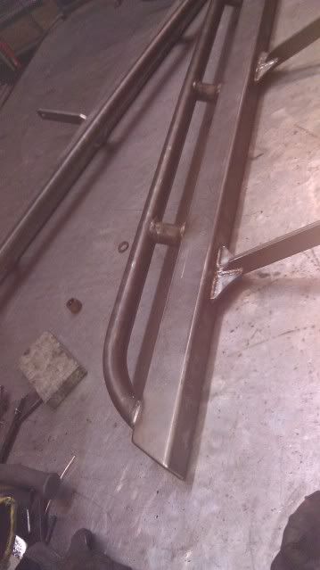

tacked some plates to cap off the ends
welded on
ground down, sanded

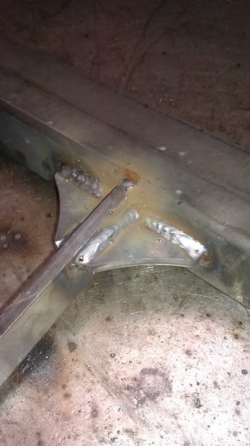

kickers, and gussets in place
Welded

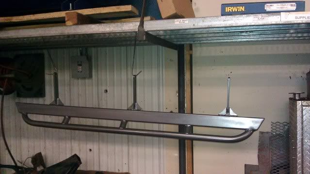

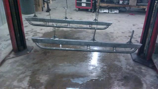

Bent up some outer rails for them, welded those on too
Sprayed down with brake cleaner
Primered
And Painted "Graphite" to match the front bumper. Its a dark, metallic grey.
Oh yeah.... about the front bumper Got the custom plate mounted too!

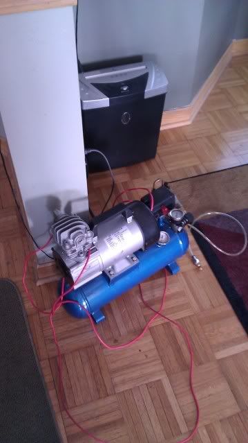

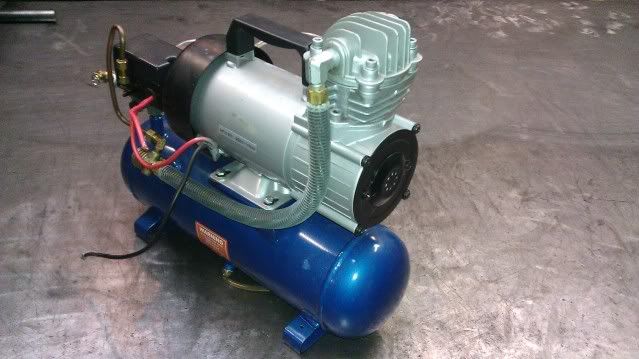

Time to mount the Iron Rock On Board air system!
Its not necessary to mount it down to the floor, but I would highly recommend it. Since you are hardwiring it in anyway, you might aswell bolt it down too. The first time I mounted this I traced the bolt pattern on the carpet of growaset, and drilled the holes. Bolts through the top, nuts on the bottom. Worked great, but was a PITA to do. This time, I opted to weld some home brewed tabs on, and then self tap it through the floor. Still WAYYY strong, and a valid tiedown point for cargo, but it went a lot faster. Then, for the ground wire I just sandwiched it on one of the tabs when I put the screw through the floor. I will get better closeups of the mounting later.
The tube hanging out there is a remote drain tube, if you have an air compressor you know you are supposed to drain them after using them. This IRO Kit includes the line and everything so you can drain the water not on your carpet, but outside of the Jeep.

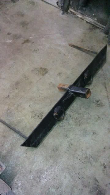

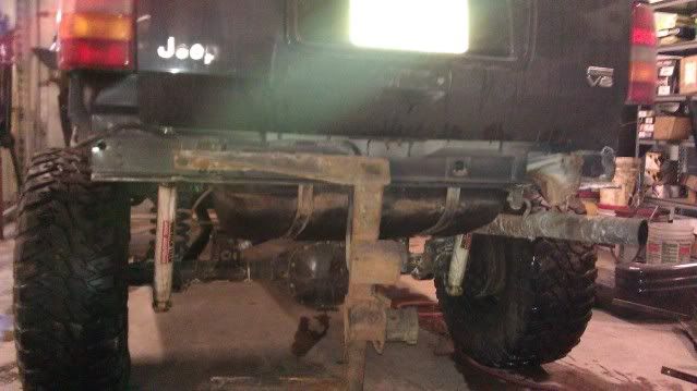

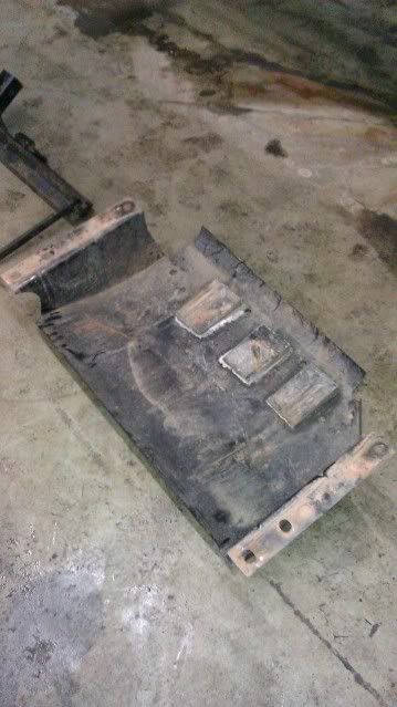

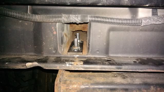

Next two projects to mount up, the drop bumper (for mn law) and the gas tank skid.
When I went to pull off the hitch from the dirty princess, she gave me 4/6 bolts. The other two were on the drivers side, and the nut was just spinning on the inside of the unibody. So, off with the rear bumper. I was able to cut in between the unibody and the hitch, and get the hitch to drop down. I then pulled out the factory nutplate, and junked it. Instead of welding the rusty nuts, back to the rusty, thin sheetmetal, I opted to make my own nutplate quick.
Antiseize applied, and bolted up! Perfect!

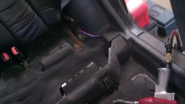

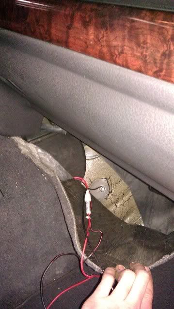

and, another picture of the wire hiding job for the sub/amp wiring.
Thats all I have for today. Does anybody want any pictures of anything in specific?
