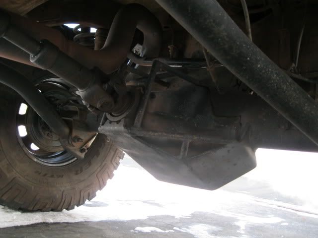

I bought it from a friend like this.
7" Iron Rock Off Road Front and Rear Premium Long Arm Kit
Trussed up rear 44a
Hack N Tap SYE Kit
Skid
242 TCase
1/2" OTK Steering
Soft 8 Wheels
35" (x12.50) Goodyear MTR Tires

The past 2 weekends I did quite a bit of work on the Jeep... I had an exhaust shop get rid of the factory Y-Pipe crimp, and replace it with regular pipe, crimp free As most of you know, the factory exhaust bottles down into a beautiful factory crimp coming right out of the passenger side header as it goes past the oil filter. Here was the solution.

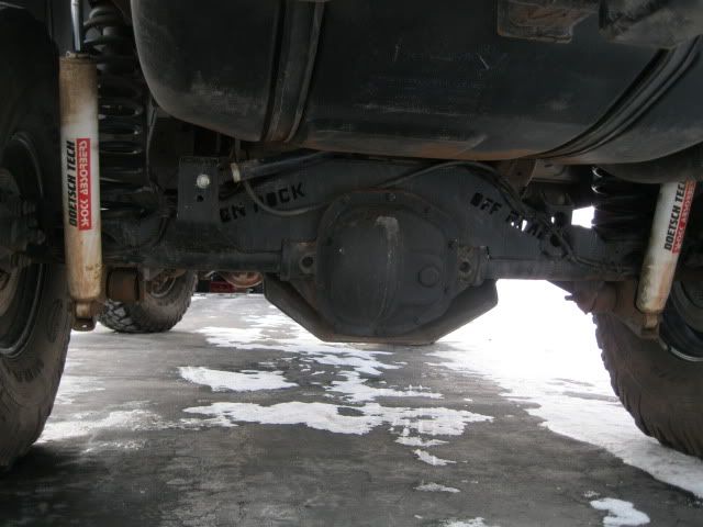

2 weeks ago, with the help of a coworker, we swapped some new axles under it. I grabbed the axles from project grow-a-set, and put them in. The front axle is:
HP30
U Joint front shafts, Spicer 760 Solid U Joints, Caps welded over (IRO Almost Alloy Tabs)
IRO Internal Sleeve kit
IRO C-Truss kit
IRO HD LCA Mounts
IRO Over the Knuckle (OTK) Steering setup, 5/8" version
4.88 gears
Solid Cover
Stainless, extended brake lines
With swapping this, I also swapped in the rear axle:
Ford 8.8 from an explorer
New brakes
4.88 gears
Aussie Locker
All IRO Mounts
Hack N Tap, SYE Kit.
