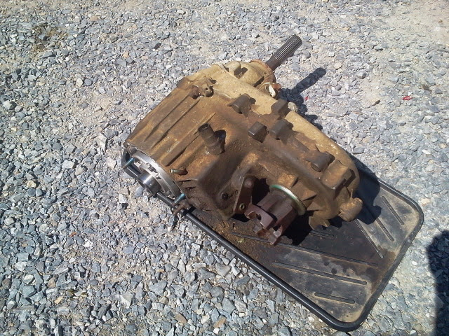

so i haven't posted this yet but last week my buddy and i did a NP242 swap in my 5.2L V8! it took us roughly 10 hours to do! alright here are some pics.
this is the NP249 that we pulled out. it had some mud on it.
this is the new (to my jeep atleast) 242!
what i didnt get pictures of was swapping the input shafts. the 249 input shaft into the 242 tcase. also the speed sensor out of the 249 into the 242. i was lucky and my 249 was a 1995 tcase so the 96 242 gear cut was a match! put it all back together and now there are the final details the select track bezel! we also found out that the difference in length was a 1 1/2" longer! so we had to shorten the rear driveshaft about 1 1/2" so that it could fit.
