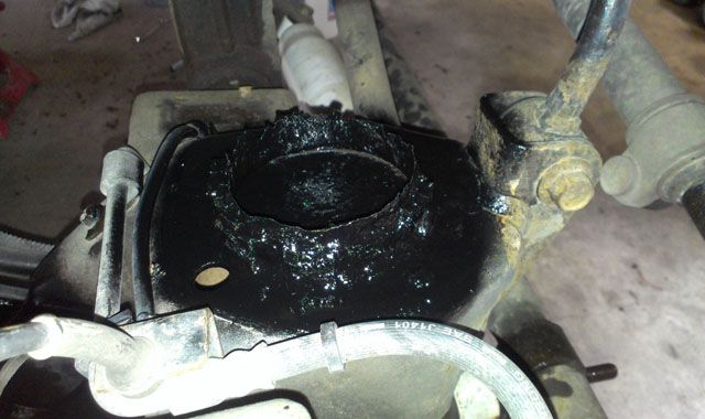

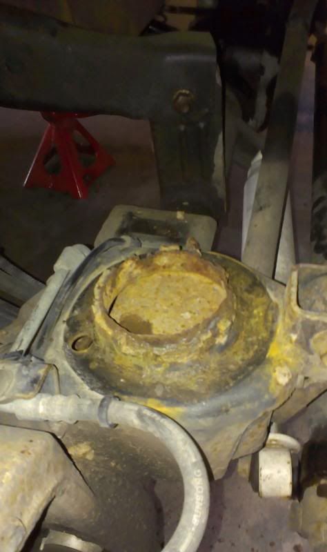

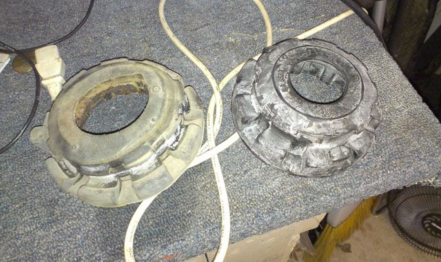

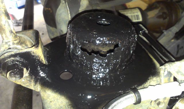

So I get the crusty isolators off to find out the passenger side no longer has a top...
I cleaned it up anyway. I don't have a welder and I'm planning on an axle swap before too long anyway, so I'm not too worried about it.
The driver's side wasn't much better.

So, I got the upper arms in and left them a bit loose so I could torque them at "neutral stance." I got the new isos on and springs in without too much issue and put the wheels back on. MMmMm, much higher already...
As bad as my isos looked and I probably needed to replace them, it didn't net me any more inches all said and done..that to come...

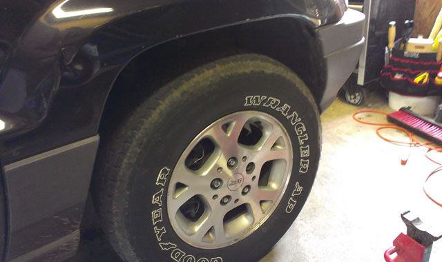

So Here's one before pic of the passenger front tire..
A whole 18 1/4" high.
I didn't take any real good before pictures, but I think we all know how low these standards get... 9I mean, non up-country, etc..) especially at 207k and 14 years old..

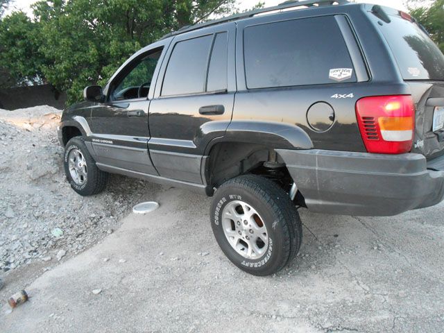

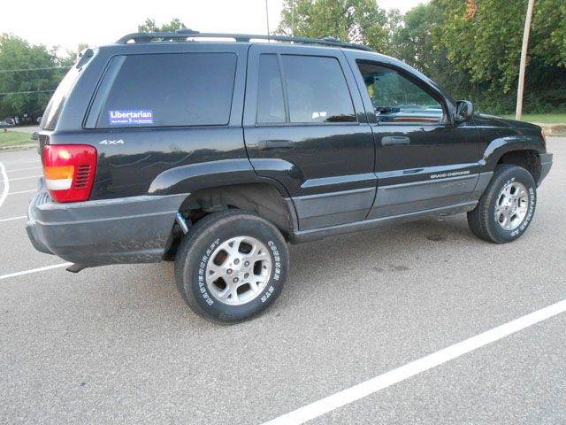

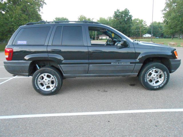

So without further ado.. here's some pics of the final. Rear disco'd (boy is that ever a new driving experience! talk about aRTicULaTion! actually it wasn't bad. Definitely different though.)
I started with 18 1/4" in the front and 18 7/8" or so in the rear.
I ended with 20 1/2" in the front and 21 3/4" or so in the rear.
It's amazing how only 2 inches makes such a HUGE difference. It's like...before I just "got into" my Jeep. Now I get up into my Jeep.
Boy I tell ya, even disco'd in the back it's night and day. Bumps are recovered from immediately. No bounce. LOVE that.
