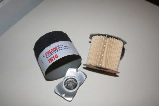

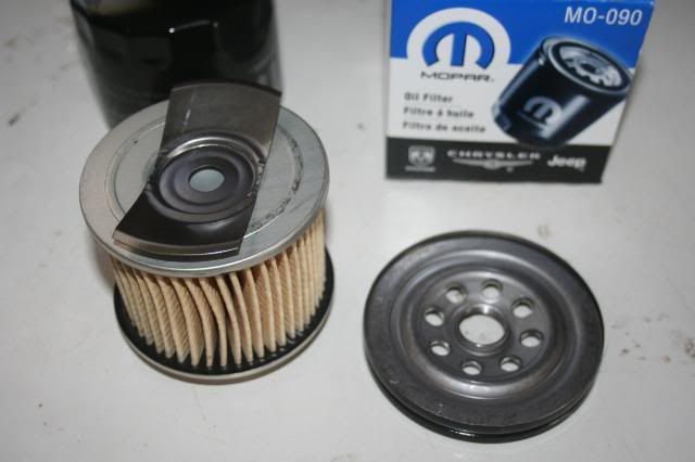

There is hardly a difference in the Orange & Grey Fram filters. They are bothe cardboard on the inside! At least the Mopar uses metal end caps on the filter media.
Then notice the Wix & Amsoil use coils springs for better ADB valve sealing & it will keep the filter from sticking in By-Pass mode.
Then on the Amsoil filter, note the synthetic media and How much bigger the ADB valve is. There is a difference, as you can see here.
