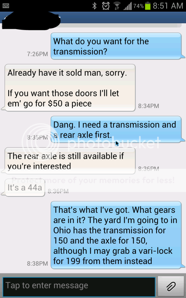

Unread 09-26-2013, 07:08 PM   #645
narnwv
Moderator
narnwv's Avatar
Location: Cross Lanes, WV
Posts: 6,312
it's a screenshot of a conversation Justin_WJ and I had when he started parting out his WJ.
~Aaron
