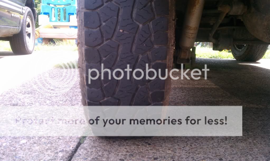

lack of rotations, bad wheel bearings, bad allignment, lots of factors can cause cupping. nice jeep btw

They look new for being used, honestly. Mine don't look that new, as in your first pics, and I've only put on maybe 7-8K at most since I got them a year and a half ago. They're excellent tires so far. I've no idea on the tire wear issue though. It's not something I have experience with.

Originally Posted by narnwv View Post
I'm not saying it's the tires. I wouldn't give anything used by someone before me a bad review. They seem like super nice tires, the front ones are perfect. I just want to find and fix the issue.
To clarify, they were $50 EACH--so $200 for the set.
I have actually not checked the pressure yet, but in my experience, you get even wear in the center of the tread, or outsides of the tread, not really the checkerboard wear.
It's gotta be something with the Jeep. I have a hard time believing that there were 2 bad tires, and they both got put on the rear axle. Especially when the front tires are damn near perfect.
I agree the odds of them both being put on the same axle, not likely.
maybe just rotate them fronts and rears. i find it very weird that the rear of all places are presenting that wear pattern. id expect it from a front.
if you find the problem def let us know the source to this mystery.
I do have a low-speed whine coming from the rear, which I've assumed ws my rear wheel bearings. It's been there for a while though. They're on the rear, so I doubt an alignment would help. Thanks for the compliment!
Agreed. That's why I jumped on them. They even still have the little "needles" on the sidewalls.
I agree with this, and later today will be swapping them front to rear to see. If it starts happening to those, I'll know it's not the tires, but something on the Jeep.
~Aaron

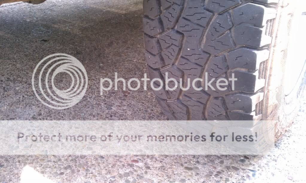

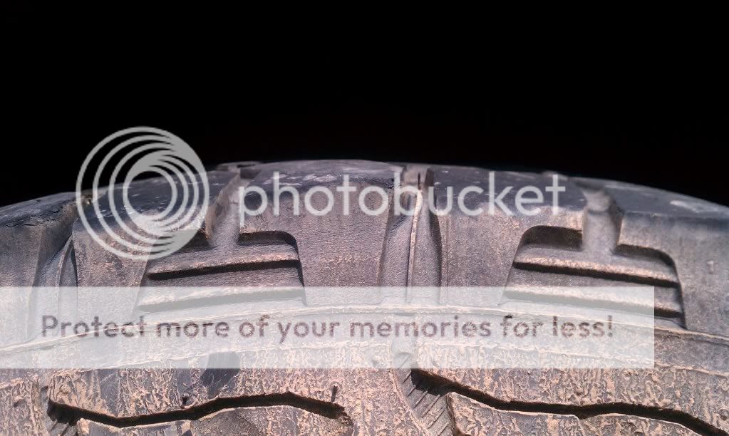

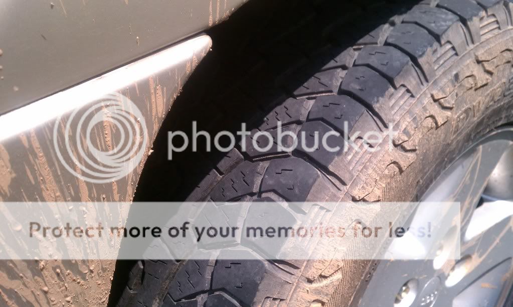

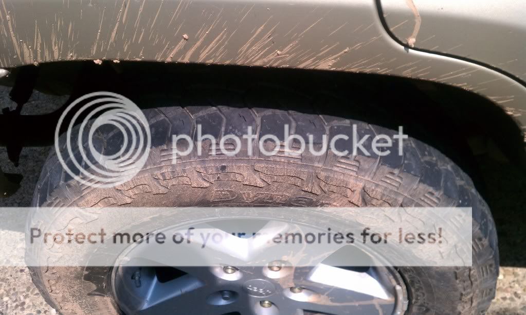

post #86 of 763 Old 08-28-2011, 12:14 PM Thread Starter
narnwv
Moderator
narnwv's Avatar
Location: Cross Lanes
Posts: 6,417
Well, still haven't done a chalk test. I'm not even sure that will help diagnose this, as it's not an over/under inflation issue. It's obvious where the tread is hitting the road. I did swap the two tires left to right as someone suggested, and the results are no different.
Here are some current pictures....
You can really see in this one how every other tread lug is being rouded...
~Aaron
narnwv is offline
