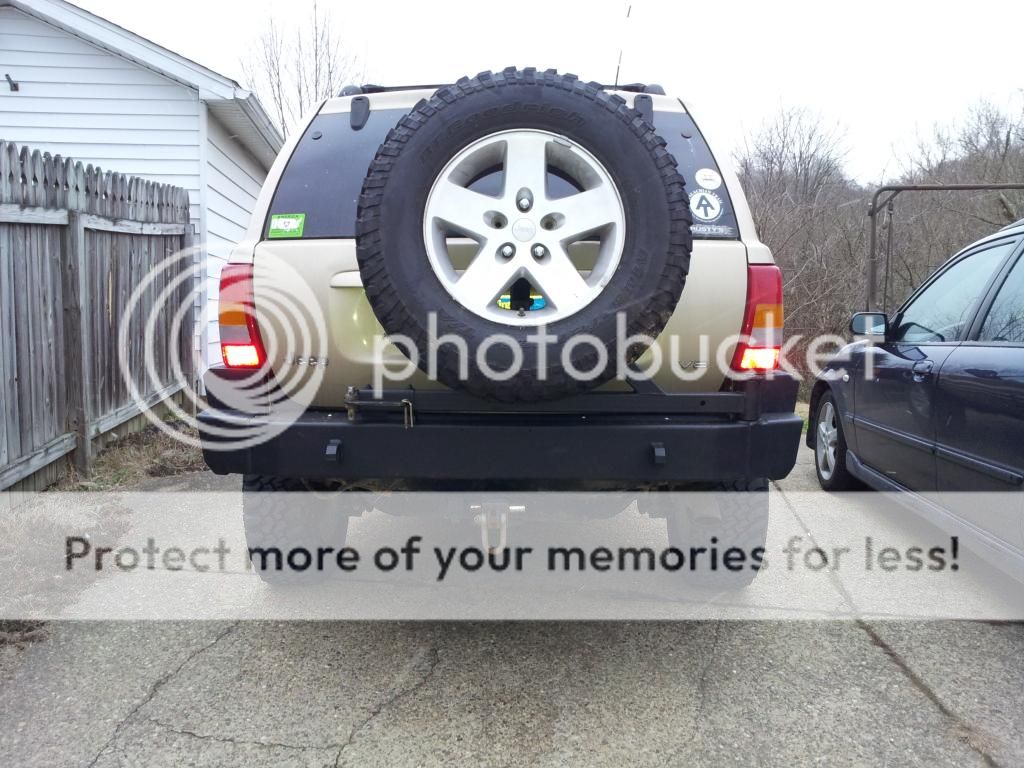

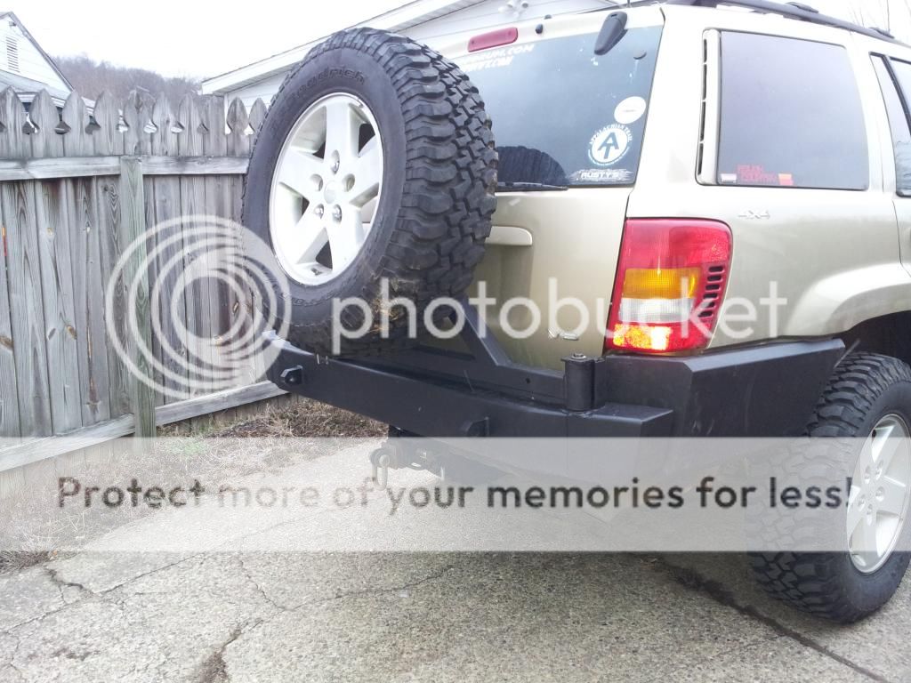

I still need to grab some bolts for the front of the large side pieces, so I can straighten those up. I'm also going to have to pick up longer bolts for the brackets before anyone tugs on it. We used the existing hitch bolts, which didn't engage enough threads into the frame-welded nuts for my liking.
I really like how the side pieces are separate from the bumper itself, that way if I land on one, the whole setup doesn't get damaged. :bigthumb:
Looks good!

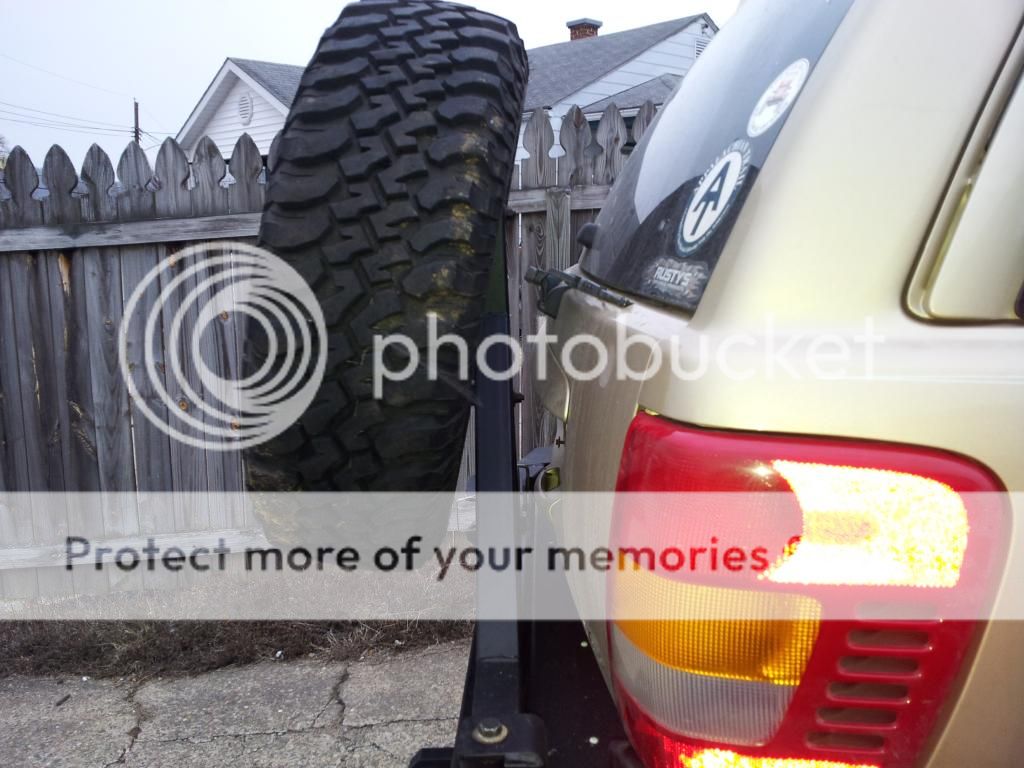

i have the same one too and its awesome but heavy
anyways, how'd you get the tire to tilt up? mine is just a vertical hookup to the swing arm.
and do you have any sag on that swing arm? my tends to sag when i open it up and i have to lift it up to look the swing arm.
Which causes the locking mechanism to get Really tough to close.
im wondering if mine was just F'd up by the PO lol

the tilt= the bottom part of the tire bracket is bent slightly, but that would make it tilt down. Maybe the original owner changed it. This weekend, I have to take it off and put different lug nuts on it (current ones don't fit in the factory wheel wrench). I'll snap a picture of it so you can see how it's made/angled.

also--no sag in the arm whatsoever. How tight is your bottom bolt? (the one that goes up through the inside of the bumper)
My lock is tough, but that only happened after I tightened it.
It's possible our locking mechanisms and swing arm-mounts are slightly different. (since the bumpers are made to order)

Ill get pics tomorrow of my setup,
My tire actually leans out instead of back like yours!
And I'm gonna try and tighten the crap out of the bottom one this weekend, although I do remember having it pretty tight already
Also is it just me or are your fenders really low and not tight to the body? Mine is pretty well aligned with the body lines

SKI_VT--if your tire leans out, either the arm is way off, or the upper part of the tire mount needs shortened/re-bent. I meant to get pictures of mine for you this weekend, but worked on the Tracker all day (60 degrees), and it snowed all day today (34 degrees). And, yes, my fenders are really low. I think my Jeep was rear-ended at some point in it's life. It was <40 degrees when we put it on (after the last meet n greet), so we didn't tweak at all. When it gets warmer, I'm going to pull them off, bedliner underneath them (on the gold), and realign them. I also need to wire up the licence plate light, but have been putting that off by not driving the Jeep at night.
