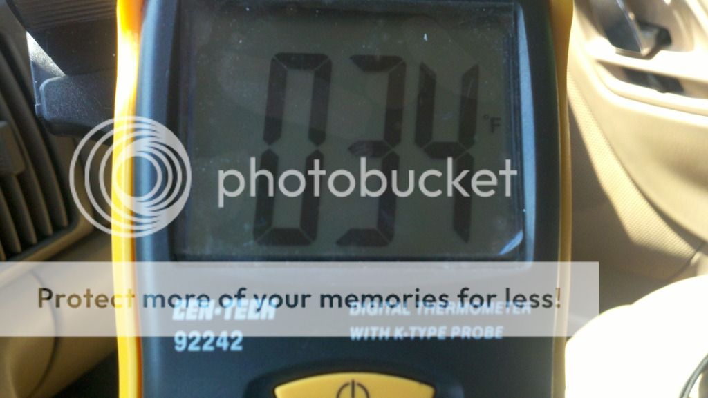

Originally Posted by narnwv
It took 95% of 24 ounces (2x12oz cans), so there couldn't be much propane in there...
I do plan to watch it closely.
Oh ok i interpreted it wrong then,i thought it was 2/3 134a to 1/3 propane.Your ratios are fine my man.
