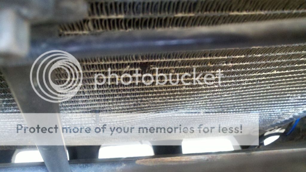

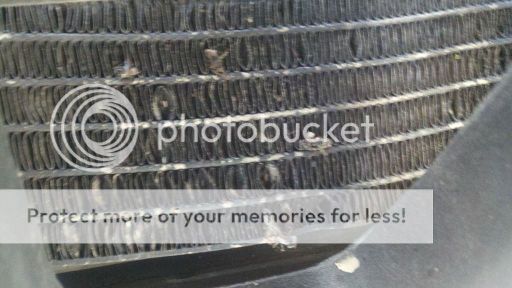

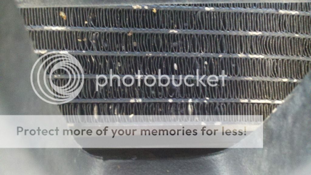

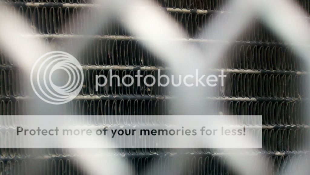

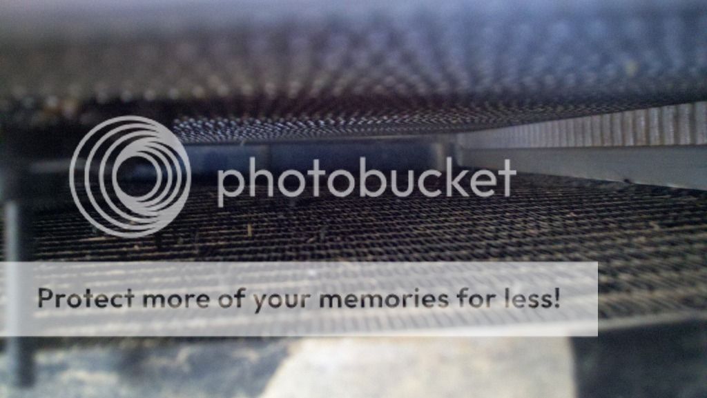

post #240 of 763 Old 06-20-2012, 09:26 PM Thread Starter
narnwv
Moderator
narnwv's Avatar
Location: Cross Lanes
Posts: 6,417
figured I'd throw up a few pictures of the condenser. Honestly, these pics don't do it justice. It looks beautiful compared to real life, not to mention that the pics don't show how wavy the whole thing is.
Straight down, driver's side
Straight down, passenger side
Through the gap where the hood latch is
Through the grill, no idea what the blue ball-like thing is
Other side, through the grill
Both of these are looking through the gaps at the bottom of the bumper
