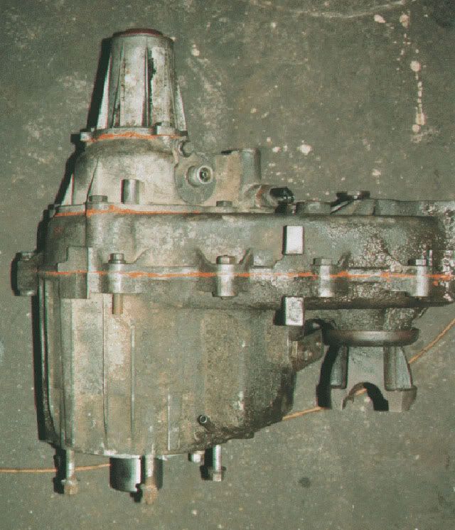

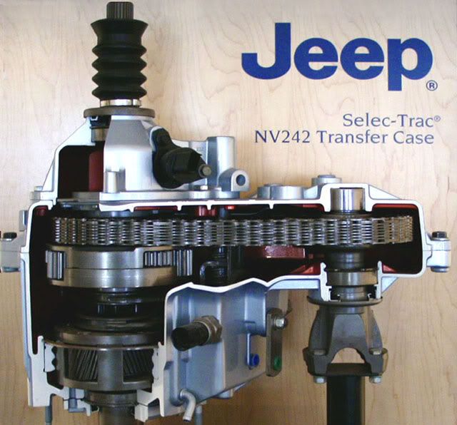

YOU need a 242 with an exposed input shaft of .84". Also you will need to get your DS shortened bu around 1" if the 242 has EXTERNAL slip yoke. If you find a 242 with INTERNAL slip yoke (same as your 249) then you dont need to change anything on your DS. Also you need the yolk that bolts to the front axle for the DS, and a ZJ front DS. XJ DS wont work, I tried. You can however get the yolk for the front axle from an XJ. Check my build thread, I swapped in a u-joint front shaft from a ZJ. Hope this helps

The input shaft will be sticking out .84". Your front DS length will be right, you wont have to change that. And if you get the internal slip case, you wont have to change your rear DS either. BUT if you get the EXTERNAL slip then you will need to get your current REAR DS shortened around 1" or get a SYE/HnT.
Internal Slip Yolk -
External Slip yolk -
