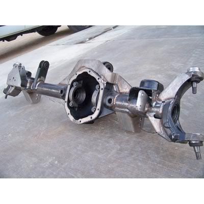

here's part of the front - notice where the iro full-truss is hacked off, but we kept the bump-stop hit point (so i could ditch the giant bump-stop extensions i had):
here is what it would look like if i had the IRO "Y" suspension and could use the whole truss (pic from IRO site):
i wanted a full truss and was one of the things i thought i was getting with IRO. i didn't realize they have you hack off the cast-iron upper control arm mount on the drivers side to use their own adjustable mount that is part of the truss. if we did that, then we'd have to come up with something on the passenger side too (IRO has no passenger side mount at all). i didn't like that whole idea (cutting off a prefectly good strong mount), so we couldn't use the whole truss thing. oh well, live and learn (to not oversimplify things in your head!)
I hear you, I opted to go with rockcrawlers truss for the long side and welded it to the pumpkin; but I am considering adding this "over the diff" one from polyperformance as well, which allows you to keep the driver's UCA mount and will connect both tubes. I really like the rear truss though, looks way beefier than Clayton's.
i saw that poly performance truss too, i still may get one of those later
