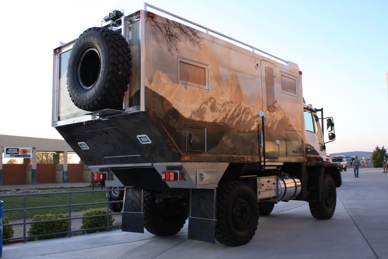

Originally Posted by frumpy View Post
Is that a winch on the roof for the spare tire? Guess you would need a hand getting it up that high.
yep. interior was fake marple countertops and real wood everywhere, glass door on the shower and everything else like a real RV, but major off-road capable.. wonder what MPG it gets, ha!
