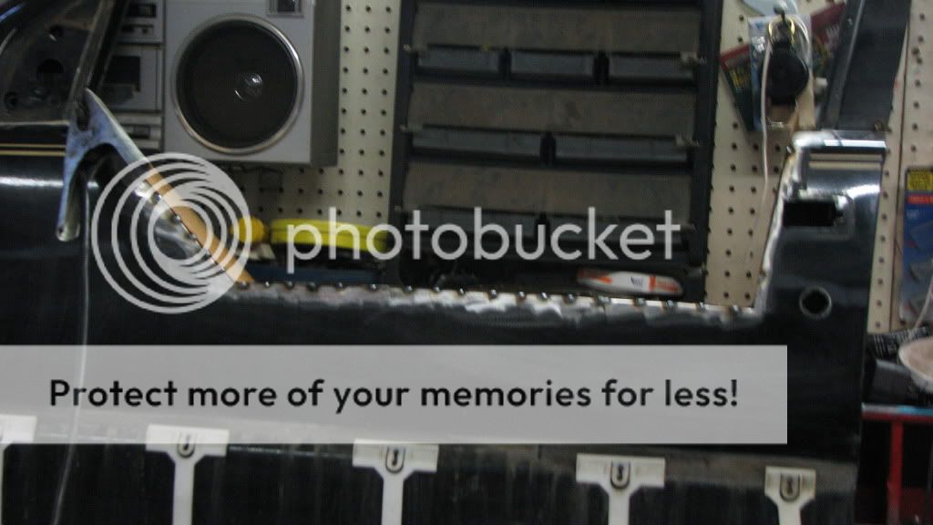

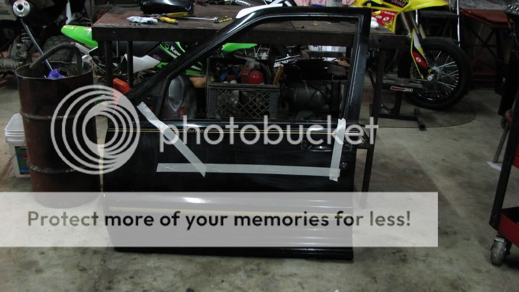

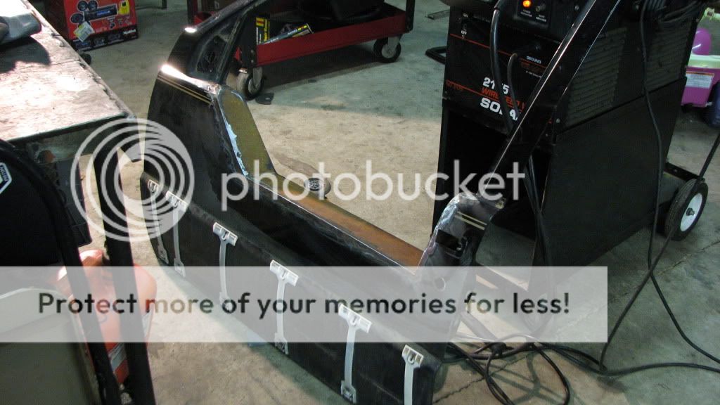

Worked on my roof rack this morning before work and didn’t get much done. I’m mounting my high lift and 2 more light tabs off the back corners.
I also got one of my half doors almost done a couple weekends ago all I need now is the gray cladding and to make the door panel and build my cup holders and cut, bend and weld the driver door. I did put it on and drive around for a couple day and I like it I was dumb and built the passenger door first but i guess its motivation to do the drivers door now.

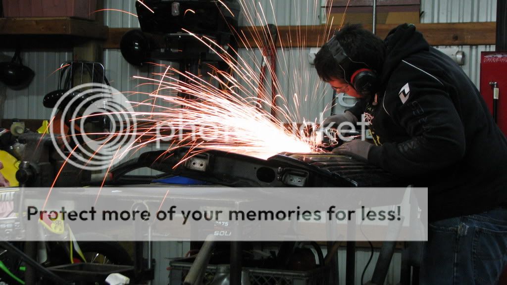

Well I haven’t posted in a while things have been going a little slow but I got to take the jeep out finally and it did pretty good. The doors work awesome I was in some tight wooded trails; its nice to be able to really lean out and see what your doing. My full doors went back on for my last outing since it rained off and on that week, so no wheeling pics with the half doors. I haven’t made the door panels yet either.
so heres some new pics
yea poser shots but I was out bye my self it was more a test run than anything
I was going start a thread for my half door build and the rest of the stuff I’m going to build. Like my bumpers and long arms and what ever else i decide to build but ill just keep it all in this thread.
so heres some door pics

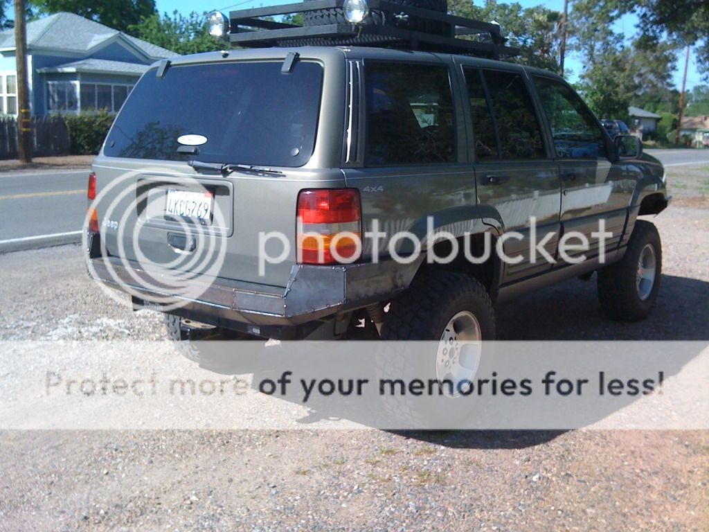

Its been a longtime since I’ve done an update and some new stuff has happened.
well onto some pics

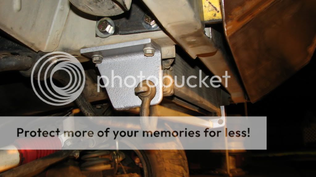

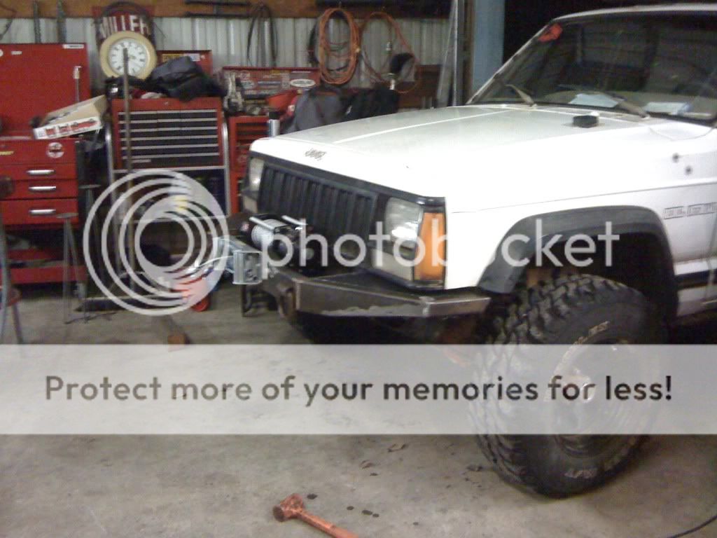

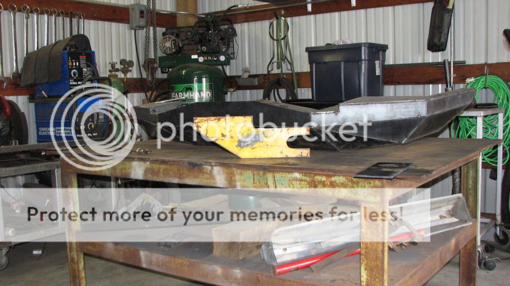

built a front bumper and rad support
Then I cut away what I felt wasn’t necessary of the front unibody.
in this pic you can better see my bumper mounts. Each side sandwiches the unibody and is secured with 9 bolts per side.
I am also building a rear bumper it will have a tire swing when its all done
