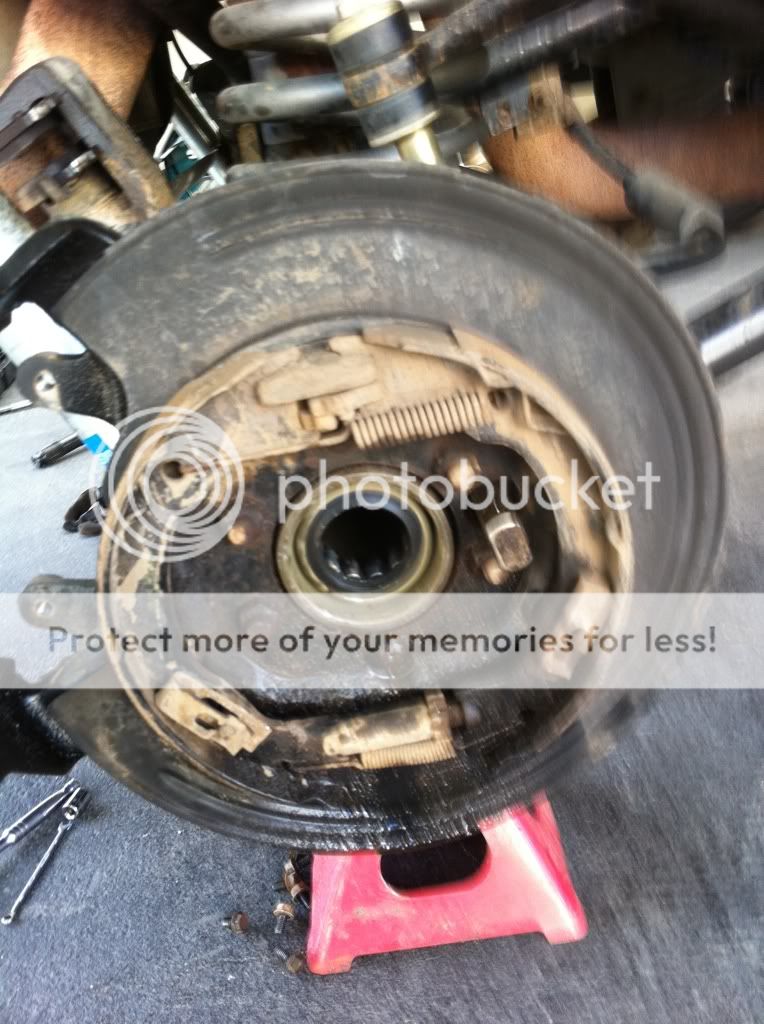

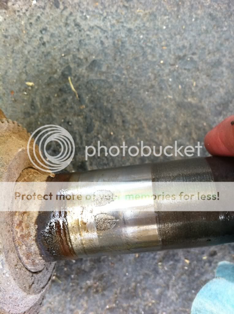

Well last few nights away from home, i am currently in seattle at a friends house,
I had noticed a little oil my right rear wheel, nothing excessive and i had a leaking trans cooler line that i never got around to fixing so i just figured the oil had blown back there since it doesn't take much of a leak to cover the whole underside.
anyways about 200 miles away from seattle my wheel and tire and brakes and everything were covered in gear oil, i didn't want to pay a mechanic to put new seals in, so i filled the diff again, it was a quart or so down. then dove to his place, bought a floor jack at costco, new seals, bearings, fluids and such.
the left side was okay, a little pitting on the bearing surface, but still okay. but the right side axel shaft is worn down pretty bad, maybe .75mm
tried to find some new shafts in seattle, but couldn't find anything, so i went ahead and put some new bearings and seals in and hoped for the best, so far no leaks and hopefully i can make it home 950miles on monday. they don't make any noise or anything, if the old seals still had some give, i probably wouldn't of noticed it for a while.

Hmmm new wheels and tires? And damn that must be a D44a thing cause when I almost sold my ZJ both V8 zjs I looked at had bad rear ends. One was a 98 5.2 and one was a niner.
Well just tires, i still have the factory niner wheels and tires, and i bought a set of general altimax arctic's that i'll run un-studded for the winter, on them. And i need to use spidertrax spacers because of my steering.
But i'll still run my nitto's for the rest of the year.
I still haven't found new shafts, i can get some for just under 1000, but i don't want to put that much into this axel, so i am still on the lookout for some used ones, but with new seals and bearings i don't have any leaks or noise, so i am good for now. i just hate that is sending metal shavings and **** into the gear oil, because its a brand new gear set and LSD.

Damn I would just buy a junkyard rear end and swap your diff over

I've only looked twice, but the wrecker only had 35's
i still haven't researched it, but i wonder if d35 shafts would work, cause they use the same wheel bearings, and i have a spare set sitting at my parents place. i doubt the lengths or the splines are the same, but just a thought.
this jeep only has 100k on it, my 5.2 with the d35 has 200k on it and I've never had any issues with the bearings or anything, every time i took it wheeling i expected to blow up the d35, but it was a champ, locked on 33's and my extremely heavy right foot with a modded 5.2.

Yeah idk d35 shafts are 27 spline and I can't remember what 44a shafts are
I have a set of used shafts Id sell ya

I'll have to keep that in mind, if it was for shipping, id take em for sure, i think i am going to seattle around christmas time, maybe i could get you to ship them there. Thanks for the offer
is there any chance i could get you to measure how long each one is; if you have a minute sometime?

Sure I could do that. The 35 shafts are not compatible in the 44 if thats what you want to know
