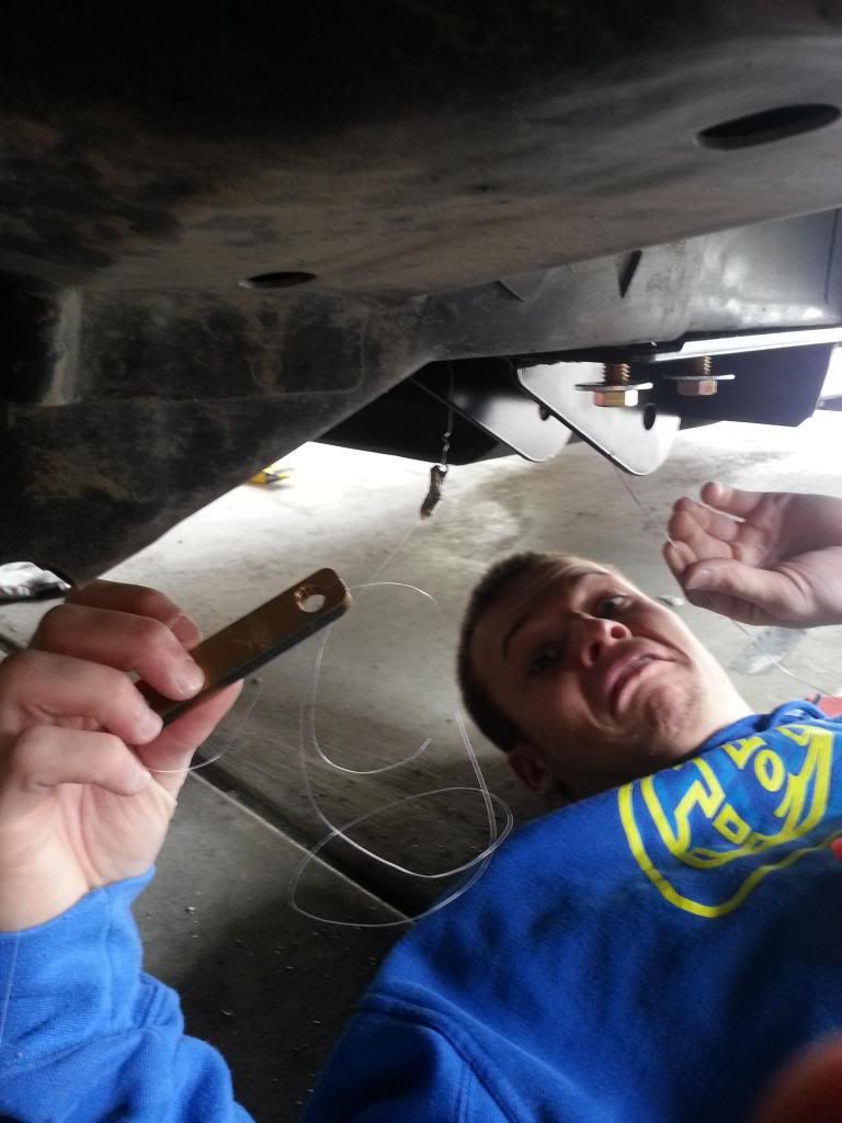

that would work, or fishing line
I get to do the same thing when I install my rear longs arms lol

Use fishing line...it make for a por mans lock nut

Tied through the hole you mean?
Yes.

Installed the LA brackets before work with ^^^ this guy ^^^ he's the one in the pics. Was really easy, took about an hour and a half. The fishing line method worked like magic
(Mylastresort)
Fed a wire through first then the plate with the line
The rest will get finished tomorrow!
