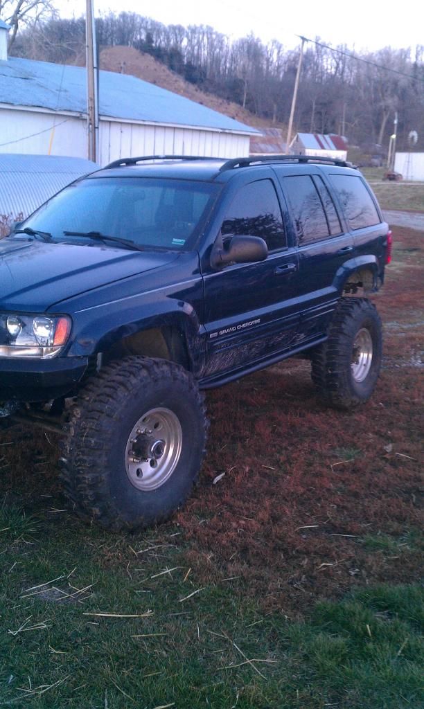

after lookin up some pictures, I think you guys talked me into cutting out my rockers and welding in some 2x6, with some tube. I actually hate how low the sliders hang, and the bars going to the frame would be a bad hang up point, and it makes it 2 inches lower, which sucks for clearance and just looks, well, shorter... or kinda like a body kit or something weird. Idk never likes the looks of them especially on WJ's they just sit so low, so this is the perfect option! besides the fact that i'm chicken to start cutting things I have a buddy who wants to go half n half on a HF 170 amp mig... so $100 for a welder, and we'll buy the lifetime warranty for $25 or whatever, plus their return policy is really good. figure we can't really go wrong for the price! that leaves me $100 for metal, better wire, and a grinder and some cut off wheels Maybe I can convince my buddy to do the same thing to his XJ instead of getting sliders like he planned. and if that doesn't work out I know some people who have welders, just would take some extra time to get them to do it.
Here's what I'm gonna base mine off of: (I also want to base mine off of tons and 38's )
