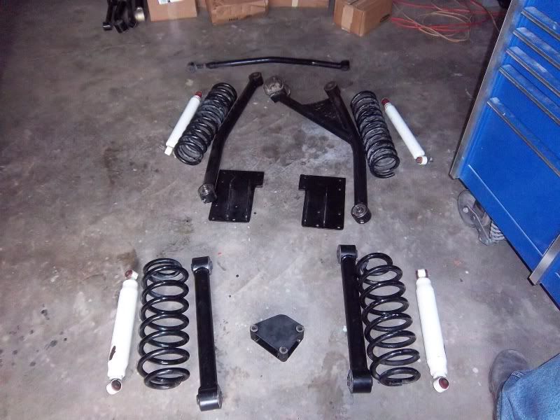

On another note, how do you like the IRO long arms? do you have them just up front or in the back too? I'm trying to figure out what my arm situation is going to be when i hit the ~5" mark.

The IRO long arms are a 3 link design so the drivers arm covers the upper and lower mounts and the passengers only covers the lower. Long arm kits will not require any upper arms as they are already incorporated.
I'm also running IRO font long arms and have been very happy with them so far. You can check them out sometime if you want.
I'm on fixed Rustys short arms in the back and have no complaints. I'm hearing a lot of good things about ironman.......I would definitely go that route if your looking into adjustables.

scar - alright, so if I get the IRO front Long arms I dont need upper control arms?

That is correct. Here is a picture of my lift before I put it on. You can see that the iron-Y arm incorporates both the upper and lower control arm mounts.
