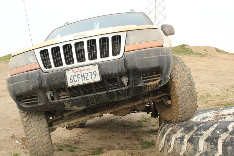

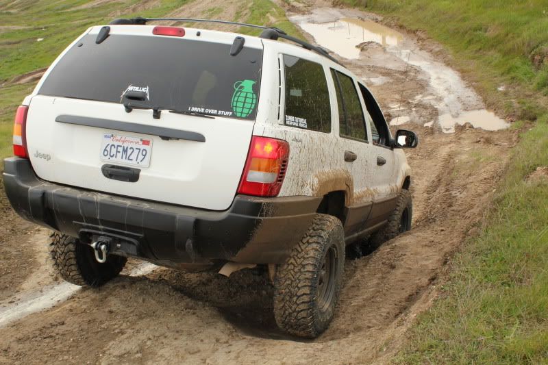

I got this jeep over the summer when my '94 4Runner decided to die on me. This is much better! I didn't document the build very well but plan on it with the rest of the project.

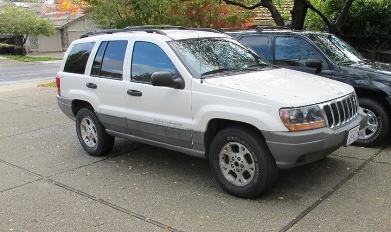

It started off like this:
And is currently like this:

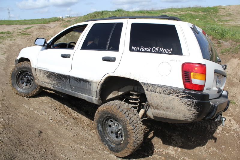

Completed Modifications:
IRO 3" Lift
15x7 Cragar Soft 8s
31x10.5 GoodYear Wrangler Authority's
Painted cladding
Added Factory Tow Hitch and Front Tow Hooks
Thrush Welded Muffler
Mesh Grille
Solid Front Diff Cover
KOR 3/4" Spacers
Carolina Driveline Front Driveshaft
JCR Stage 3 Sliders
IRO Bar Pin Eliminators
IRO A-arm spacer
K&N Intake tube with Amsoil Dry Dilter
ZJ washer bottle
Transmission Cooler
Cut Fenders
Things Still Left To Do
Tank Tuck
mtnmarc's axles
Stereo/speakers replacement
4.5" Coils
Long arms
35s
