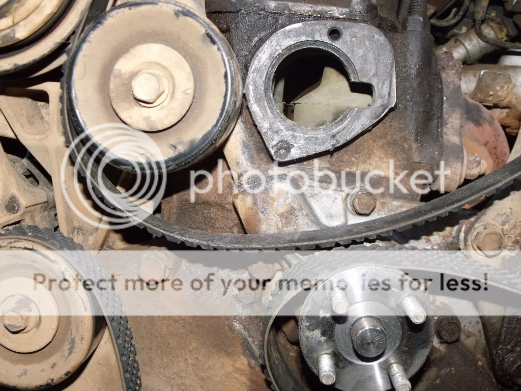

It was stuck open, decided, hey I'll replace it, cheap, easy, what could go wrong.
Second day into my thermostat project here is my progress:
here is my next step:
Time for the drill, lets hope I don't break the bit/extractor and have to pull my head off and get it machined out.
Unfortunately it bottomed out (wrong bolt apparently) only it bottomed out at 90 psi using the air tools. But It didn't break through the back so I'm still hoping it can be removed without drilling all the way through. I'm not confident I'll be able to tap the hole straight if that's the case.
Luckily it's only 97 out today =p
Edit - oh that notch you see is the failed attempt at removing it with a screw driver, it just breaks the bolt more. Didn't think going further into the housing was a good idea.
Edit - 2 - Broke extractor off... awesome. any ideas? bought the best bit I could find to attempt drilling into it, but it's not working, even at full speed on my 1/2" drill it just annihilates the bit after a while. I was honestly surprised the bit didn't snap.

Get another drill bit thats made for drilling metal, go slowly maybe medium speed, keep the bit straight, and use lots of lube on the bit to keep it cool. I usually use some pb blaster but any kind of spray lube should work. And you may end up having to drill over size and heli coil it if the metal is thick enough. Good lesson on using air tools on things that dont need the torque.

ouch! your going to have to at least grind the bolt flat again to get the drill bit to go in straight. I wouldnt worry to much about the hole he drilled, it may actually help relieve some tension. Once you get the bolt out you can use some jb weld to fill the hole your dad put in it and then sand it flush. At least thats what I have done in the past when buying a new head wasnt an option.

Jb weld isn't good with the kind of heat gas engines make. Especially in a head. Makes good block repairs on diesels though.
Can you weld?
They do make special bits for removing broken pieces of tool steel(which that easy out is made of), but they're expensive.
Unfortunately that relief hole your dad ended up drilling is going to make removal even harder. As if a nice hardened steel insert isn't bad enough.
All signs are pointing to machine shop or salvage head now.
