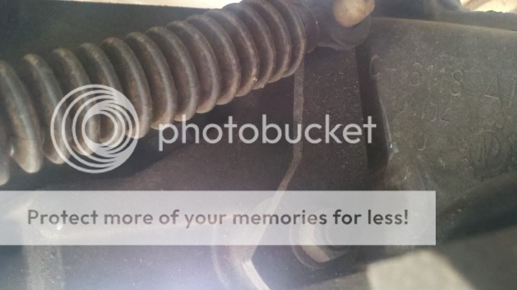

Originally Posted by mtnmarc View Post
Psh! I've been thinking about it for 6 months, then finally found a good price on one with low miles.
It's still going to be a few months before I put it in. I'm still curious on the shift cable.
When you put yours in, can you take a picture so I can get an idea on what to do.
I can get you some pics of mine ic it will help you.
WJ build thread.
Ya, that would help a lot. I'm thinking about buying the sye soon and just putting the 231 in there.
My build slowed down a big so it would be nice to have 2wd for the summer.

Cut it in half with die grinder. Flip the bottom piece cut the top piece diagonal bevel both pieces. Measurement should be 2.90" to 3.00" center of the pin to the center of the hole. Test fit it to male sure that it clears everything and weld it up all the way when you get it tweaked just right.
You will also have to move your cable to the bottom hole.
