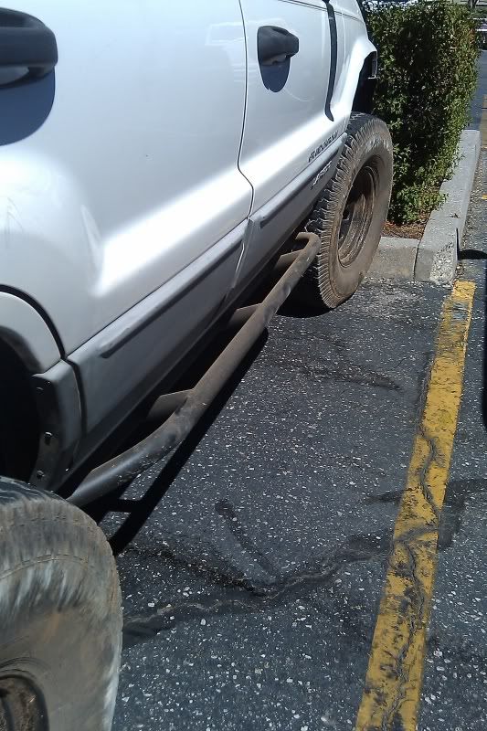

More of the sliders
Can you send post some more pictures of those sliders and how you mounted them up? Those are dirt cheap and its nice to have local dealers!
I got the angled brackets off the trail gear site. Welded them in. I'll take some pictures tomorrow if the weather isn't bad.
