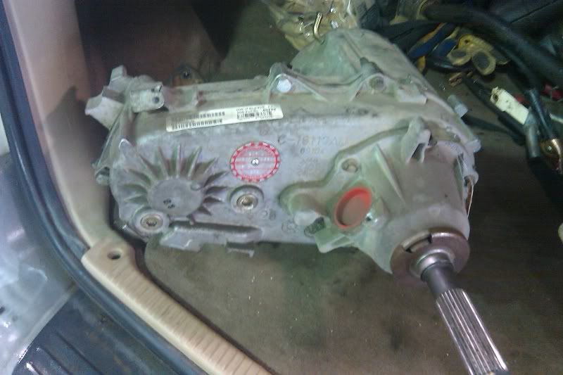

Np231 out of an 03 tj with 60k miles. One thing I noticed was weird, the shifter cable is pointed downwards? Compared to my np247 which is pointing up.

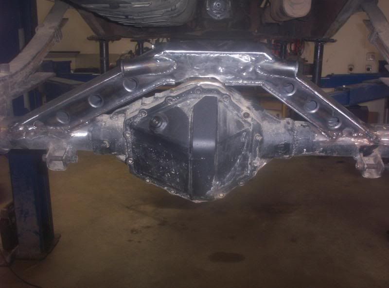

And my shaffers offroad truss finally came. This isn't mine, but its what it looks like.

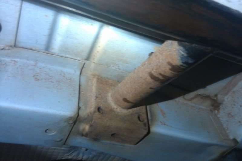

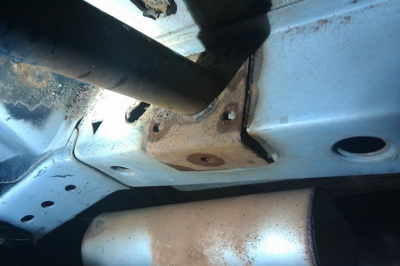

Thanks for the pictures man. Did you have to shorten the tube going down to the unibody at all or just weld the frame bracket to the end of the tube as is? And lastly do they protect as well as others? Looks like I might be pulling the trigger on a set.
Ya, you have to cut the tube at an angle since the unibody is higher than the pinch seam. Also the l bracket needs to be shortened a bit.
The coverage is good. Idk personally how they compare to others, but they have saved my doors a couple times. Mostly at king of the hammers. I should have taken some pictures, I was Hung up bad. Ha.
idea thief.......how did you know I'm getting a 231 on Friday, and beat me to it??
Psh! I've been thinking about it for 6 months, then finally found a good price on one with low miles.
It's still going to be a few months before I put it in. I'm still curious on the shift cable.
When you put yours in, can you take a picture so I can get an idea on what to do.
sure. some guy on mallcrawlin figured out how to do it with almost no modification, otherwise, some other guy pretty much machined himself a whole new shifter with a dremel tool. I think I'd like to go the first route....lol
GraKee on here just did a write up on how he did his. Looks simple enough to give it a shot.
